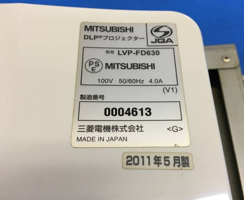

anybody know a replacement projector for the Mach Storm pod ? as the LVP-FD630 seems to be hard to find . and mine doesnt work , just blinks red / amber :cursing:

The number of led blink can tell you what's the problem.
You can use a NP-PE401H, it works fine and was used in these cabs.
