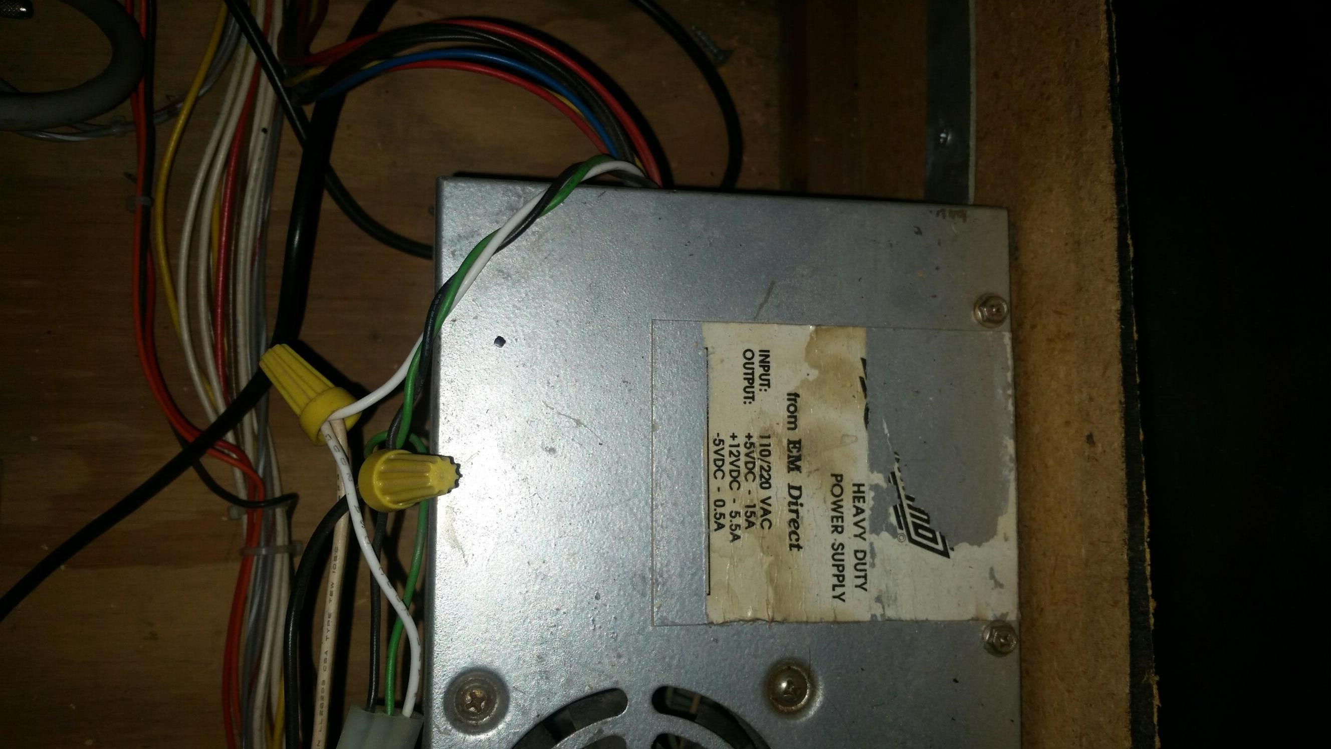

Thanks, @lukemorse1. I think my monitor might do 31k but I'd have to check again. I think my biggest concern was the power needs for any PCB I tried to swap in. The article I referenced in my first post seems to say that a PC power supply is necessary. I wonder if the native Naomi power supply work on these multi-game PCBs as well?

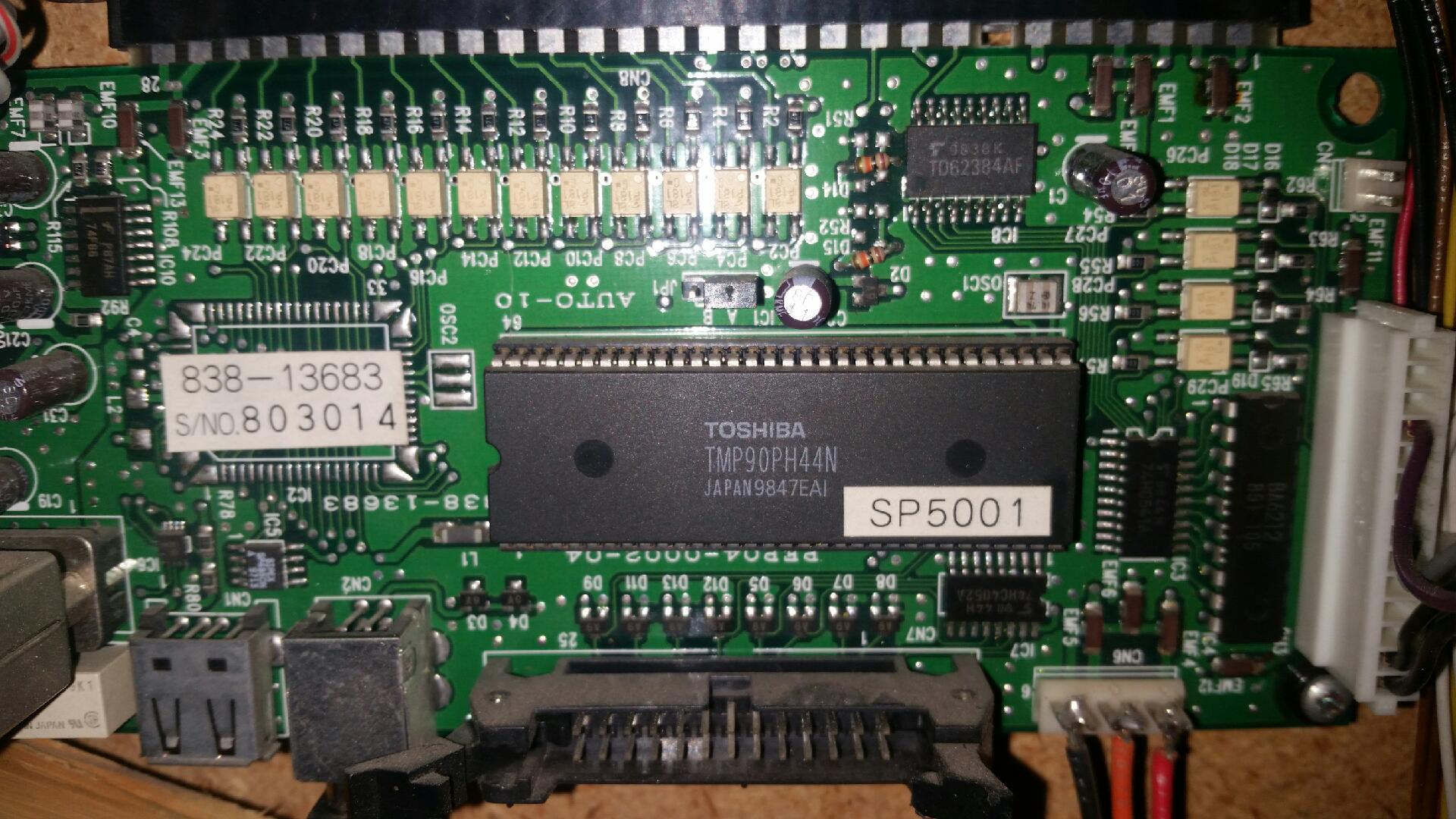

What type of cab is it? If it's JVS, then the advice that can be provided will be different than if it's a standard JAMMA cab.

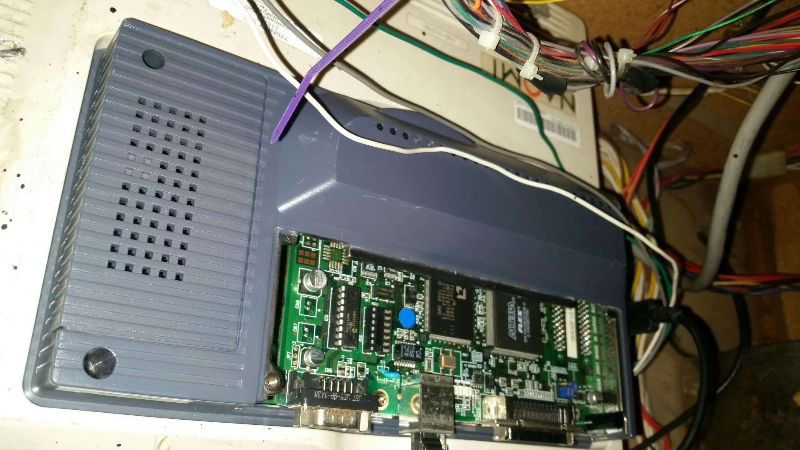

Some pics of how your NAOMI is connected would be helpful.
Here's what I have in my MvsC2 box. I replaced the wires with a standard JAMMA wire harness. I know that the kick harness wouldn't work with a multi PCB but it seems like, otherwise, there shouldn't be a problem since I am really just unplugging the wire harness from the I/O board and plugging it into a PCB. There's also a 2nd PS for the sound amp.

If it's JAMMA, then you won't need the additional psu or an atx, with a 60-in-1. Just connect the 60-in-1 to the jamma connector and you're done.

It's a JVS machine. It looks like I need a JVS to JAMMA converter board. It would probably be cheaper/easier to get an old vertical JAMMA cab. Here's a video about this very subject:
