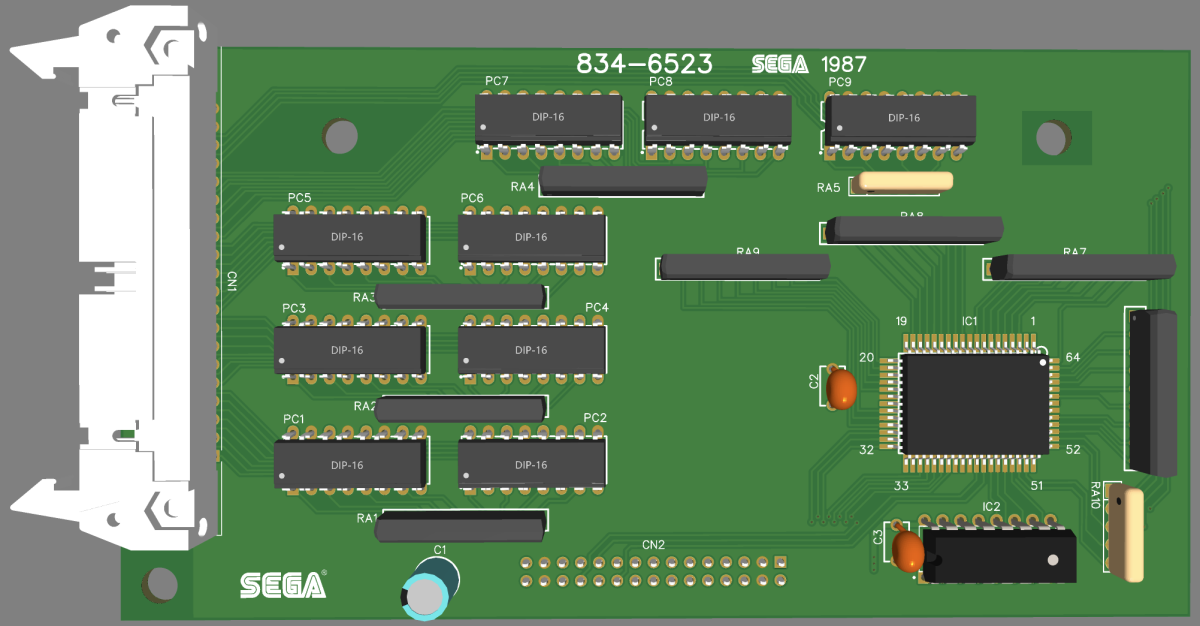

Repro Sega 834-6523 4P pcb

Did a repro of the Sega 834-6523, 4P addon board for Sega Sys 16 pcbs?! Not sure if it works with any other boards.
Its close enough. I will order 5 of these to test out. Thanks go out to @glstar for loaning his board out.
Just wondering if the 40pin connector should be replaced with a simpler more readily available connector(s).
I probably can if you can get me a board.
That could be arranged. I have already depopulated and scanned a board and am (slowly) documenting every component on it. I also have another board that hasn't been touched that I use as a base reference. I have 3 total: Depopulated, refurbished, and untouched.
This is for Passing Shot only.
Don't think Sega use this in other games
