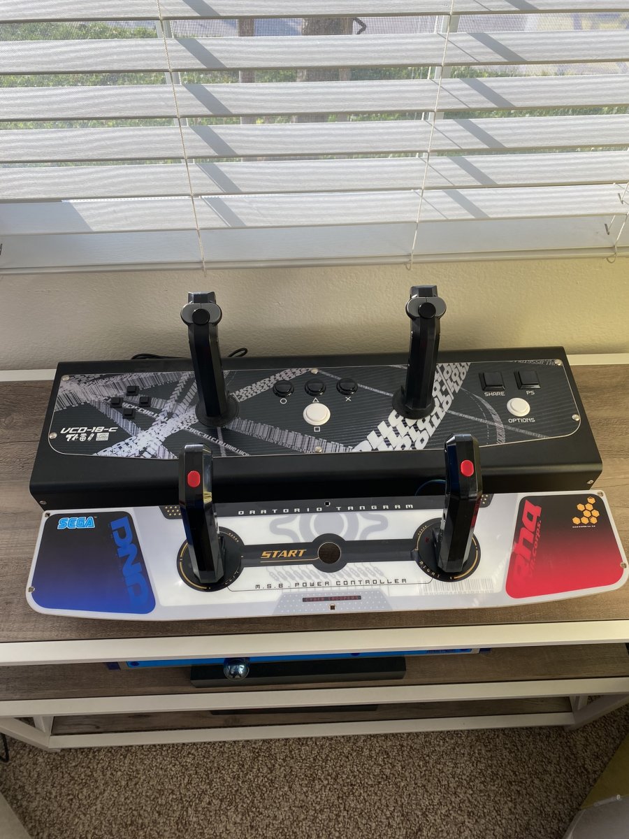

Panel mount I can make for these twin sticks
  • Sanwa twin stick (same or better quality than arcade twin sticks)
http://www.sanwa-d.shop/shopdetail/000000000066/all_items/page1/order/
  • Arcade twin stick# JLV2-G2-FO
  • Tanita twin stick # JLV-T2B
http://www.sanwa-d.shop/shopdetail/000000000029/ct24/page1/order/
  • Xbox 360: Hori Twin stick EX force version
  • Sega Saturn / Dreamcast twin stick

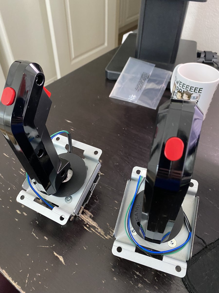

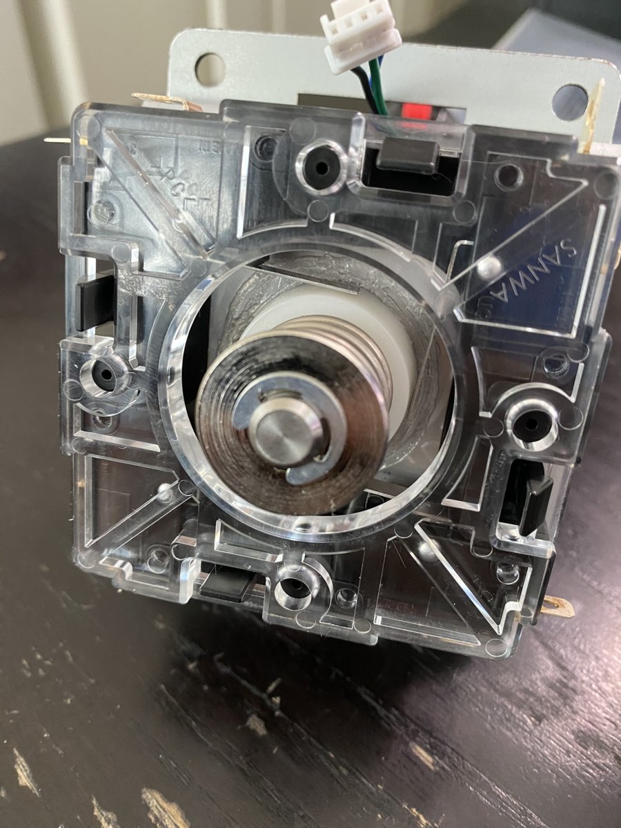

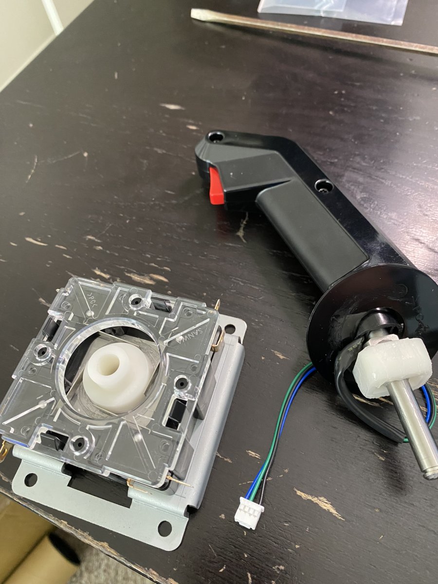

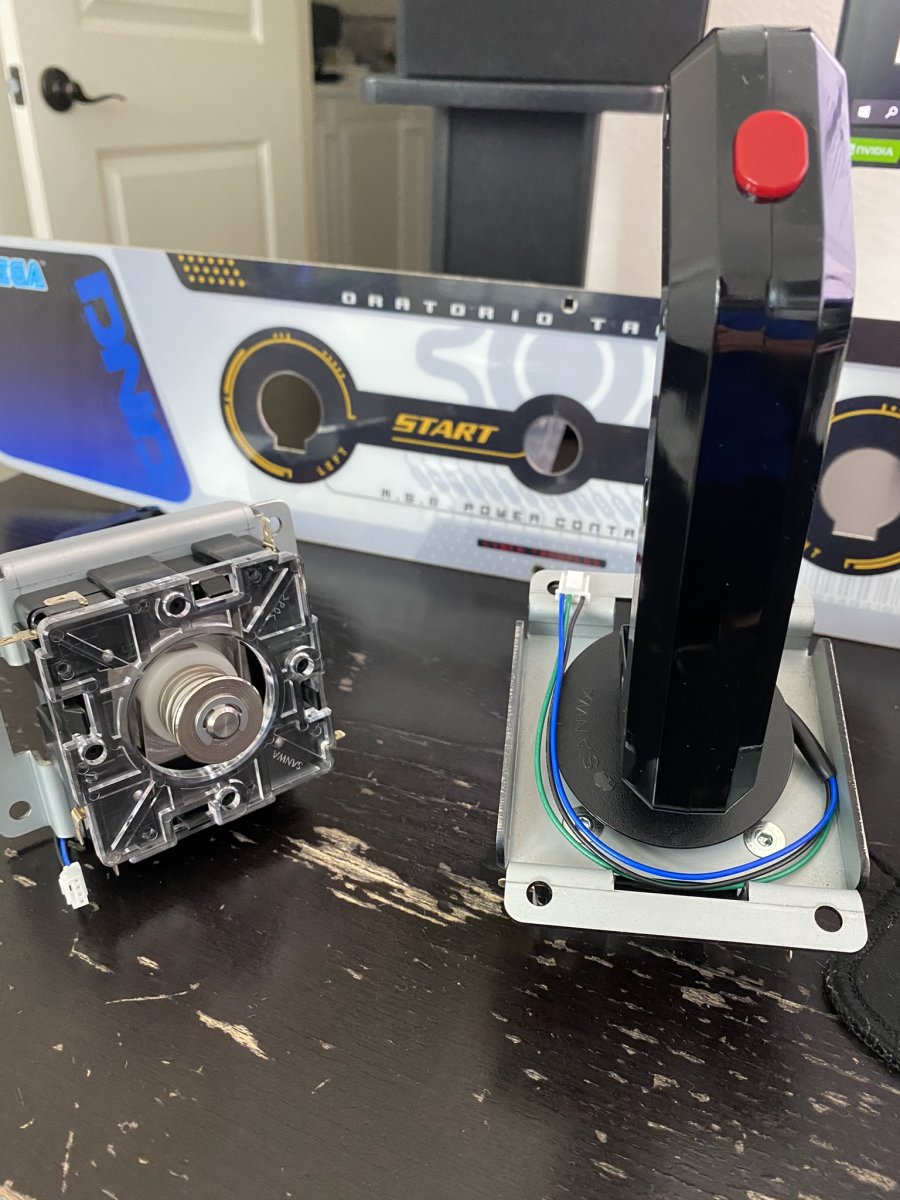

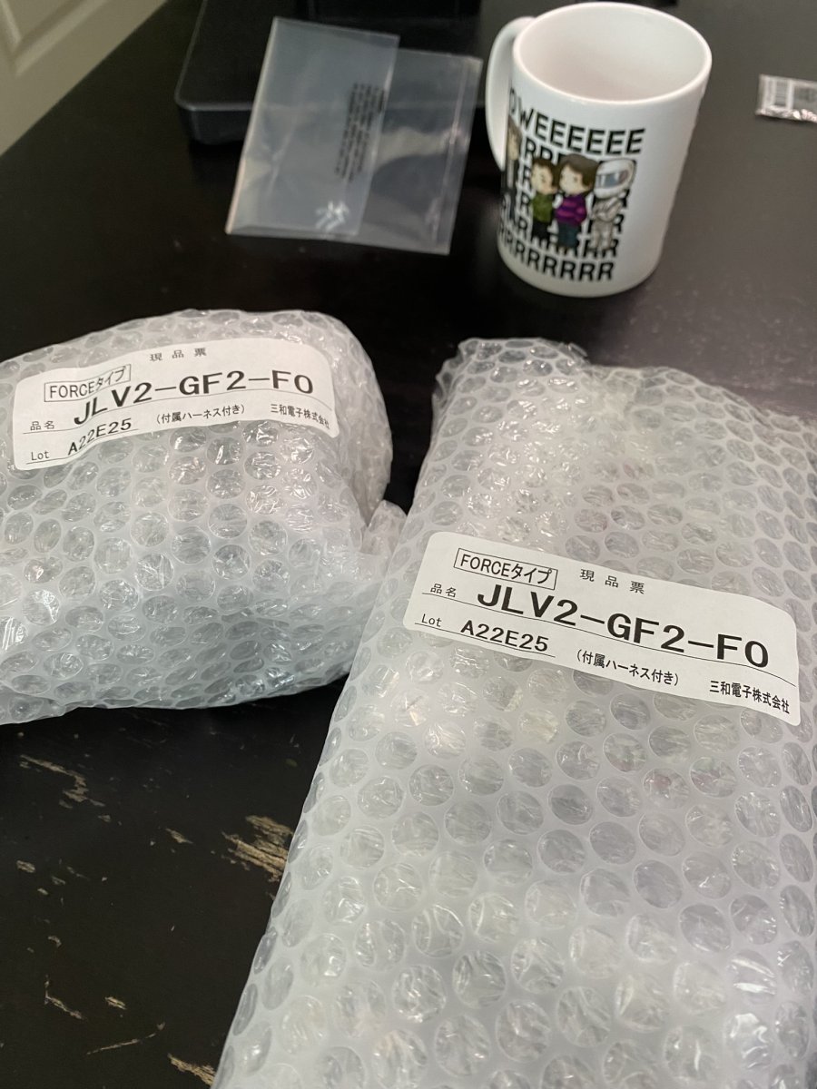

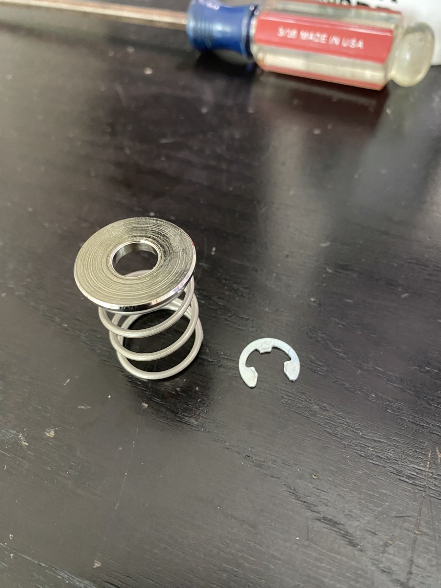

Installing a pair of SANWA JLV2-GF2-F0
Simple to install, remove lock washer and pull out spring. Just be careful when removing the Stick as it's greased up with a small ping to secure it.
