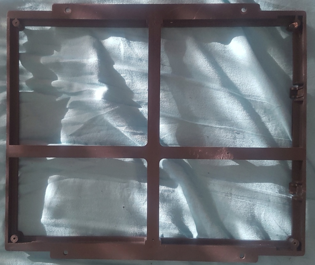

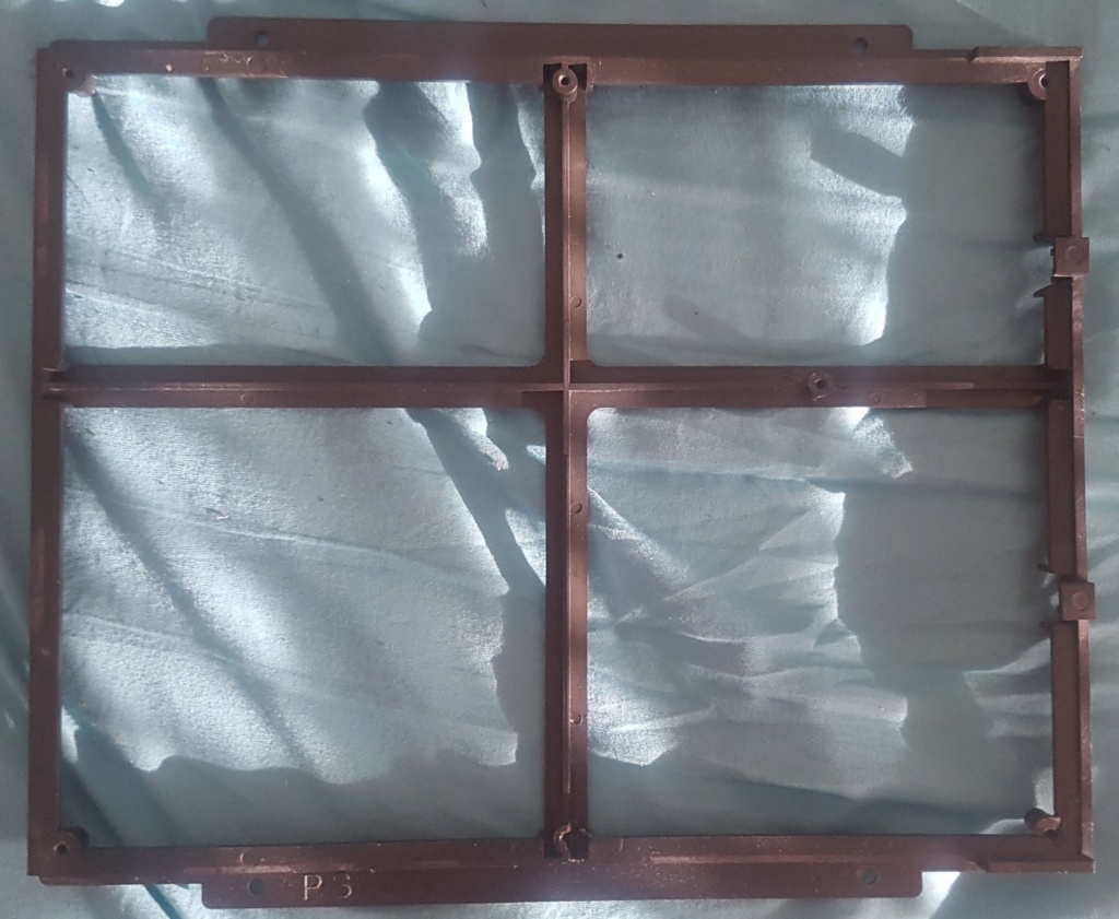

Hello
I have this plastic support from a New net city chassi with screw hole died, someone can make 3d print please? I can ship this part shipping fee paid myself.
THX
I need a few of these myself. I can ship one out from California if there are any US folks who want to take up the task and open source the files when finished.
What are the dimensions? I'll have to measure one, but I feel like they're probably too big to fit on the bed of most 3D printers.
Honestly the easiest way to fix your broken one would be to just get a heat set threaded insert and melt into the broken hole. That's how you'd want to add screw threads to a 3D printed one anyway.
