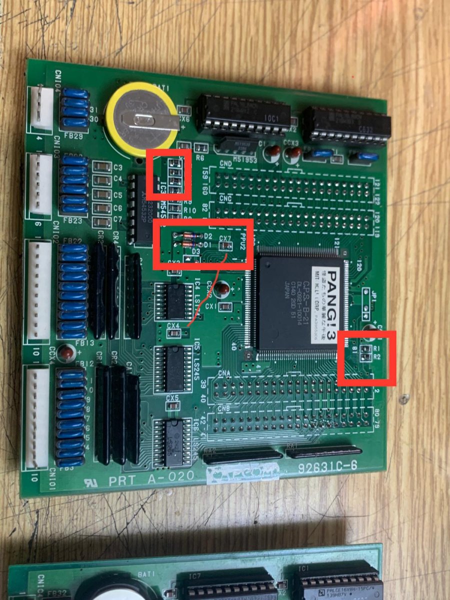

I'm trying to describe a C-Board differently. Is that possible?
I'm trying to write the King of Dragons data to a Pang3 C-board
write says done not working
I also marked the missing component in red, no success

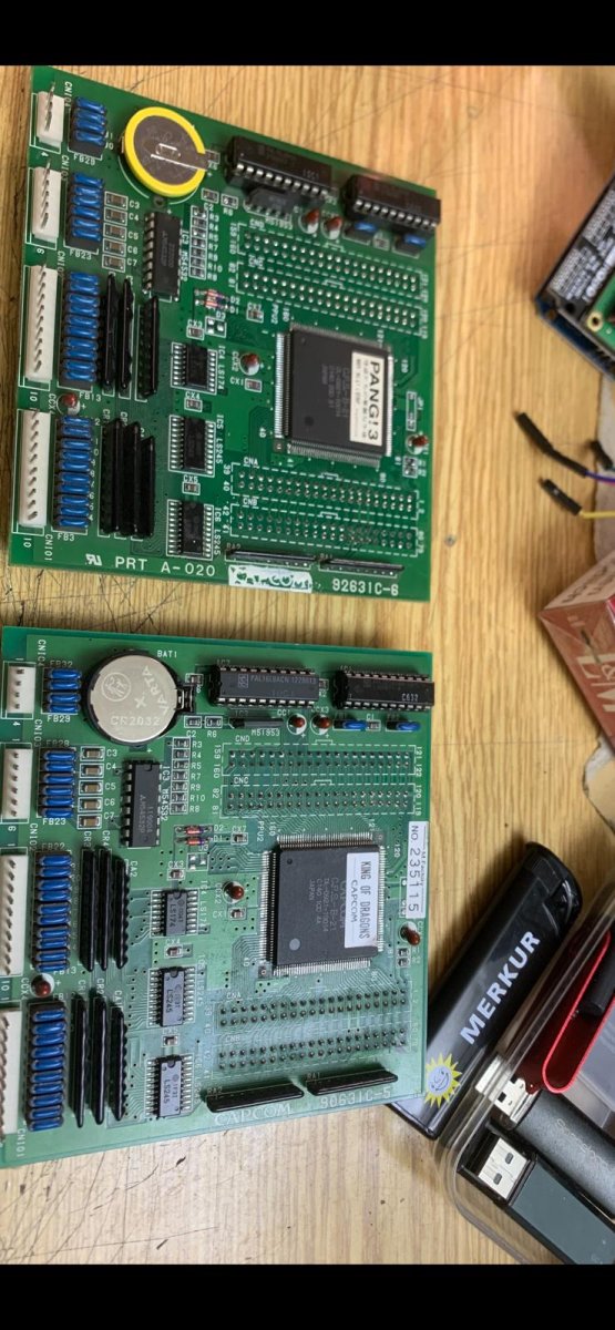

Is it even possible to take another one?
Hi
It will not be possible with that Pang C Board.
If you notice the model number of the 2 boards are different. Pang is 92631C-6 and King of Dragons is 92631C-5. The B-21 chip on 92631C-6 is wired in such a way that it forces the chip to use its default configuration and not be programmable. The 92631C-5 does not have this limitation.
