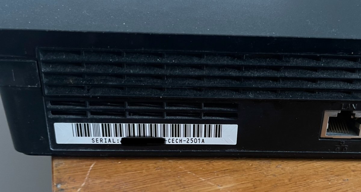

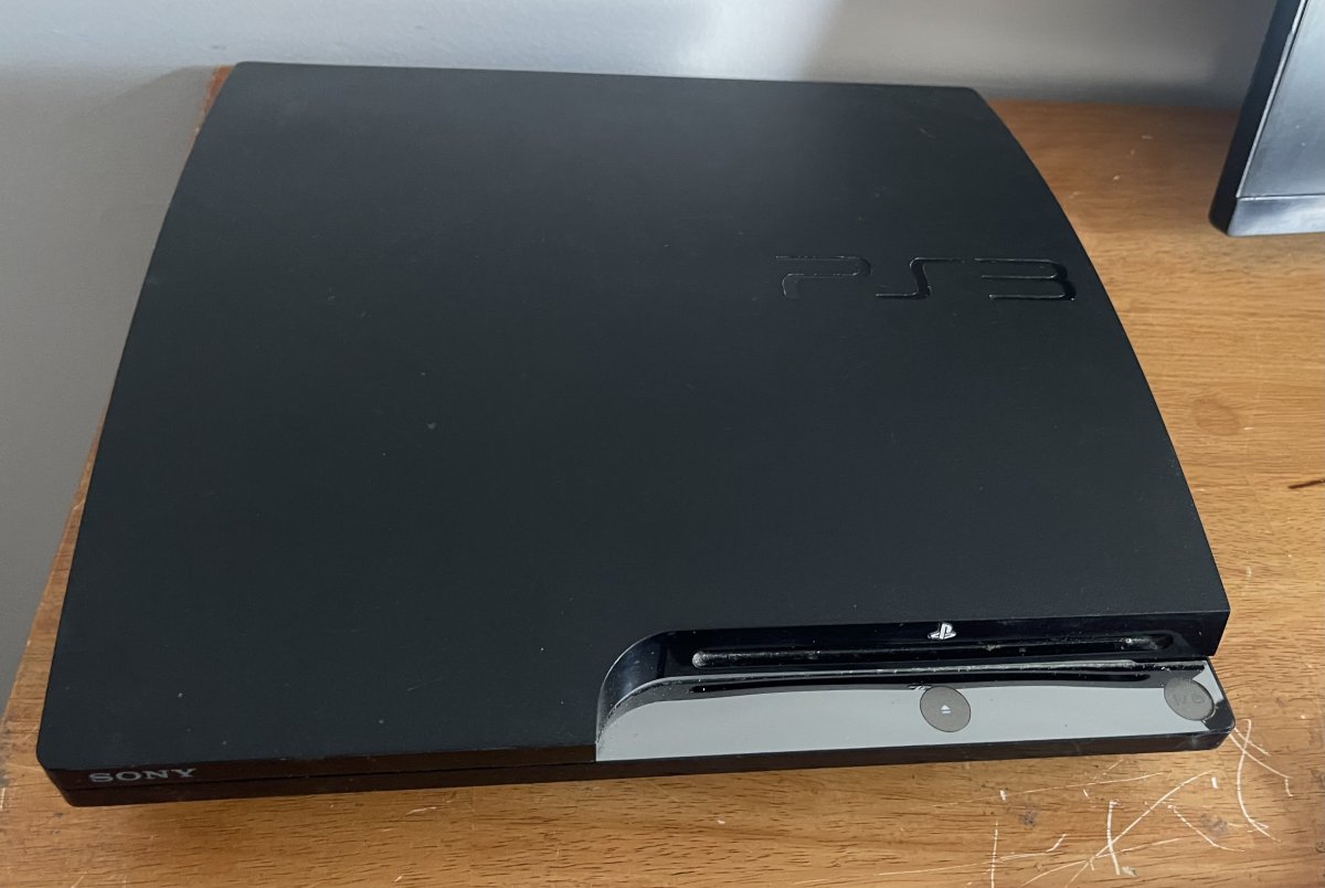

These motherboards also have retail and debugging versions available as well. For my tests, I’ll be using a CECH-2501A PS3 slim console that coincidentally uses a JTP-001 motherboard, the same motherboard found in the 357C/369 models of the arcade systems.

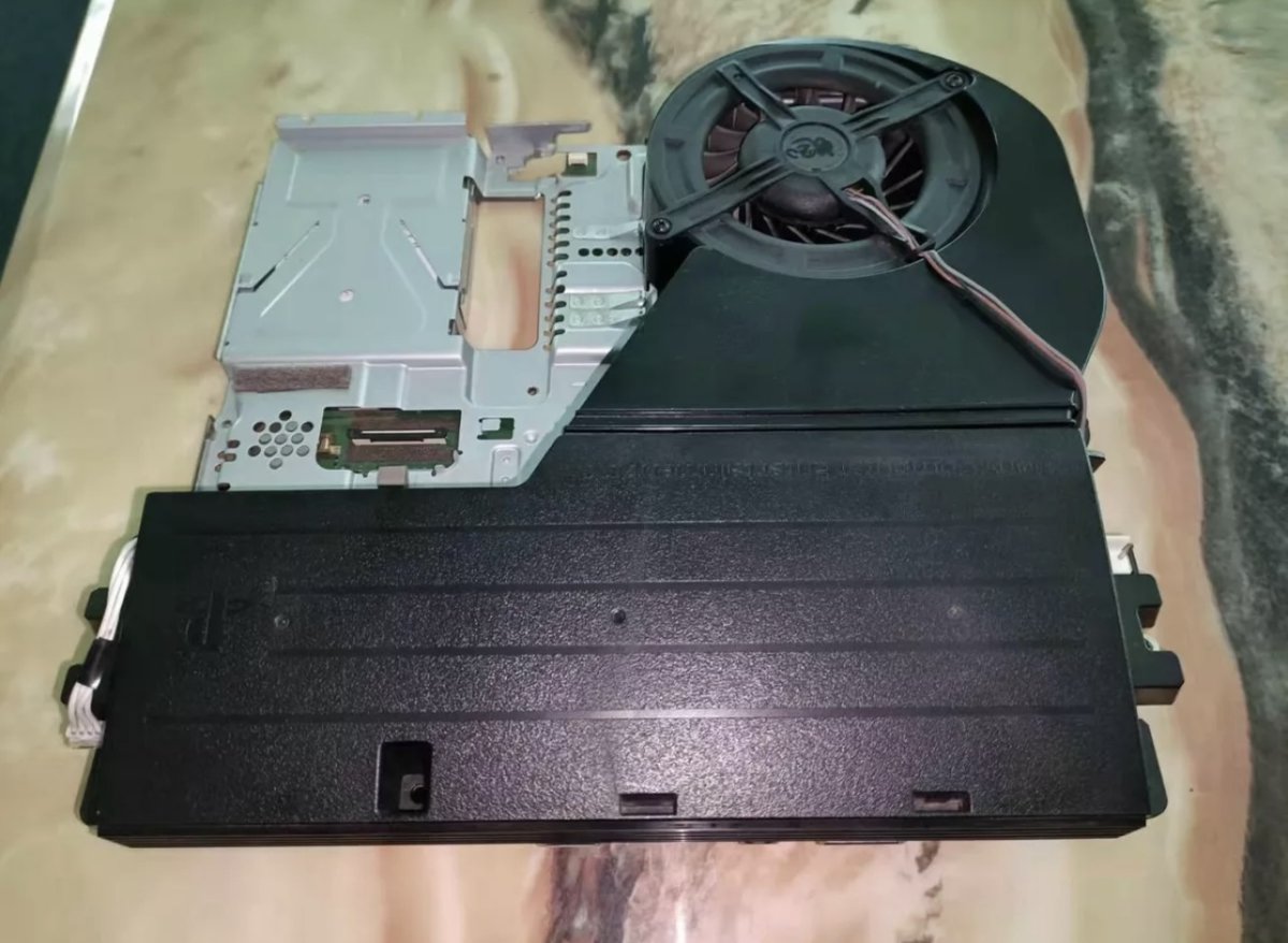

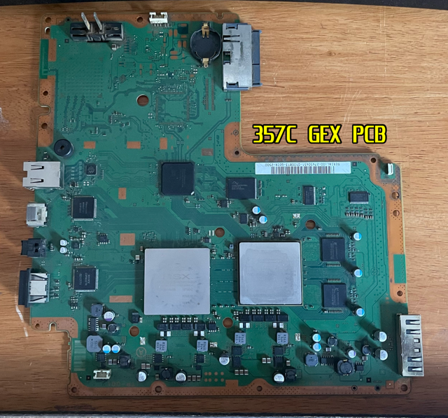

The motherboards the arcade systems used also have some differences from their retail/debug counterparts, for example, some components on the arcade versions aren’t soldered onto the boards like the WiFi/Bluetooth modules or the chips and clips that would normally be present when the system uses the Blu-ray drive. I’ll have a picture of a JTP-001 retail board and arcade board below for comparison. (On retail board, I did use the AV port to repair a broken 369).

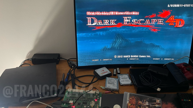

Now, I won’t go into specifics on how to do the conversion but you will need a few things. You’ll need to use a PS3 system that is CFW compatible, so all PS3 fat systems are compatible but only certain slim models. Mine was CFW compatible but results will vary. HEN compatible slims and super slims WILL NOT work or at least, they haven’t been tested further by me or my friends. And the last thing you’ll need is 4.70 GEX CFW or use 3.60-3.70 GEX OFW. Most games use these firmwares either way.

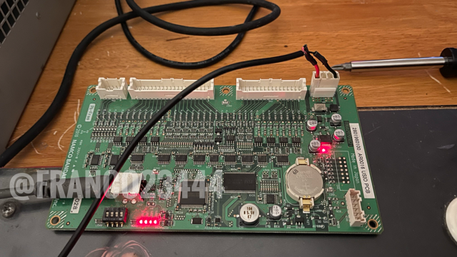

After you have gone through the process of converting a retail system to an arcade system, you will still need the USIO or H0XX USJ and JVS I/O boards, or else your games won’t boot. You’ll also need your dongle and arcade game HDD. Your converted console will also not play any normal PS3 games or disc games as the firmware has Blu-ray and WiFi disabled. Arcade games will work just fine but with some major issues I will try to explain.

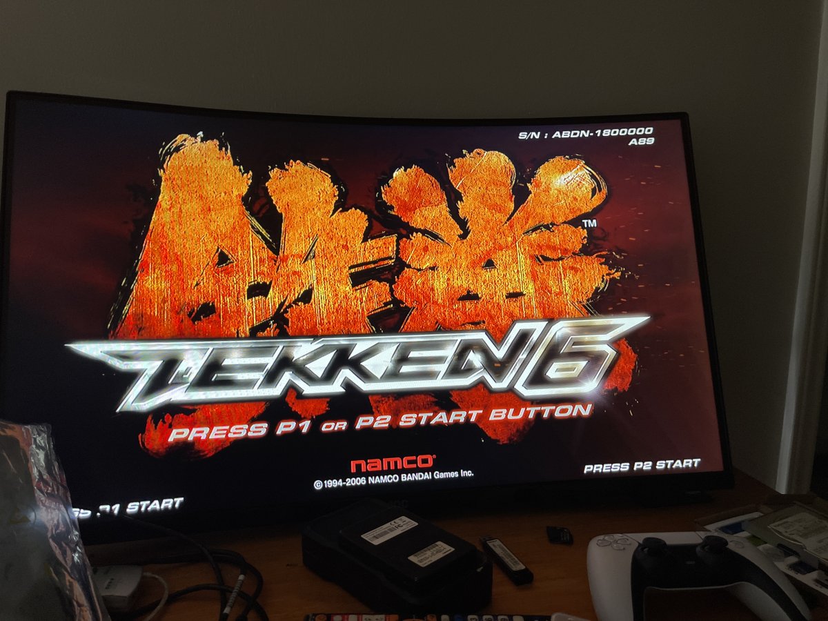

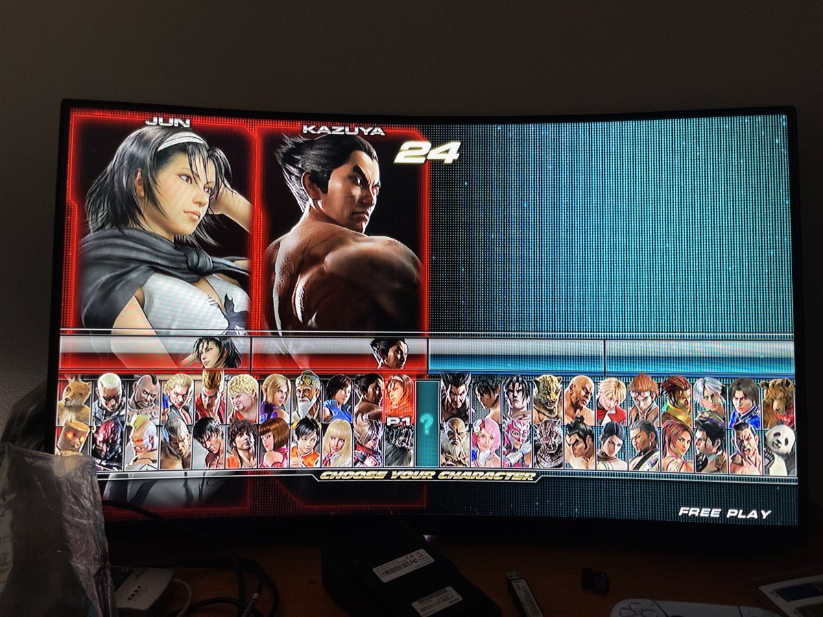

video:
Playing Tekken 6 vanilla on a retail to arcade converted PS3
View: https://youtu.be/WBfotarM5xI

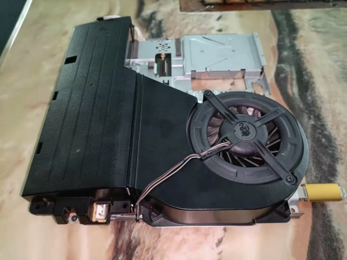

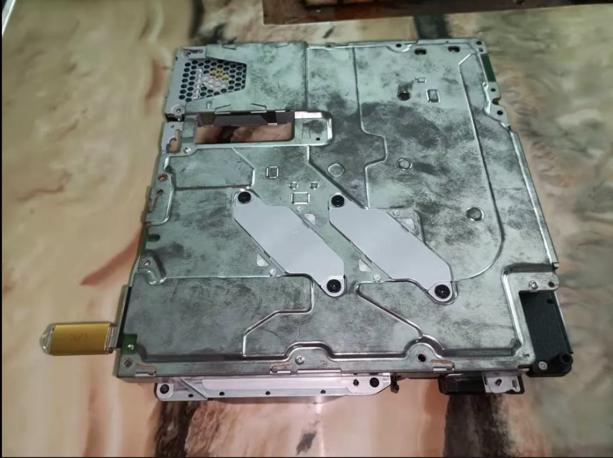

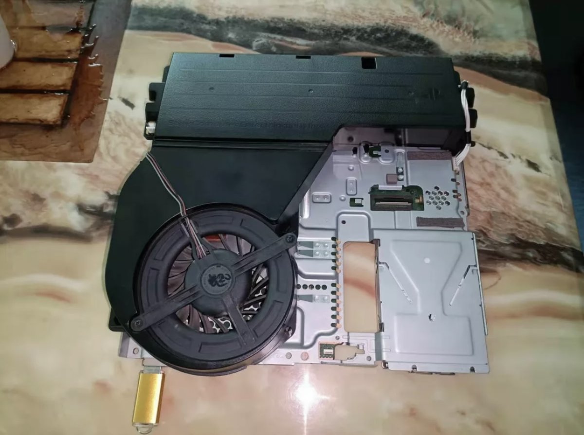

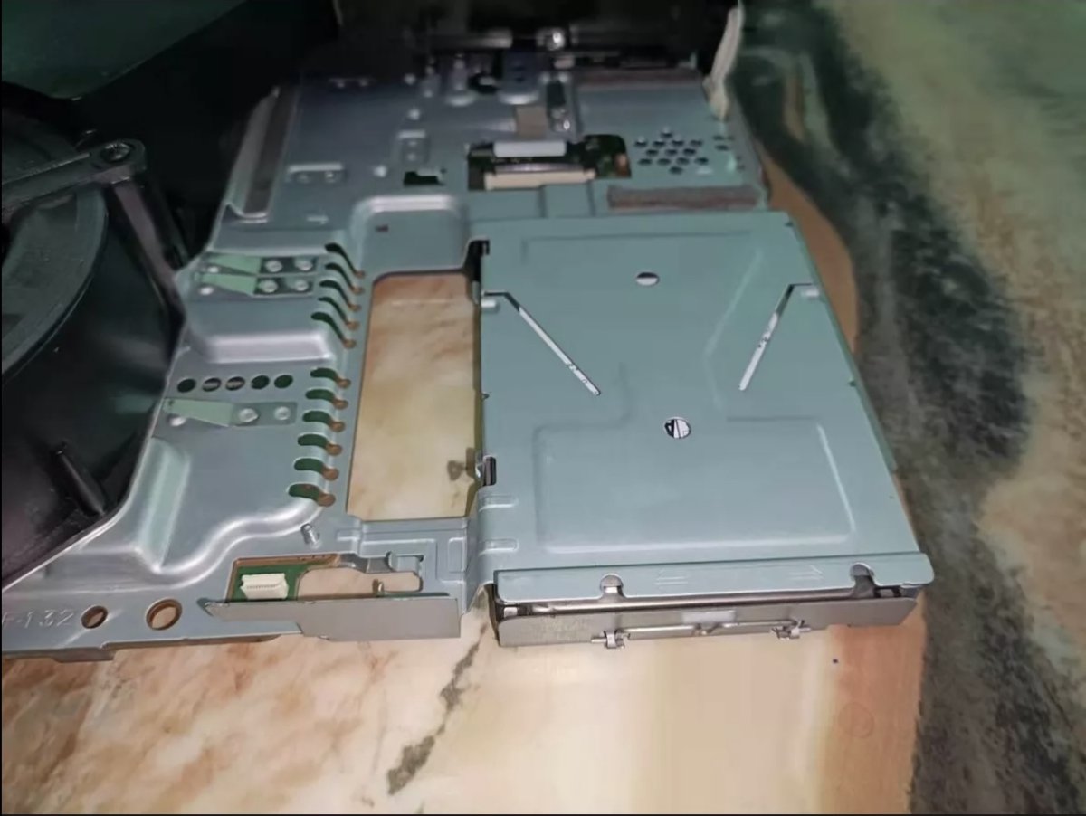

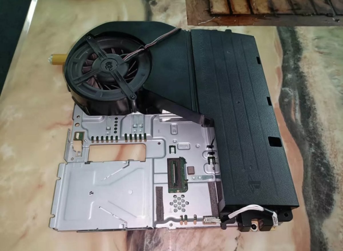

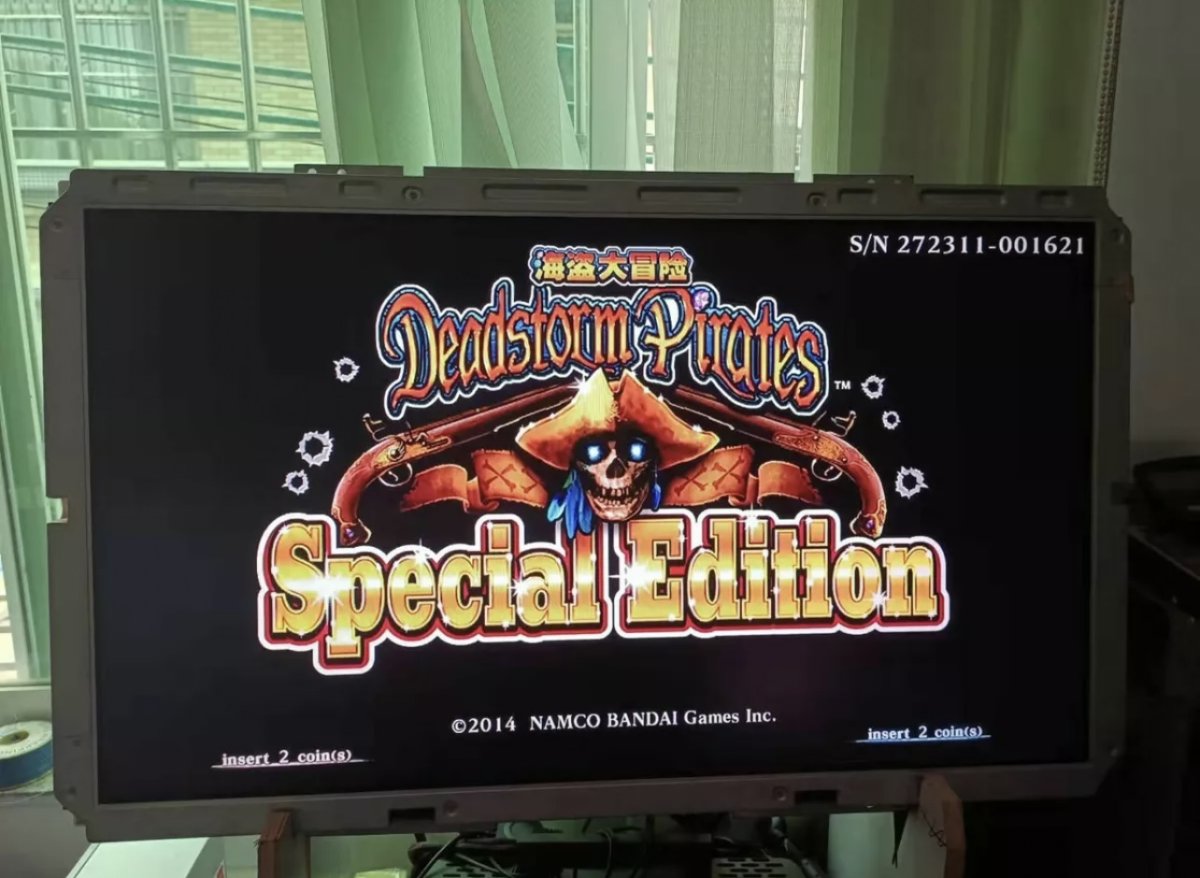

My main interest for this project was this listing from China for a replacement board with Deadstorm Pirates Special Edition. I noticed that the board had the Blu-ray Disc drive clip soldered and was using a retail system HDD caddy and found it kinda odd as all the systems I have don’t have those parts at all. These pictures are what I was able to save from the listing.

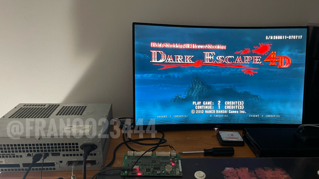

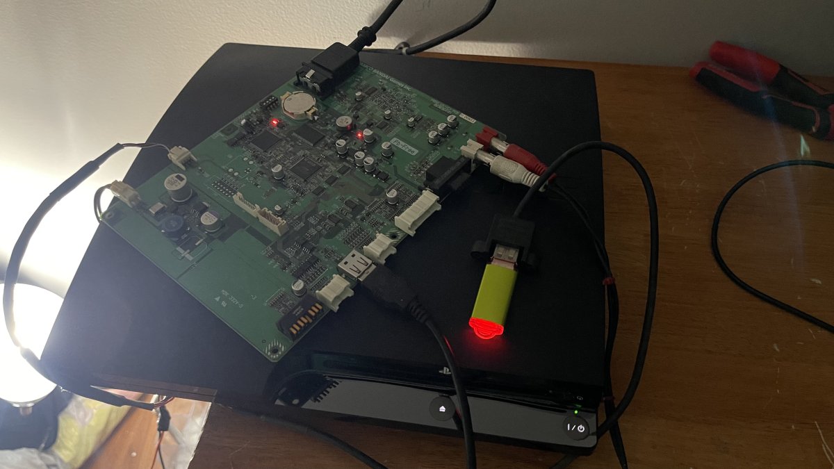

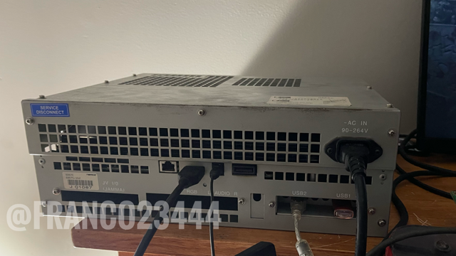

I got a broken 357C not too long ago from a friend of mine who wanted to get rid of it, I thought this was the perfect chance to add my converted motherboard in and have it as a new game. The H050 board was damaged unfortunately and I couldn’t do much with it so I ordered a newer USIO version and decided to convert this system to a DE4D, looks very nice!
