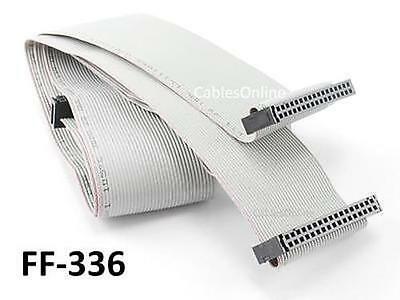

I am trying to connect 2 ribbon cables to the same connector on the pcb
Does anything like this exist?
Is there a y adapter for doing this?
Thanks
You mean like an ide / SCSI cable with 3 or more connectors? Or like actually split into 2 ribbon cables?
What connector type/pin count are you working with?
I have the Darksoft cps2 multi and I want to connect his lcd as well as my multi selector board at the same time to test things
Looking for a way to do this
simple, just add another idc connector anywhere on the ribbon cable you would like, it basically duplicates the connection.
I think its 14pin idc? If you have a hard time sourcing it i can make you some cables, i have plenty.
