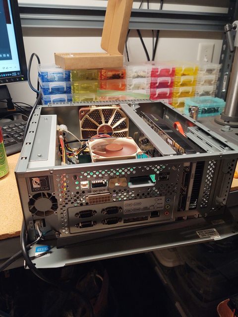

I got my RE2 up and running and it sounded like a Boing 747 getting ready for departure on runway 4 in my arcade.

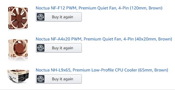

So i got with @Derick2k and he had worked out which fans were needed to silence the wind tunnel test going on in my Chewlix.
Here is the list he sent me..
Here is the initial test for the install..
..At this point I should own stock in Noctua. Just about every PC style arcade PCB I have (246, 256, TTX2, RE2... ) now has had a complete fan overhaul using Noctuas.

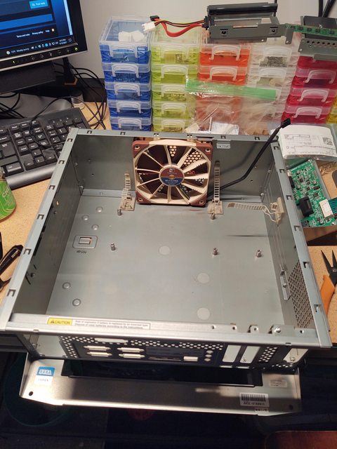

Case fan is pretty straight forward its kind of a pain to get it fitted in..
I did not take any pictures of the CPU fan installation but follow the directions and be patient as you pretty much have to dismantle the whole RE2

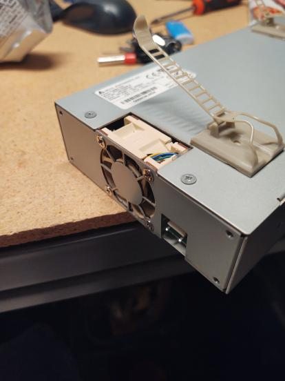

Now for the power supply fan. This required some modification as the original fan is two wire and the Noctua is four wire.
What I did was pop the pins out of the original connector and crimp new pins onto the Noctua fan's wires. Then popped the Noctua wires into the original connector as I did not have one on hand. Saved me from having to order one and wait.
Black to Black (ground)
Red to Yellow (12VDC)
For the other two wires I pulled the sleeve tight and cut them short so they would be hidden inside the insulated Noctua sleeve. (sorry no pictures of that)
