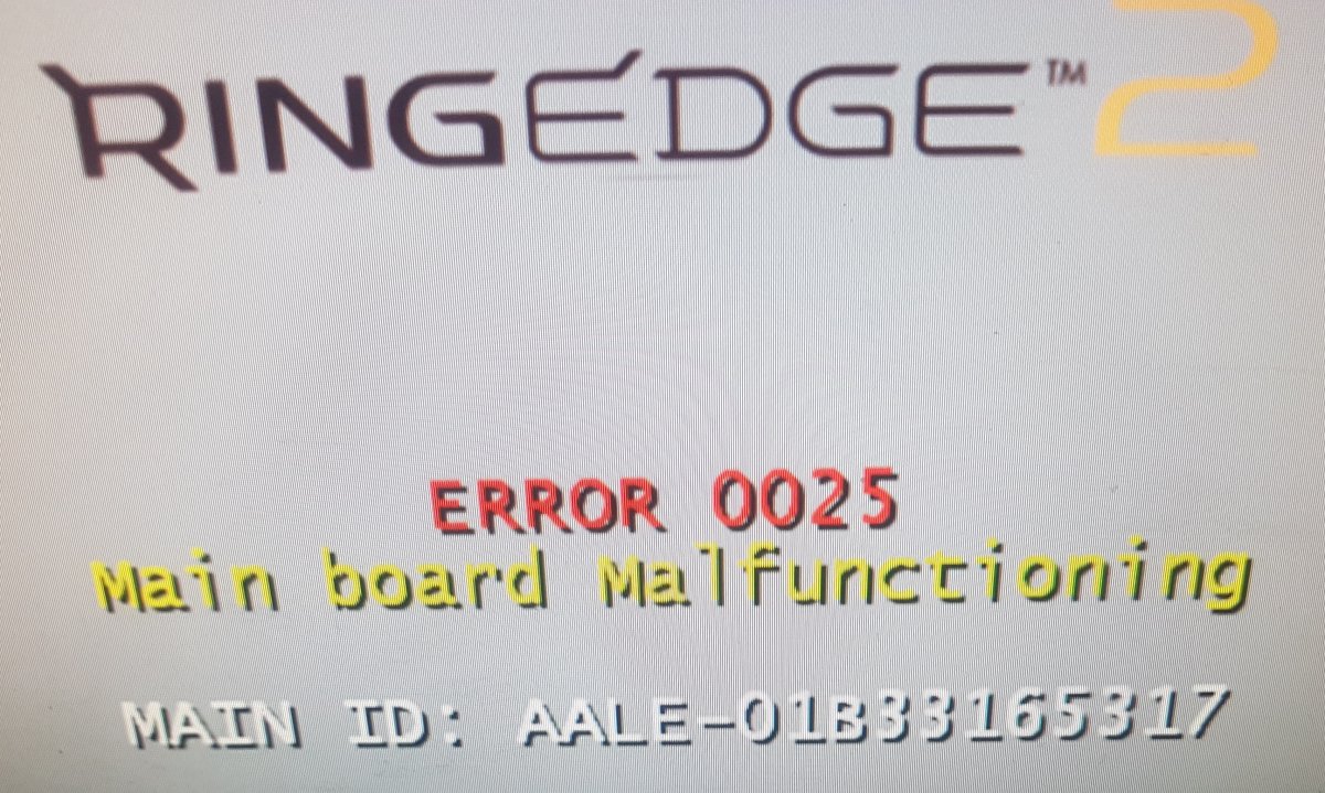

Hello everyone, I try to repair RingEdge Transformers Human Allience (lags during game, sometimes it can’t load windows or game, endless white screen, also sometimes error 0025 main board malfuctoring). I think problem with original ssd.

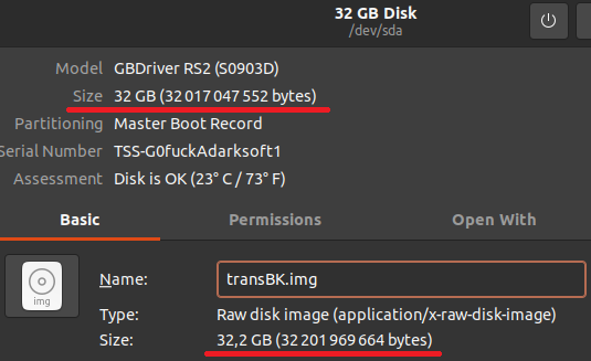

Image ~200 Mb bigger then donor disk.

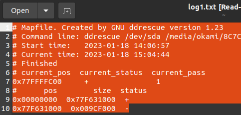

2. dd and dd_rescue can’t read last 10 Mb. Issusies starts on 99.96%

Macruim Reflect with separately partition writing. I manually resized 16 Gb ntfs (SBYR) partition to fit last partition, but get error 0025 on every load.
