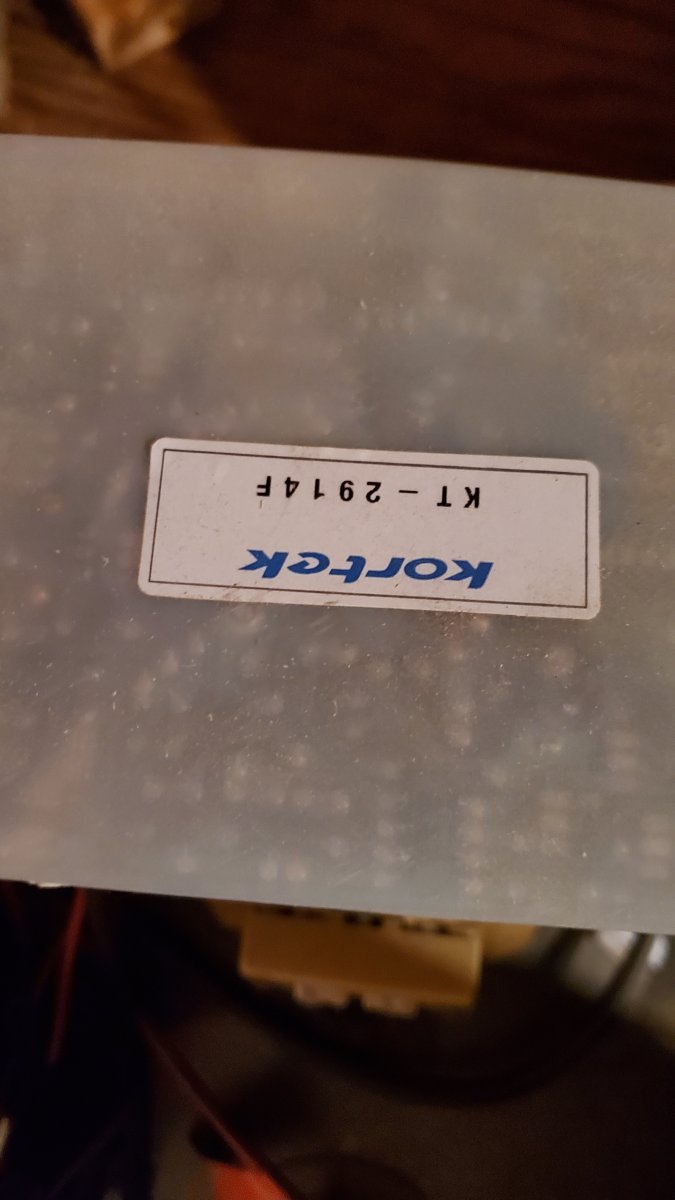

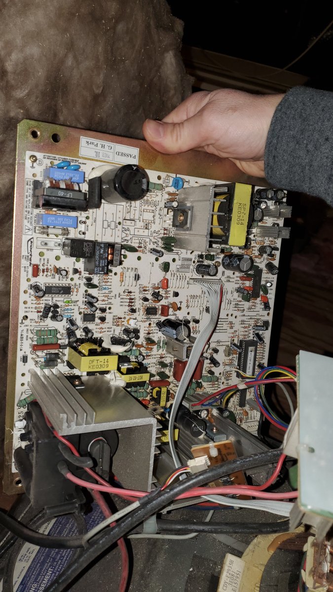

Sorry for the late response. I retrofitted a 27 inch Samsung CRT to get me by. The board is a Kortek. Where would I be able to locate a cap kit?
