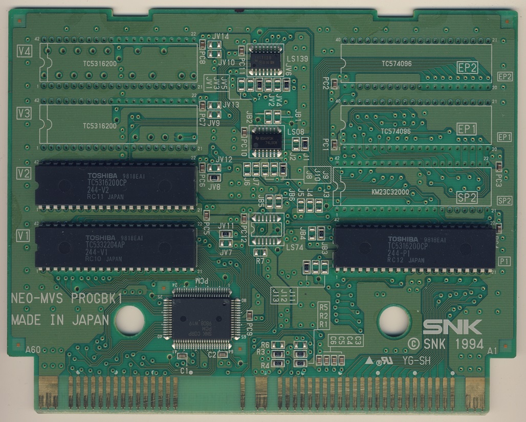

Have been wondering about the PROGBK1 / CHA512 pcb set for a while..
Would there be any way to adress big P roms on this PROGBK1 board?
Later games such as metal slug 5 and Samurai spirits 5 special have bigger P roms than this pcb originally supports..
(BUT I found out that at least ms5 has garbage at the end of the 8MB P rom file that can be deleted making it fit)
However my focus is now Samurai Spirits 5 Final Edition! Which also has 2x 4MB P roms
Since we have so many talentet ppl on these boards I though I would ask for help making this possible :)
Its the P1 slot that max can adress a 27C160 eprom (2MB rom file) that needs to be modded to use 27C322 eprom (4MB), or is its the P2 slot that needs to adress 6MB?
Physically it fits but I dont know how the banking works :/

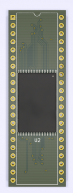

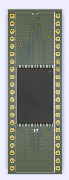

Of cource there needs to be adapter pcb fitted with flash and leveltranslators for all C and V roms, but they already exist, so its only the P rom banking thats holdig this back

it can use 2x 4mb - the jumper table is listed.
I am not sure you understand what I mean.
I want to use 2x 32Mbit (2x 4MiB) P-roms
As far as I can see only P2 supports the 27C322 eprom?
There is no jumpersetting that I can see to use :
P1 - 27C322
P2 - 27C322
If I missed it please show me the jumpersettings, it would help me alot
Thanks!!
i was confusing P-roms with V-roms.
that said, the schematic is convoluted bullshit - i dont know what clown designed that cartridge.
i tried to follow the decoding through the schematic and it makes no sense.
if i could work it out then it could be moded.

I will make adapterpcbs för the C roms. Might make 2x 256MB instead of 8x 64MB, but thats no problem.. for me the problem is still how to solve the P rom banking/handling, since the PROGBK1 donor board doesnt support 4x 27C322..
