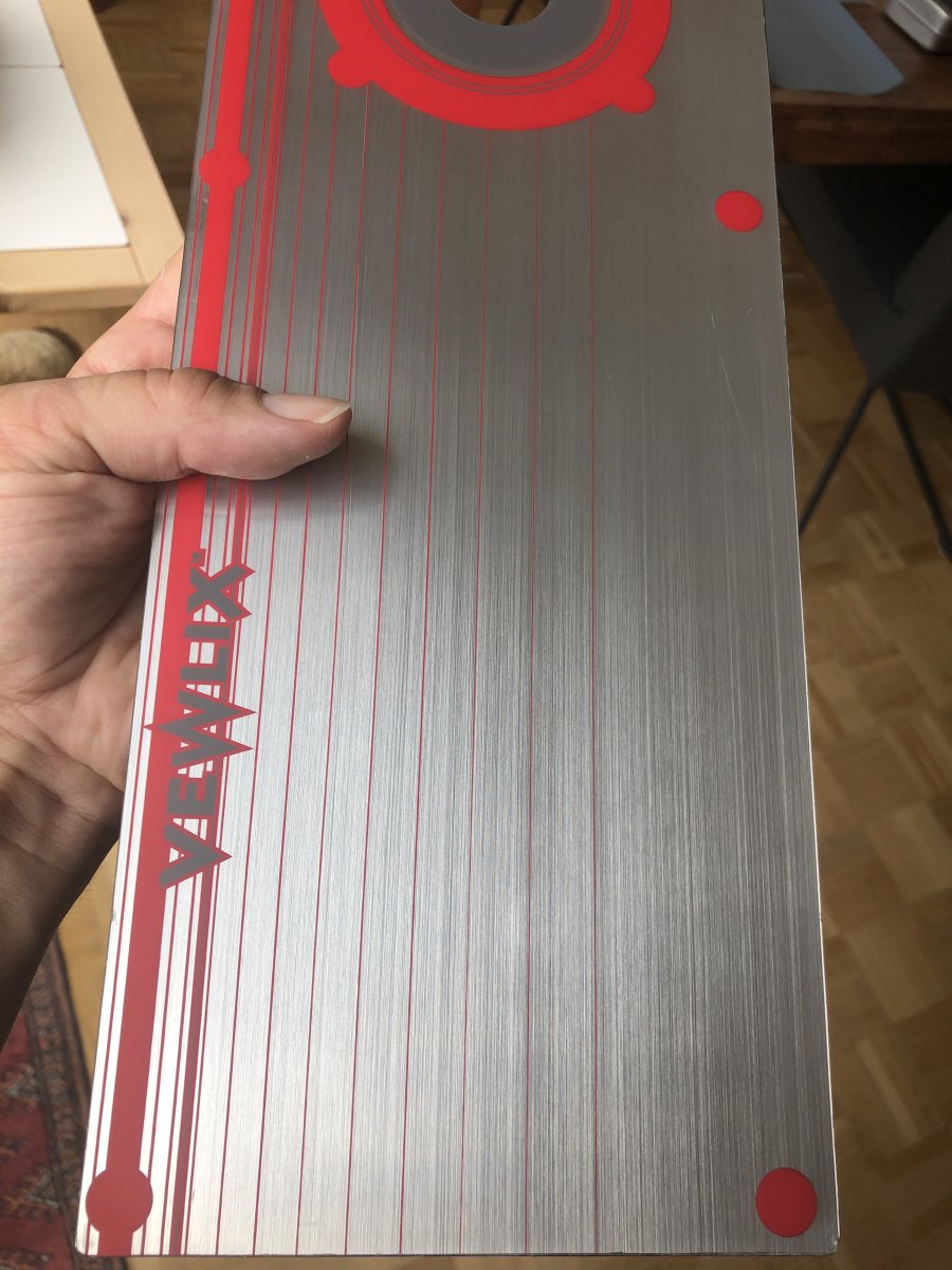

Here is how the Panel looked:

The result was really satisfying.
There are a few (2-3) DEEP Scratches left. All of the light scratches are gone and the Overlay is mirror smooth.
I think it gained back all it's shine and reflection.
I am sure I could have been able to also remove those deep scratches if I would have been more patient with the #600 Sandpaper
and would have just added multiple rounds to it.
Here is the result, however you can really see the difference better in real life:
