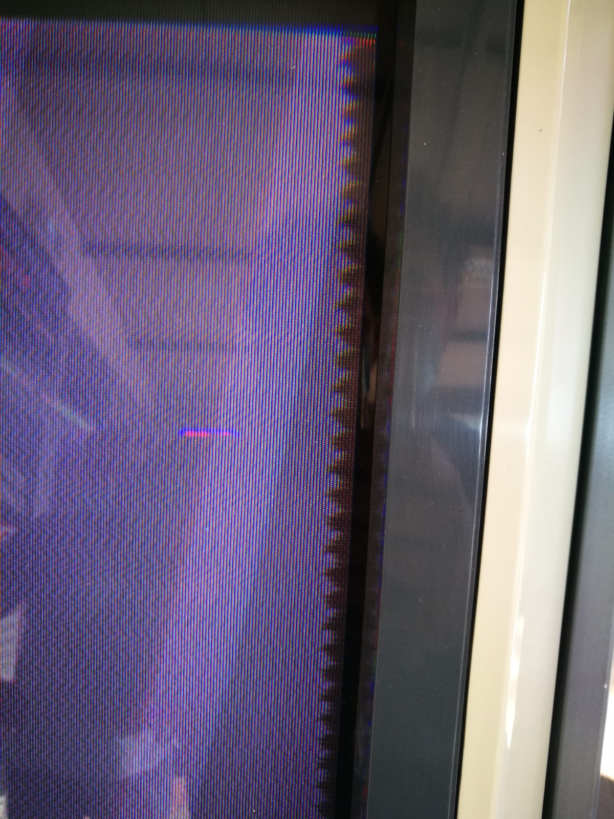

Anyone have any idea?
The side of the picture start as wavy
when the monitor warm up the problem will extend to almost all the picture.

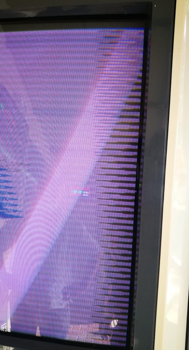

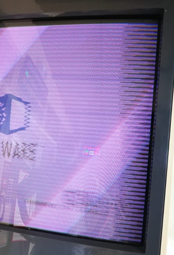

It's related to H size, If I reduce the size of the image the problem go away. I don't think I will have time to do some testing soon, but I will update this post for sure

I have some ripple on +12V rail that change (getting bigger) when I enlarge the image
