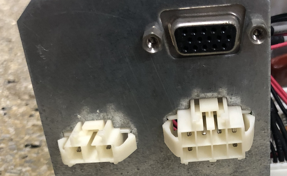

I seem to be a bit stupid about these connectors and pins....
I have a Sanwa P29FX that is pretty much brand new - and I want to make some plugs for it (std/med res and power).
I *think* this is the right 8 pin connector - but the pins look squarish/flat - so not sure what pins to get?
https://www.digikey.com/product-detail/en/176275-1/A106904-ND/2055442
Regarding the power - I think it's this one, but same question on the pins.
https://www.digikey.com/product-detail/en/te-connectivity-amp-connectors/176272-1/A106282-ND/1149444
Validation, and pin ideas?
Thanks as usual!
Matt
Connector housings are correct.
These are the correct pins:
AWG#20-16 Female pin for male housing - 175152-1
AWG#26-22 Female pin for male housing - 175151-1
