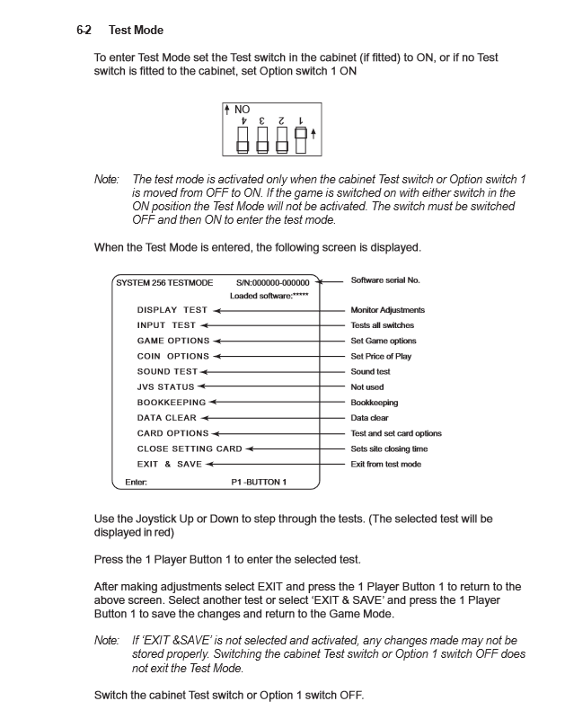

I've never actually successfully accessed the test mode. I'm trying to follow the image above, but I keep flipping the switches and the game just boots with sound and no image.
Also thanks for the heads up on Gundamn Nem. :thumbup:
There's no test button in your cab?
The dip switch bank is upside down on the 246, however, on the 256 it's right way up. You need to flip the rightmost dip on 246, leftmost on 256. The other three dip switches are for different video modes. You don't want to touch those.
