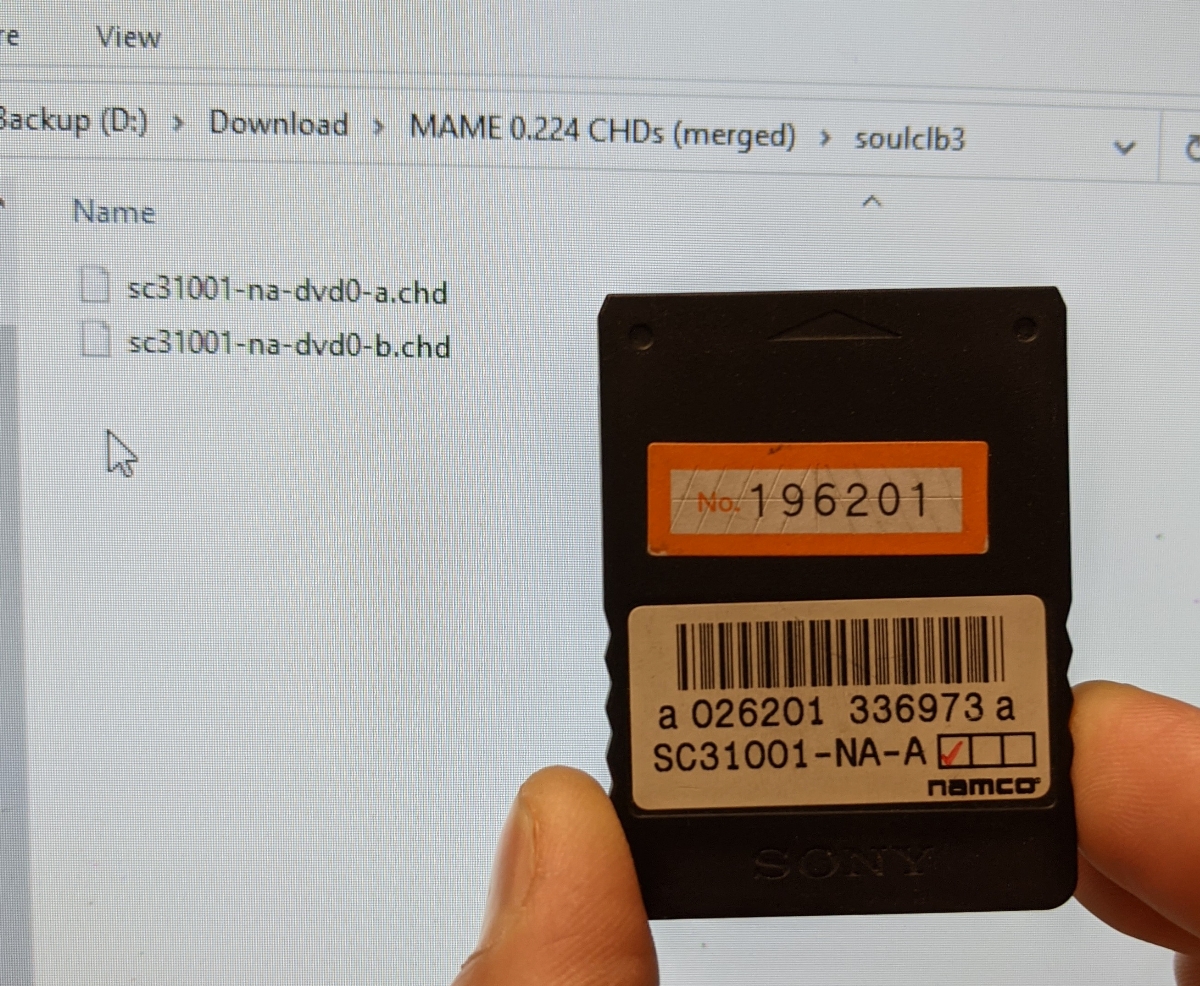

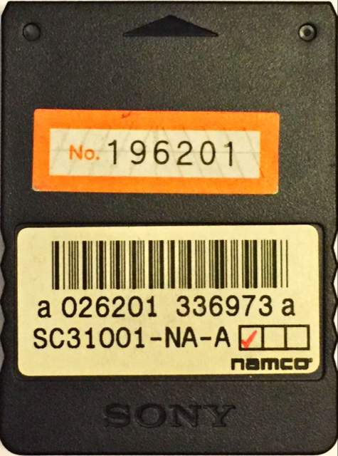

Hey, that SC3 dongle used to be mine! :)
I scanned it for cataloguing:
