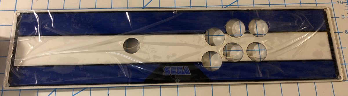

Also during the time I was waiting to prep and paint things, I located a lot of the detailed parts I needed/wanted for the restore.
Parts still needed:
  • New monitor glass
  • Various screws
  • Need to rework the coloring of the CP decal
Some photos of the good:

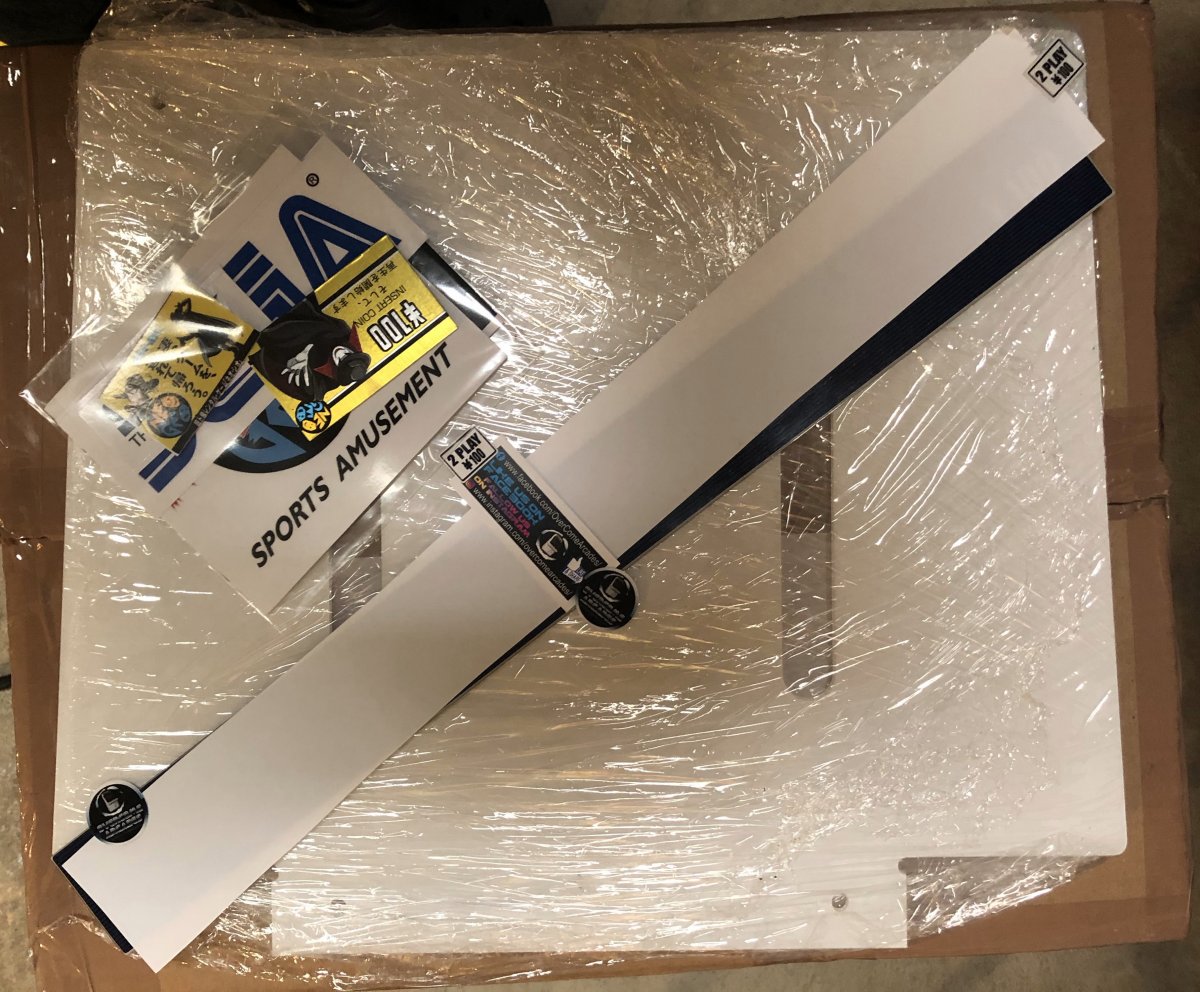

Ordered 50 of the grommets to save on per unit price. Already have passed on my 46 extra. Long-live Aero City cabs!
