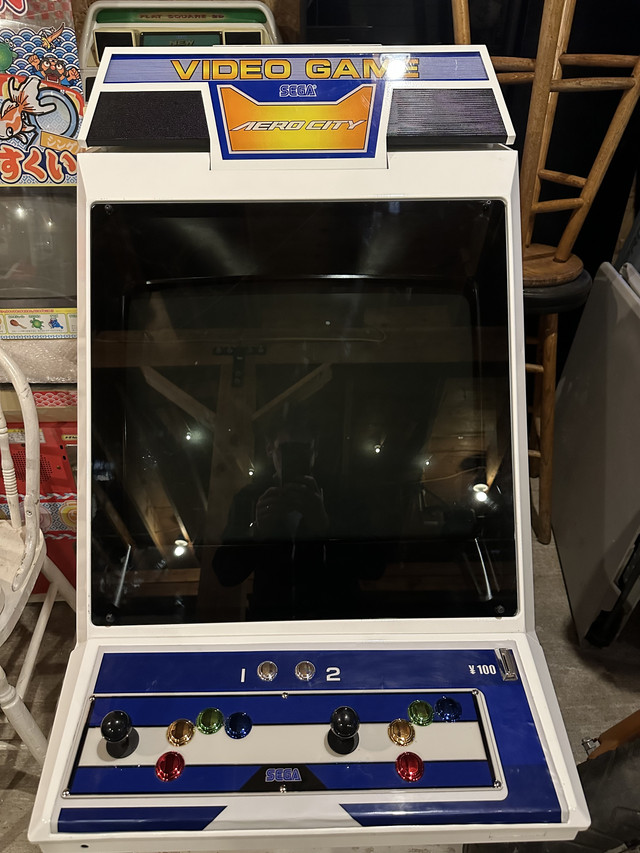

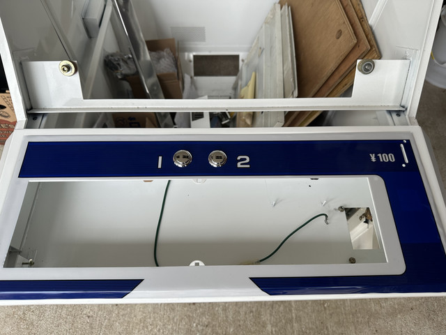

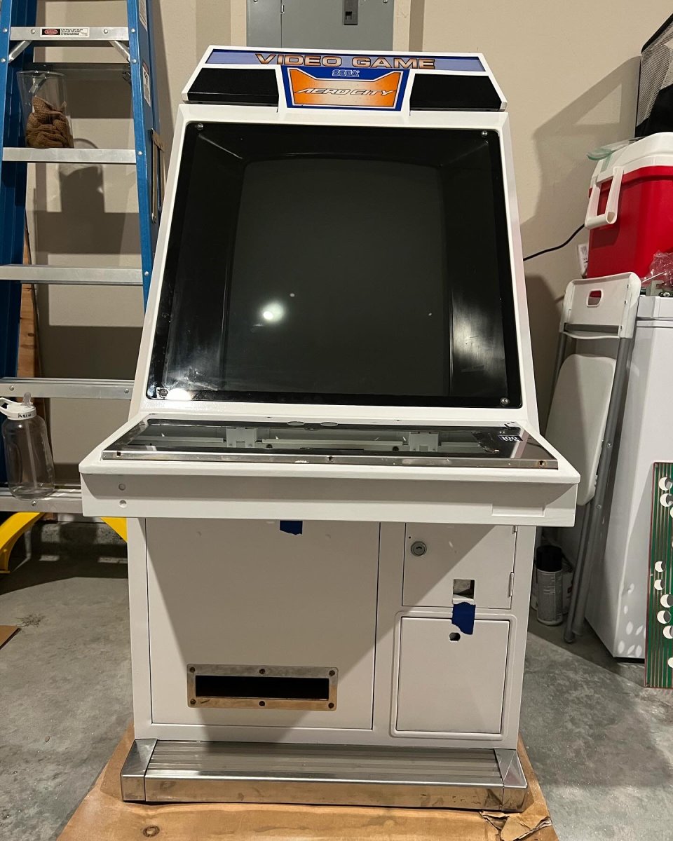

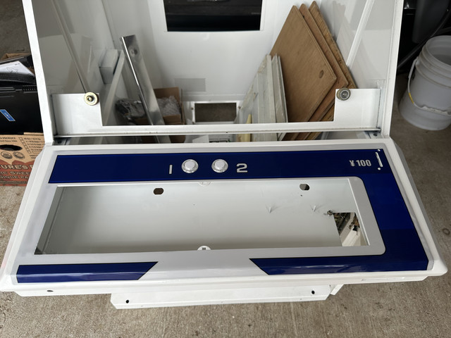

I got the rest of the pieces from the Powder Coater for the Aero City and am ready to tackle some reassembly along with some CP parts from Arcade shock.
Time to "finish the job" on the bondo CP I stripped and coated earlier.
The GateNinety wrap had to be guided over the yen and screw holes while still linging up perfectly with the Control Panel opening.
I used a heat gun this time in hopes it would help loosen the stiff overlay of the surround. I was pleased with the result.
I decided to use white 24mm buttons even though I bought Silver to match my metallic theme.
Then I looked at my @alberto1225 CP and decided to stick to my plan and changed them back
With so much metallic going on. I decided to neuter the balltops and go with default gloss black.
My brain and eyes agreed and decided to move on to securing the CP to the surround.
All the screw posts are powder coated... F@$!
And my wire wheel is on its last stubs.. Must preserve this precious resource to save myself a trip. Lithium grease in every nut and on every screw post as well.. I wil NOT be wasting a trip today!
The stubby wire wheel worked and the CP is set..

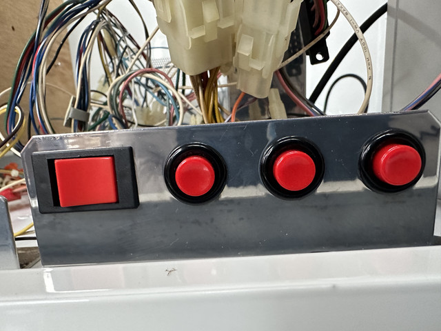

This time I went a little custom with the "mettalic" theme and powder plated the Yen chute, PSU, power block, Service panel, Jamma holster, and monitor hinge. The cold rolled steel just wasn't doing it for me..
I finished installing the PSU wood and cleaned up an Aero JAMMA ply I retrieved from one of my other project Aero's.

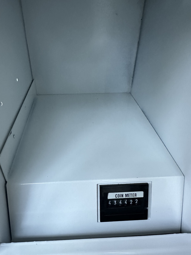

Finally I hooked up the Coin meter and installed the coin bucket.
I need to grab the a repro footrest and Ill be close to closing the deal on this cab..
Next up is decals, Footrest, glass border, Monitor, chassis, bezel and wiring cleanup.

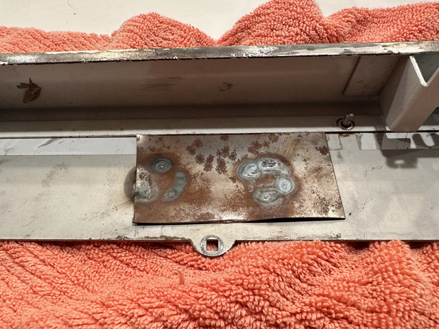

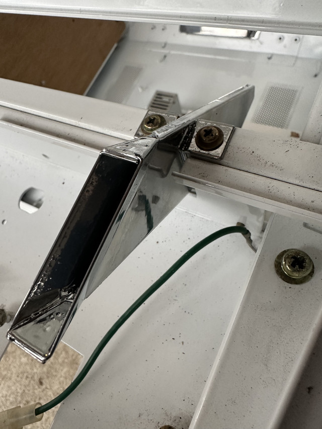

I suspected the bezel was damaged and apon closer inspection. I found it was pretty beat up by the slight move.
I learned awhile back the bezel edges can be cleaned with Isopropyl and then lithium grease so I went to town on the initial cleaning. Like my other uncleaned bezels the metled grommets took a lot of wiping and ISO to clean off
I got my electrical tape out and used my finger to apply a little pressure while I taped each torn angle.
Now it was time for a a good amount rubbing with my white lithium grease to remove the oxidation from the plastic as to blend the tears and general age of the thin plastic.
I'm happy with how it turned out. I was crushed to see at first it but fixing it lit a fire under my ass to get back into the hobby. Ill see you all around!

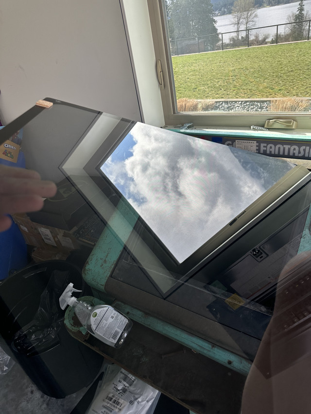

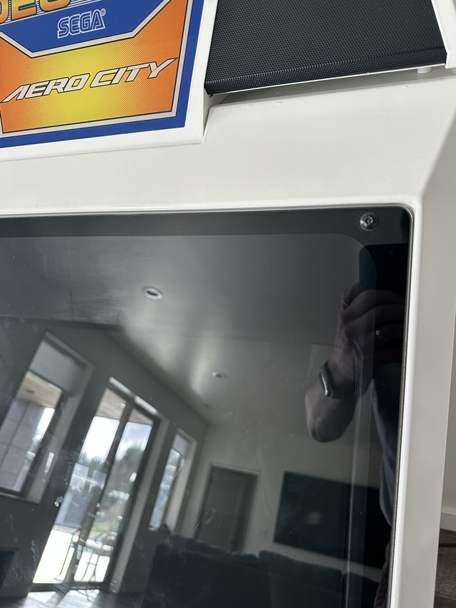

Now that the bezel is repaired, I wanted to protect it under glass in case I procrastinated again for a long period of time.
I noticed I didn't have glass or screws so I took a screw from my Aero at the lake house and headed to the hardware store
No oversized panhead security screws to be found so I bought some black 5mm hex screws and a rubber gasket and headed back
The pan heads were a bit smaller than the hole size but this will have to make due until I can scour McMaster-Carr for better screws in the future. A test fit held snugly against the glass at the lake cab

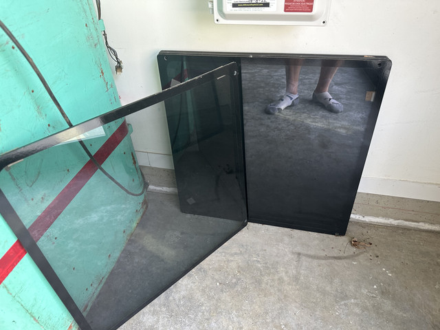

Now onto the glass replacement. This is something I did months ago to replace a bunch of glass that some bad kids carved their giant intials on, rendering the panels useless. I contracted a local glass company to make a replica of my original with matching tint. They were very expensive. I cant remember exactly how much but I want to say $180 for the glass + $40 for the glass black border decal+ $20 for the decal guy to apply the air release film to the glass.
I took a pane home and was ready to apply it!
The bezel fit nicely so i decided to bolt it down..
The screws would not thread due to the powder coating. I should have remembered to bring my tap and dye set but there is always the promise of tomorrow. At least now my bezel is protected from future harm by partially threaded powder blocked thresholds..

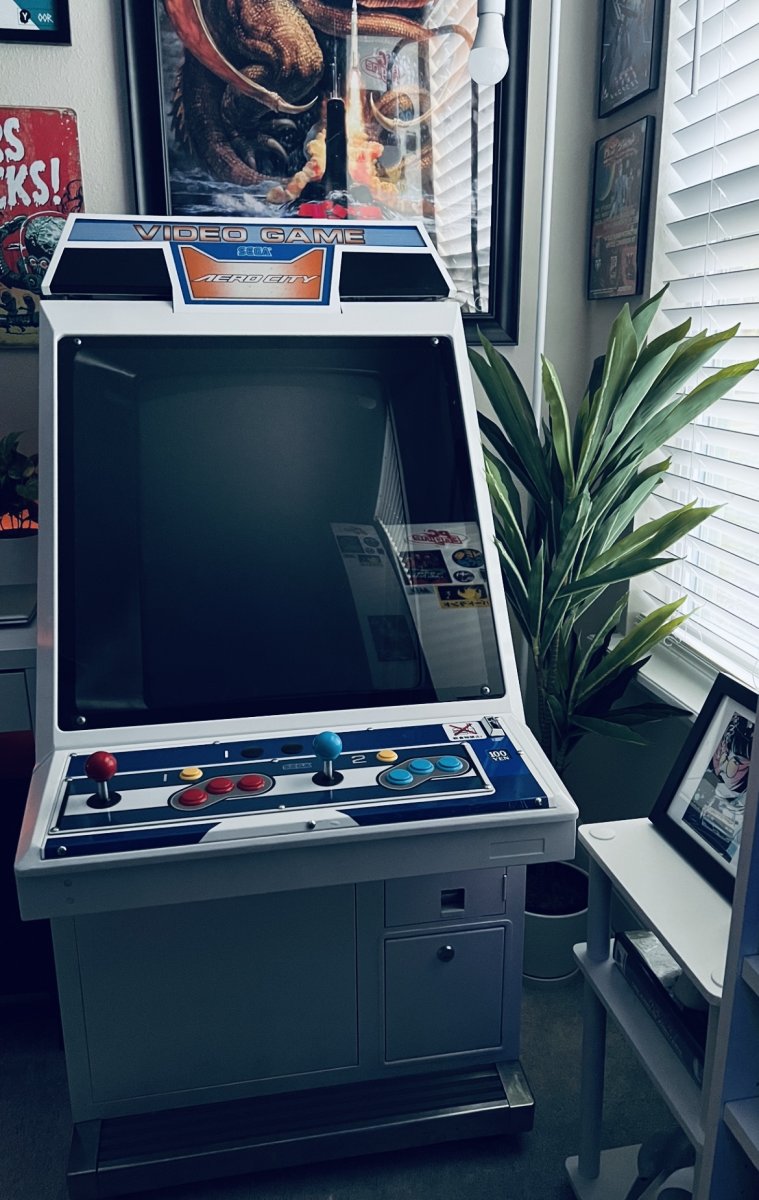

Excellent work. I used NOVUS 7020 on my Aero bezel when I was scrubbing mine down; it worked really well:
But I feel your bezel pain. You look at them wrong and they shatter lol.
Just to add some motivation (not that you need it), here’s my cleaned up AC…it may be my favorite cab:

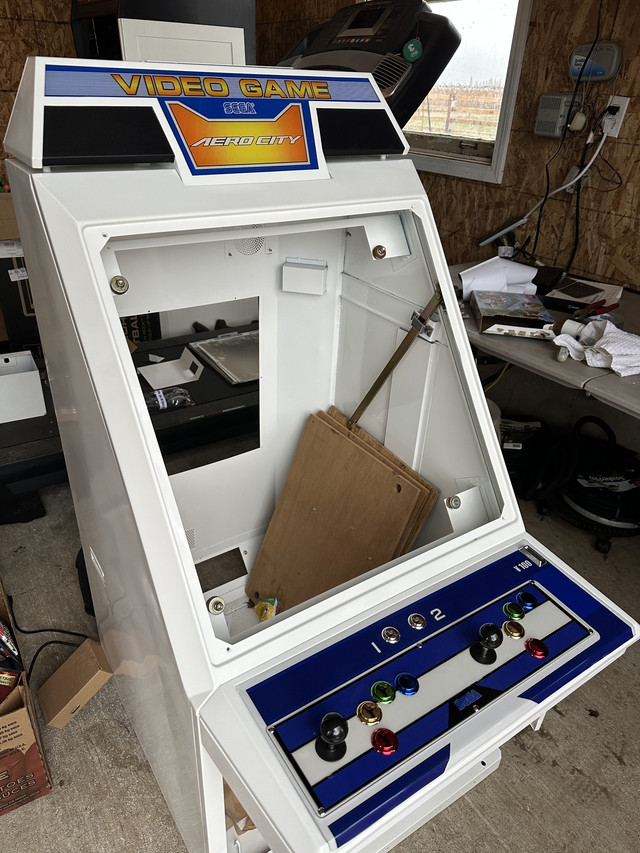

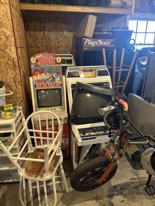

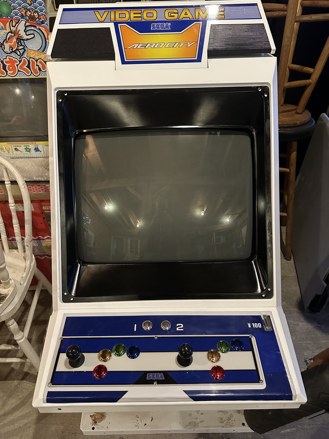

Thanks Ziggy. I had x3 of 4 going strong for a couple years. Now I keep one at the lakehouse, one in the top of my barn, and 2 are having their monitors rebuilt again again.
I now work inside a tiny rework station I built and fix electronics and also work on my cabs
Heres a recent pic of it after monitor rejuve

Thanks for the update. I’m glad to hear they’re more or less serving you well.
