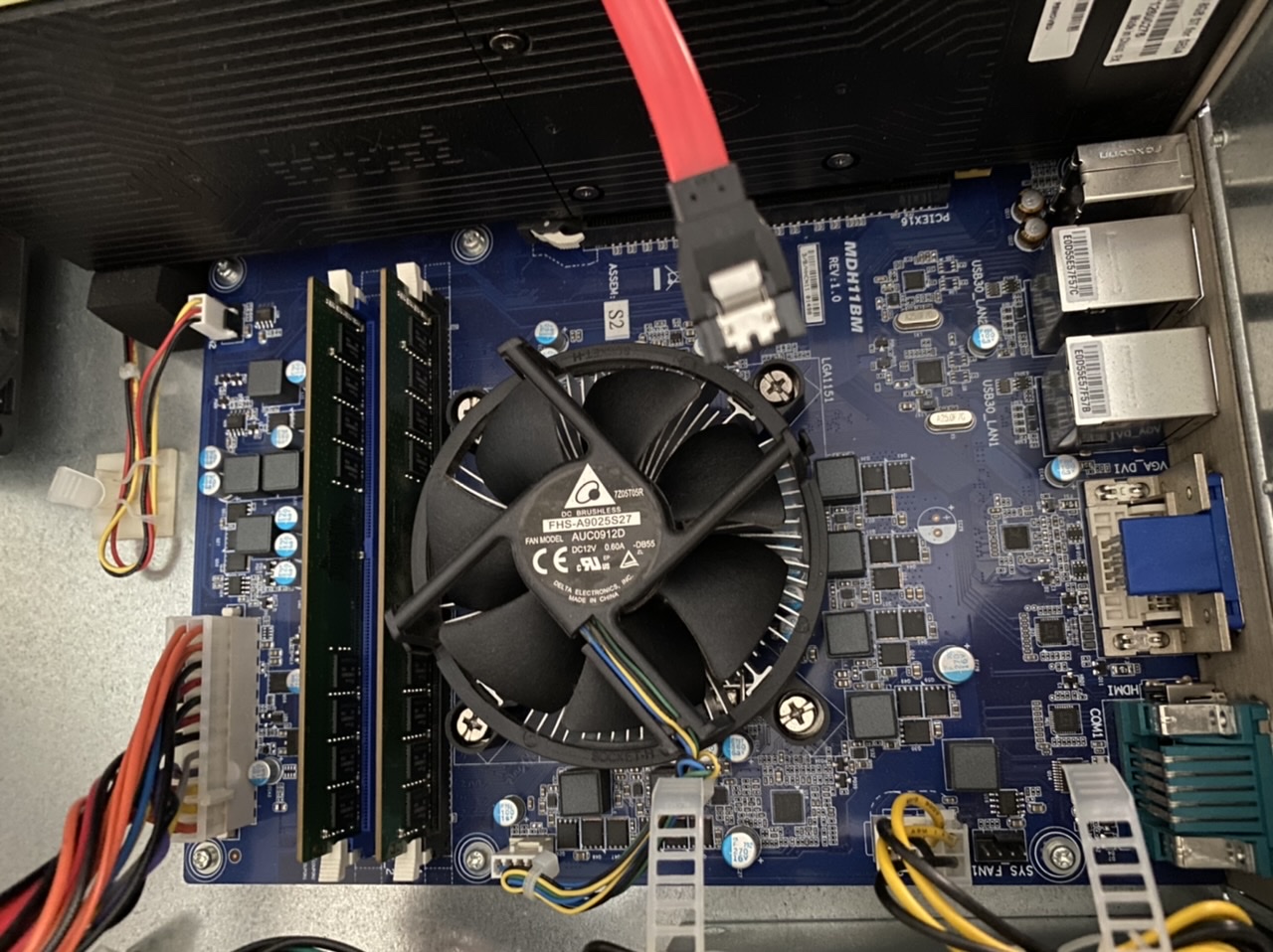

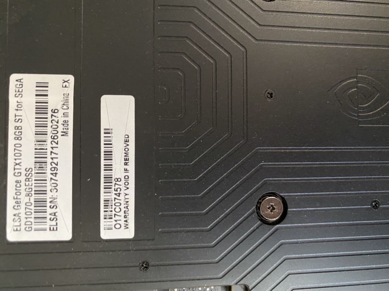

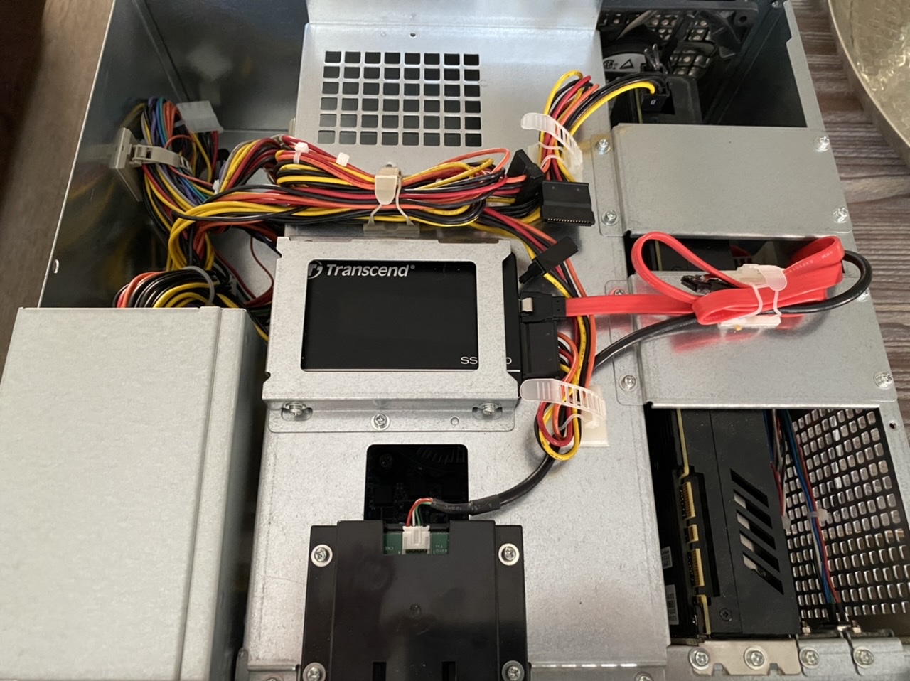

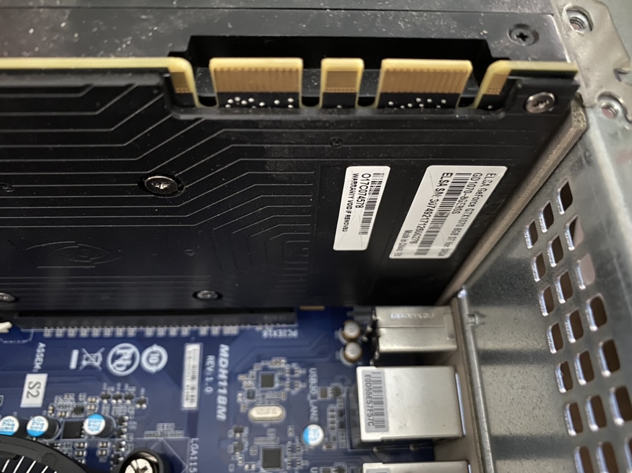

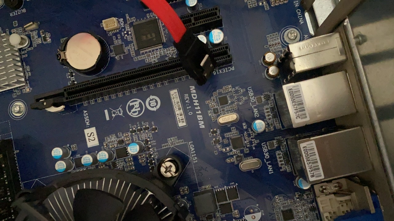

As this sega system is the latest 2019-UP
and maybe the final Sega release who knows... so ,lets open her up to understand what’s inside :)
From the outside and inside it’s a complete new system it’s crazy beefy
Uses a usb stick for sec chip,
Has a Normal PC (gigabyte) mobo
Uses 16-32 GB of ram
And has a Nvidia 1070 8GB video card up to 1080i 11GB special made for Sega so there must be a custom firm on this baby
inside it has a normal ssd
I have to check the cpu yet but it must be a I7

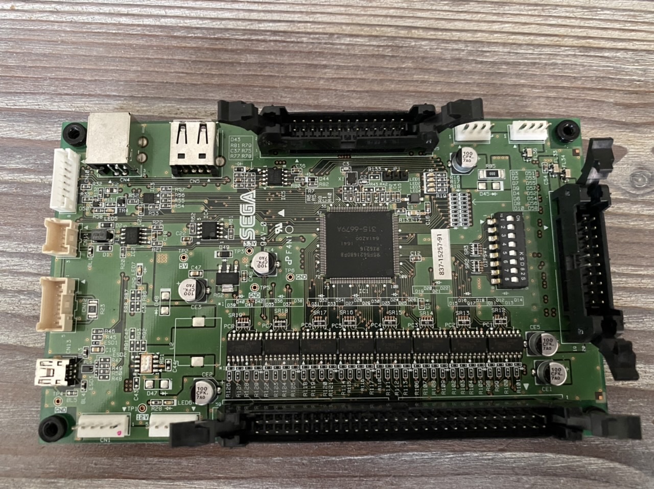

I running on the newest V4 Sega I/o

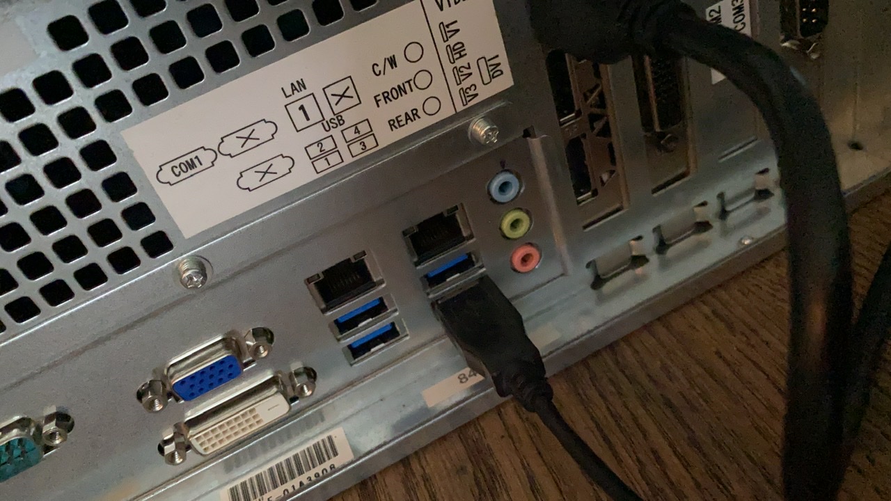

Yeah Figure as most have the rental key not included .some full machines have no rental as mine was pulled from a original SWDC,but you also need to have the Aimé connected as they system won’t boot without it :).

it looks like they're using an off-the shelf mobo Gigabyte MDH11BM Rev 1.0: https://www.gigabyte.com/us/Embedded-Computing/MDH11BM-rev-10#ov
IIRC RingSystems were custom
the plastic cover and IO plate on the GPU look like the HP and PNY variants to of the GTX1070, but the consumer models I've seen are missing that metal heat spreader on the back-side. that seems to only be included in the nVidia founders editions.

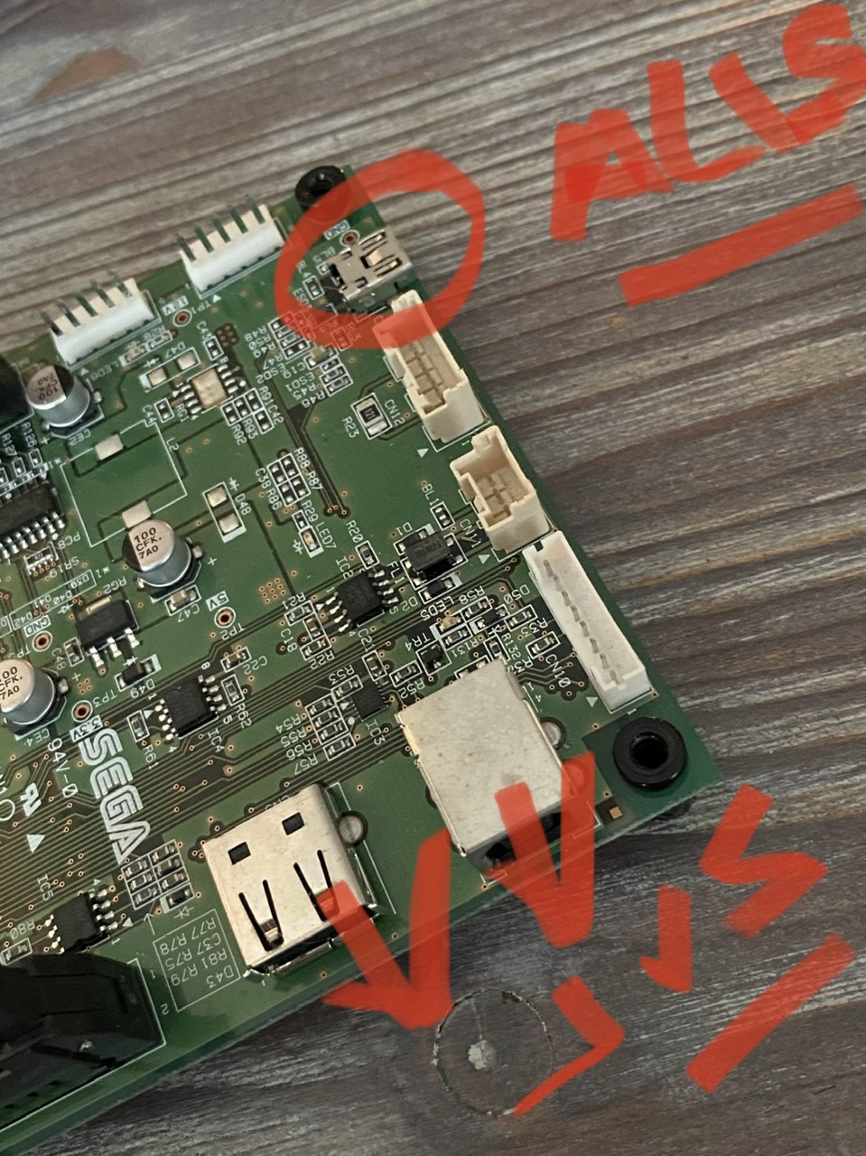

any idea what the new CN10, CN11, and CN12 connectors are for?

Don’t know yet but must some extra connections like on some other i/o s to support maybe ticket stuff or extra side inputs . I have to check the manual maybe there is some info in there
but there are also some dipswitches on it so maybe you can alter some inputs with a flip of a switch
