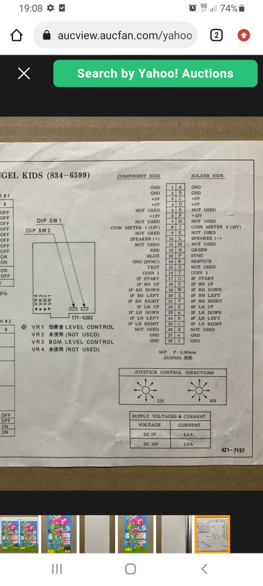

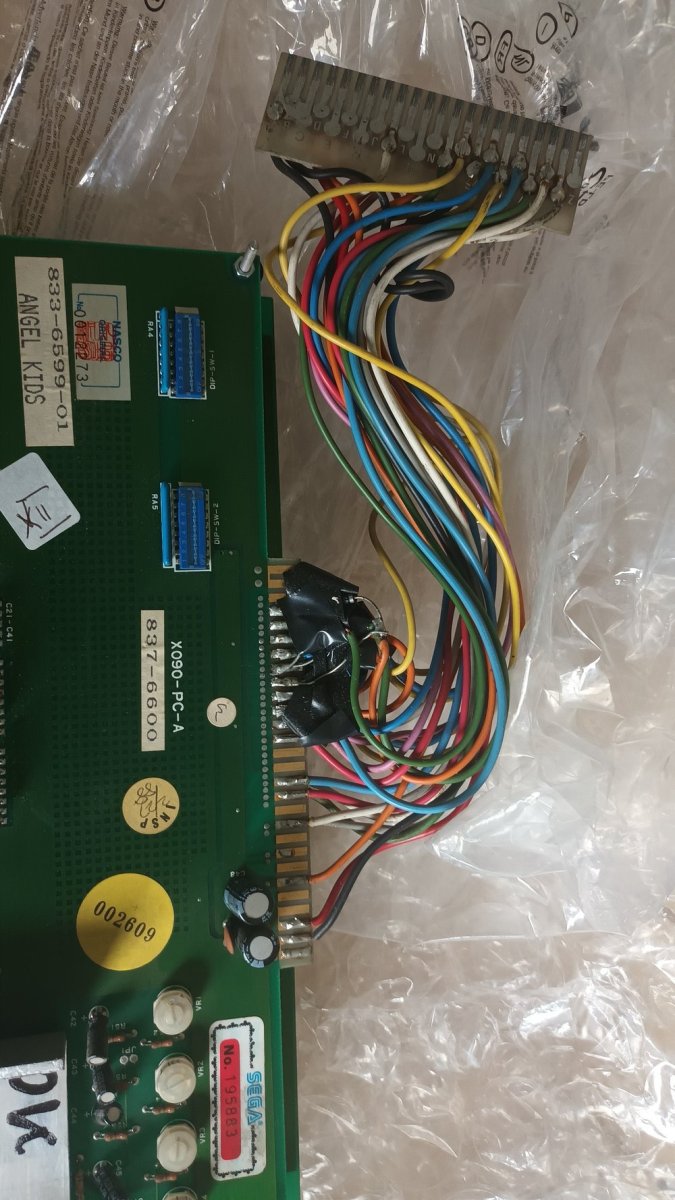

I've been asking around to find out the pinout for this pcb, and so far the info is rocking horse poop.
Unfortunately I don't have a scope, so before sending it off to other people, I'm hoping someone just knows it off hand.
Should be the same as sega's Space Position.
