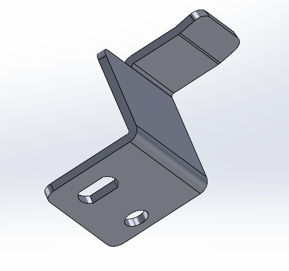

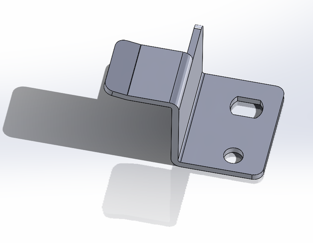

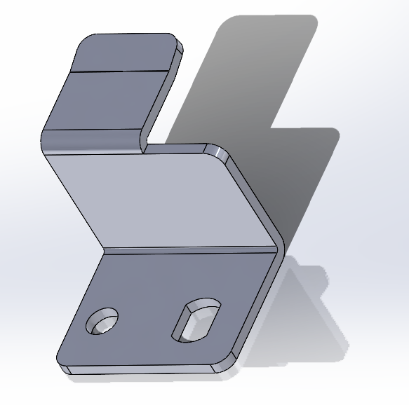

Hi,
Here : https://mega.nz/folder/LVBF1bIC#mviYra1MeEKHh2oefTcxLQ :
  • .dxf
  • .pdf
  • .dwg
  • .slddrw (Solidworks)
  • 3D in .stl
  • 3D in .sldprt (Solidworks)
Notes :
  • you need 2 pieces per AC (or NAC), be careful there is no symmetry, they're both the same
  • the thickness of the part is 22/10 mm but in 2 mm it'll work very well, it's a more common thickness
  • the Ø6 hole has no use on AC or NAC
Thanks for doing this!

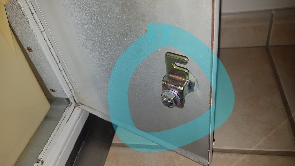

I'd love to have one of these for the coin door latch. My AC came with a terrible aftermarket lock and the latch won't let the door fully close. It would be nice to print one until I can get an original.

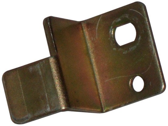

Hi,
This ?
