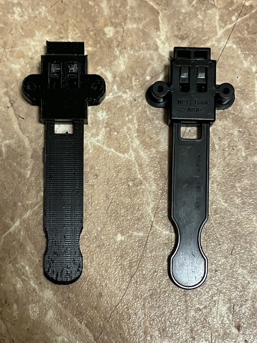

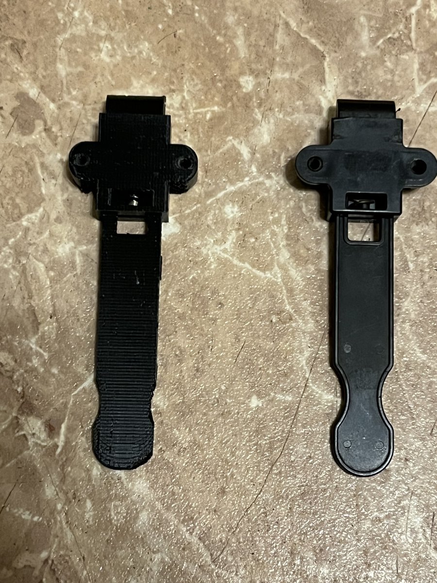

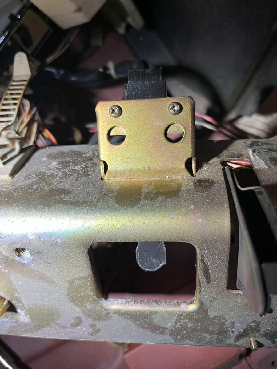

I can't be the only one out there with a busted Sega Blast City so here is a 3d print model for the 2 pieces. Tolerances are tight so there may be a little bit of post processing to get the pieces to slide freely and I didn't have a spring so I designed it for a retractable pen spring. If someone knows a good source for something closer to an original spring on these please let me know.
Feel free to reach out if anything needs revision.
Edit: Pieces should be interchangeable with real parts as well.
