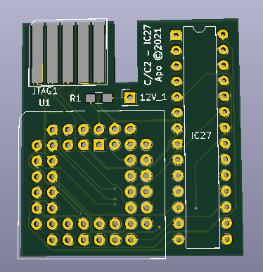

I had previously reversed that chip in an ATF1502 using an adapter of my own:
(Note that I reused that adapter later when I reversed Sega's System 24 protection chips which are also EPM5032s)
That was good enough to run unpatched original code, but not very nice looking.

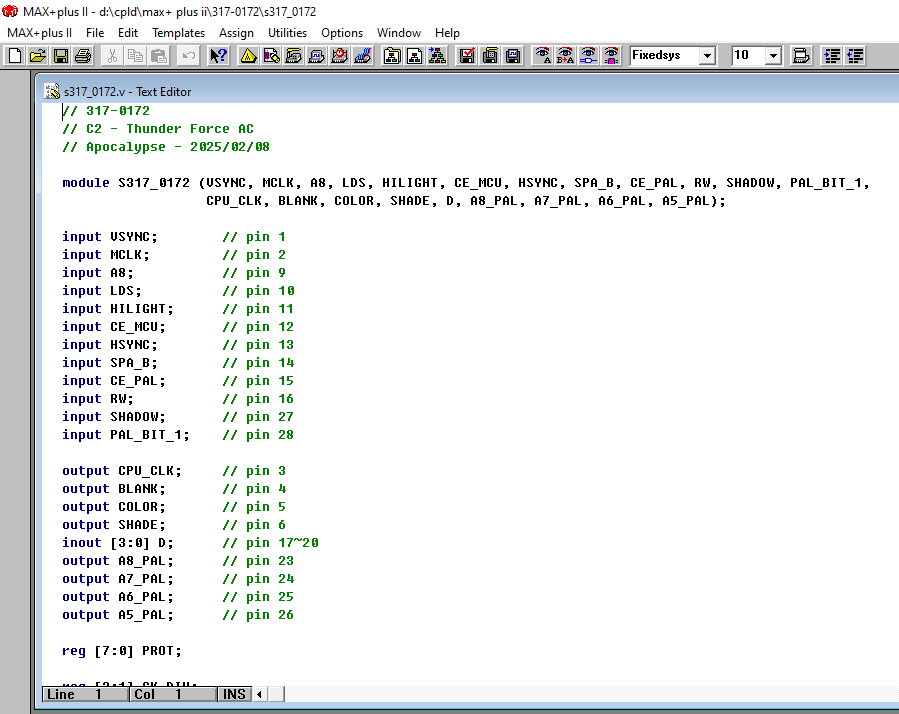

1) Software
What you need is Max+ plus II, and of course a valid licence. I tried several versions with no luck, most not working past WinXP (I tried them in a VM), but then I found a V9.3 on the Internet Archive, including a valid license file, and even compatible in Win10 as a bonus:
https://archive.org/details/1999-altera-max-plus-ii-93
Many thanks to Beta vulgaris L. for the upload. :thumbup:
I converted my code to that obsolete version of Verilog, it compiled and fitted in the targeted EPM5032.
