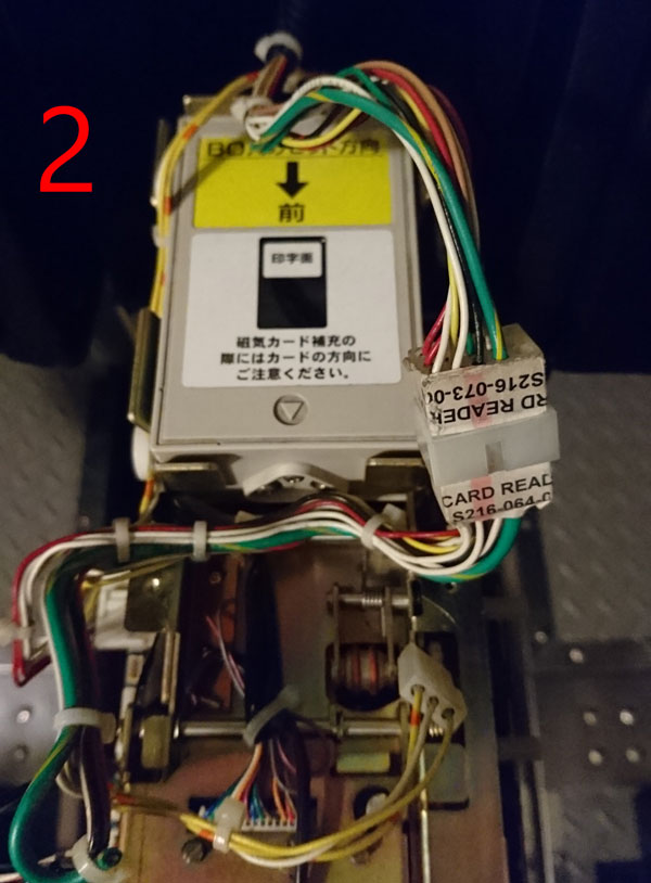

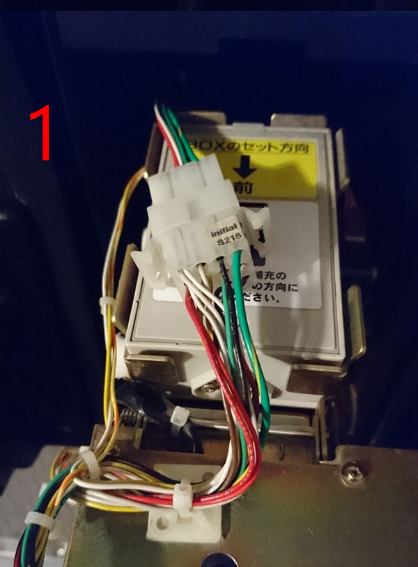

Image one shows the old connector, image two is the newer harness with the smaller connector.
