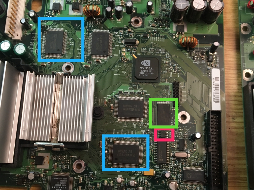

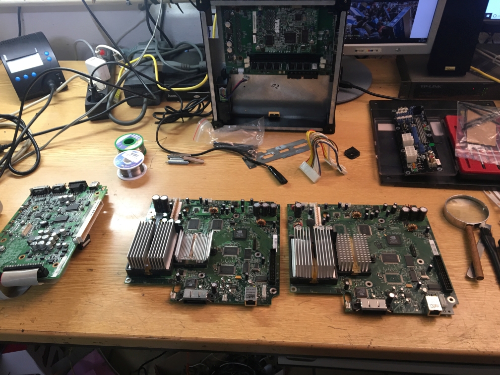

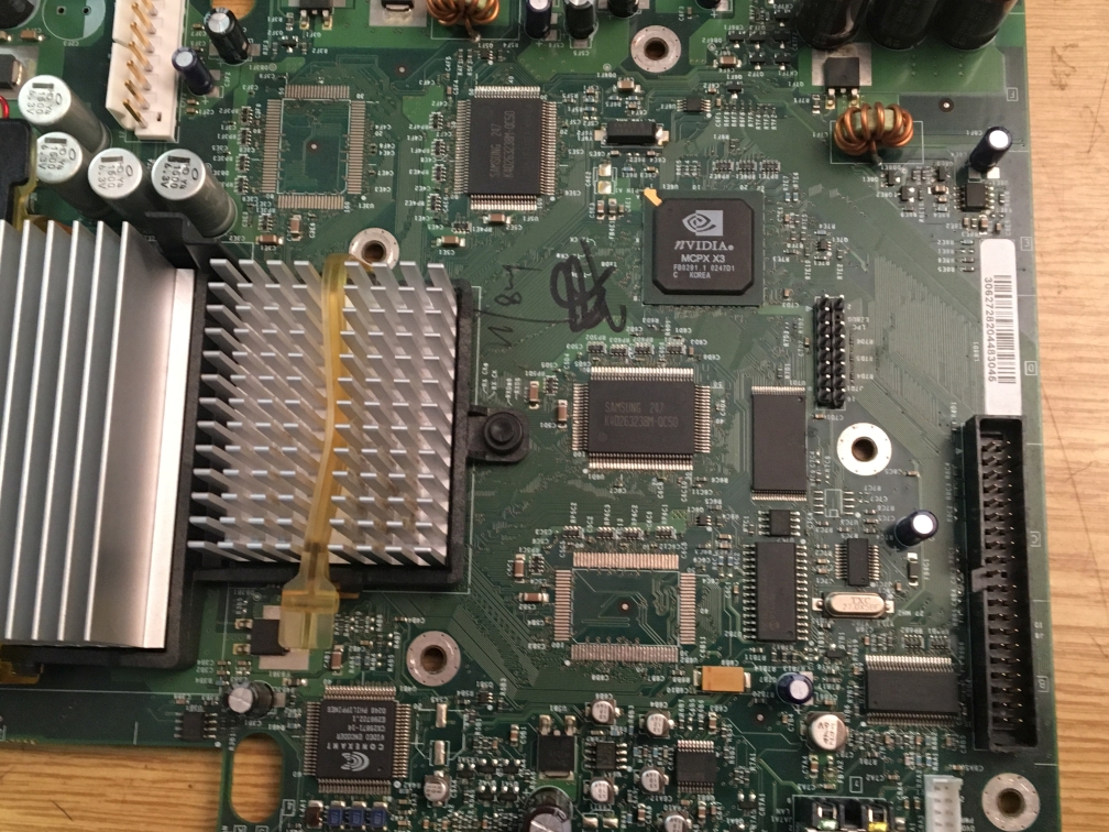

Hello I have a broken chihiro and question is it possible to make a conversion from a normal xbox mainboard?
I would try to swap the parts on the pictures!
1: TSOP Flash
2: Eprom
3: Ram above and below
only the question is that is sufficient because the NVIDA chip of the CHIHIRO xbox board MCPX X2 and console MCPX x3 is?

1: Chihiro
2: XBOX

Won't work. The problem is that MCPX x2 and MCPX x3. The Chihiro uses an earlier version that won't work with the newer version.
