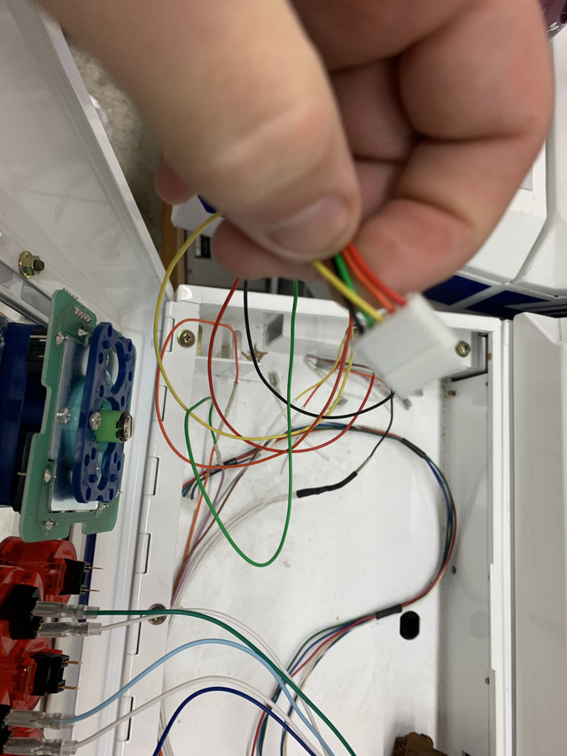

I got my JST connectors in and was ready to unify the grounds but then I noticed my 5 pin JST connector was too small.
I’m at the point where I wanna say $@&! it and just solder leads onto the male pins but I know not to trust that part of my brain in this hobby.
Does anyone where I can find a JST 5 pin female connector for my LS-32-01-SS joysticks.

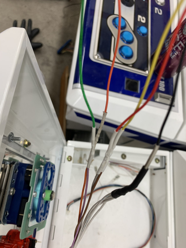

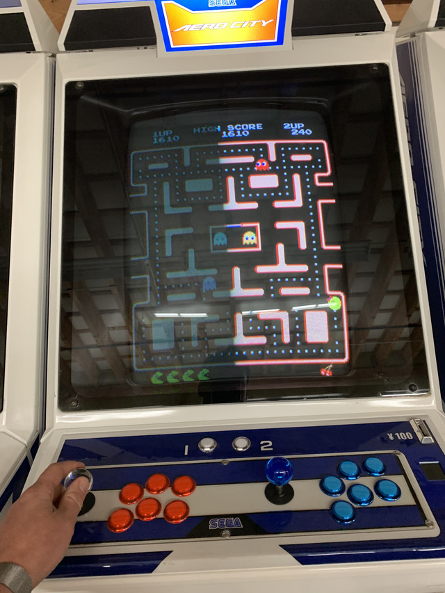

I got chance to tinker yesterday..
Thanks for the help guys, with the 8-pin fork to 5-pin JST harness.
After tying the 4 grounds into one. I messed with the directional till they were proper. I was going to use to use small wire nuts but felt like that was too lazy and messy. After being inspired by @opt2not's custom harnesses I sat down and soldered each connection with a heatshrink.
Now I have to replicate my work 5 more times until I populate the final three Aero's with new LS-32-SS's
Now I can play shitty bootleg Ms. Pac man all day long...

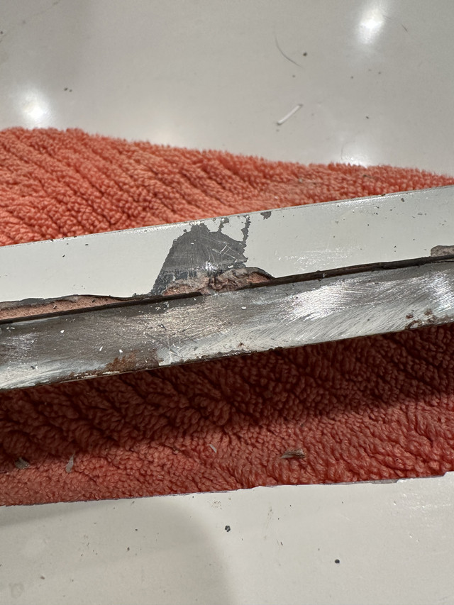

Well here goes the reversal. My neck was cramping just looking at it:
I grabbed everything but the tool I needed (a chisel) and snagged a flathead, hammer, scraper, spackle knife, and razor knife and got ready to pry this apart.
The 2 panels separated eventually with some precise razor knifing around the inside CP panel but that just uncovered my worst enemy.. TONS of Bondo!
Bondo removal took the most amount of time and seemed futile at certain moments as hammering a scraper and screw driver did nothing against the rubbery cement and everything to my wrist.
After 2 and a half hours I finished the first piece..

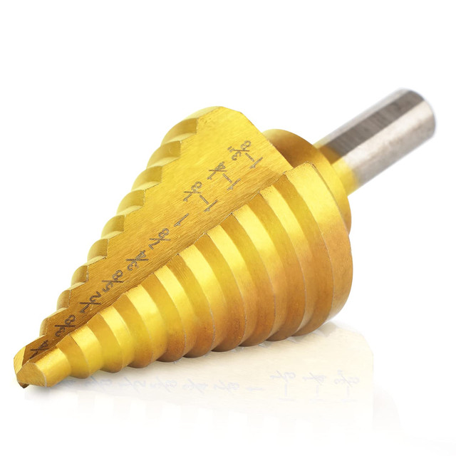

Just as before I had to take layers of Bondo off the center piece but got a little better and my wrist angles and pressure points. It went quickly until I encountered this. This guy might not have been the best painter but unfortunately for me he was very good welder.. He welded the 1P2P original start button holes I needed for my MVS CP..
I had to hammer SO hard with the scraper to slowly break through the solder. And even then he fused the weld to the sides of the holes. So ill have to come back with my titanium conical drill bit to finish the attached welds.
All in all I call this a success and like everything in this hobby took forever. My photo timestamps say 6:49 PM to 10:04 PM of non stop Bondo removal.

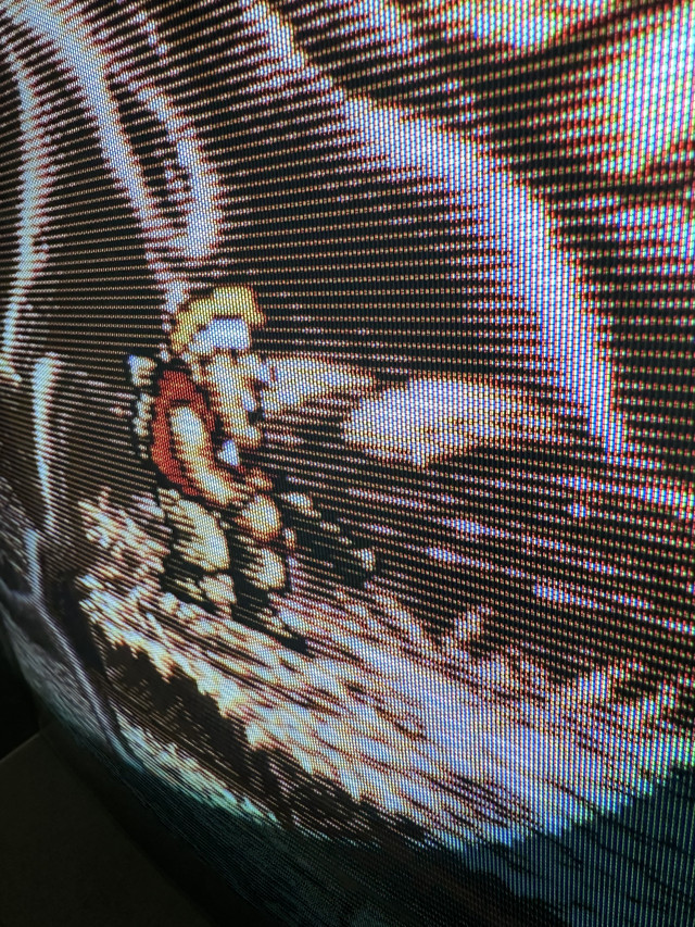

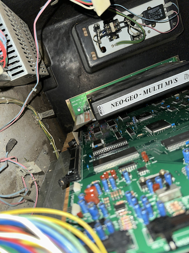

I decided to troubleshoot my Darksoft MVS as I had trouble on my Aero last time I used it. The volts were dialed in at 5.04 on the edge and I didn't have any issues with other PCB.
When I bought the MV1B. It came with terrible interference over audio and then the audio just quit at random and made weird chirpy noises instead of sounds and music.
I pulled the MV1B out of storage and noticed it had the UNIBIOS 3.3 I need to look into upgrading it and made a mental note.
I plugged it into my HAS as that gives the least issues compared to my cabs and powered it on to 5.04 V on my Megaview.
It looked gorgeous but the Audio didn't come back even after fiddling with the audio pot on the MV1B.
So I decided to take it out to my NAC, with is configured to MVS with its rather large NEO-MVH motherboard installed permanently with Puzzle Bobble 2. The game fired up and looked amazing as well on the Nanao MS9. Sounds checked out so I decided to fire up the Darksoft MVS.
It looked and SOUNDED perfect ruling out the Darksoft cart being the culprit and the Buzzy MV1B failing. I guess bigger is better as the NEO-MVH has never failed.
I plan on robbing the NEO-MVH from the NAC for the time being when the 5th Aero is finished but would love to hear your thoughts on the audio drop out on the MV1B and helpful insights about the UNIBIOS swap and upgrade.
