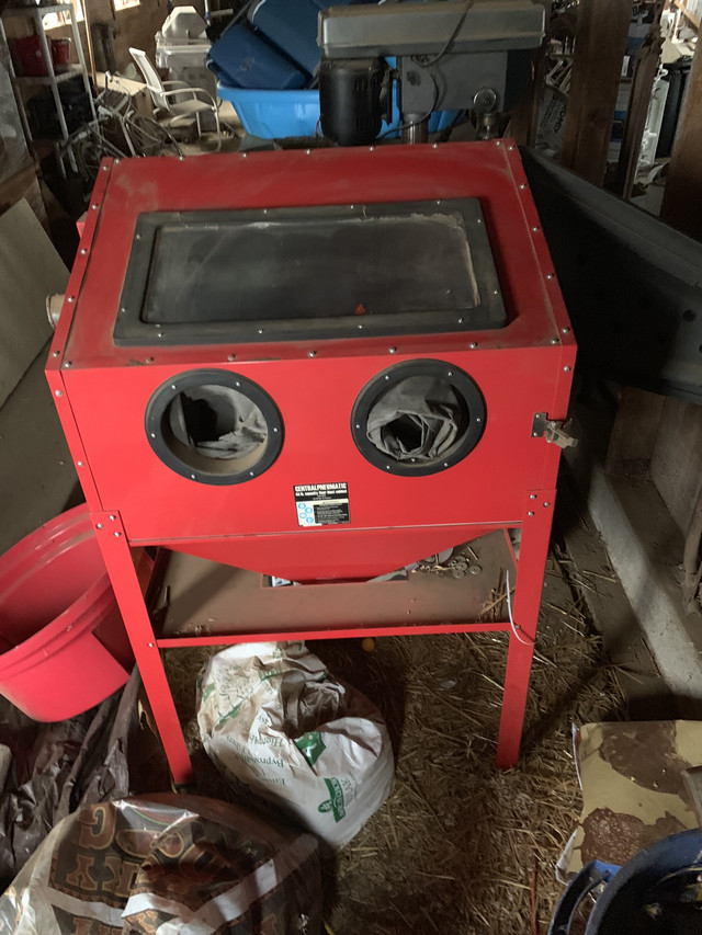

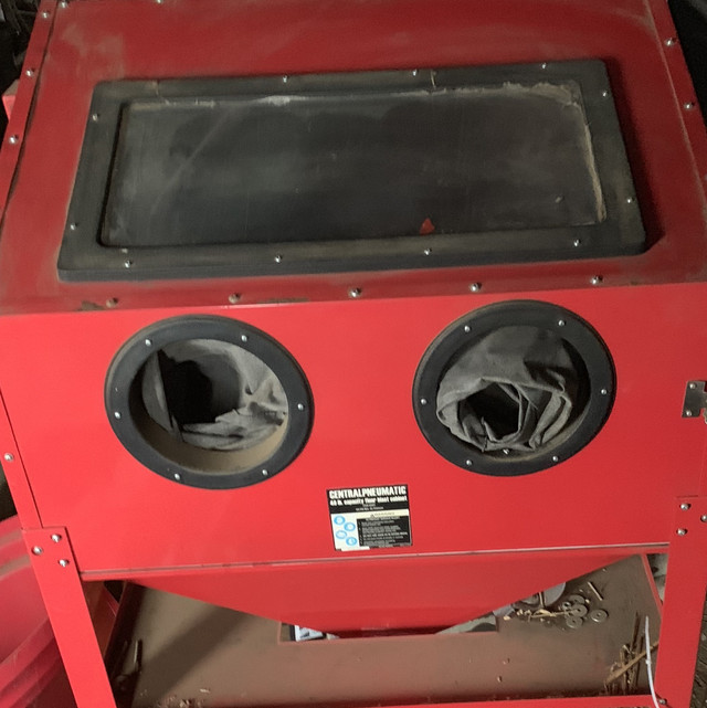

I'm surprised you haven't invested in a media blaster cabinet. I wonder if that would have helped. I'm tired from just thinking of all that work. Of course I am recovering from rotator cuff surgery :) I am enjoying reading the progress. Nice work! I am looking forward to the rest of the journey.
I do have one actually. The bondo would come off too slowly to use one. It would pit the metal If I used my "blast cab"

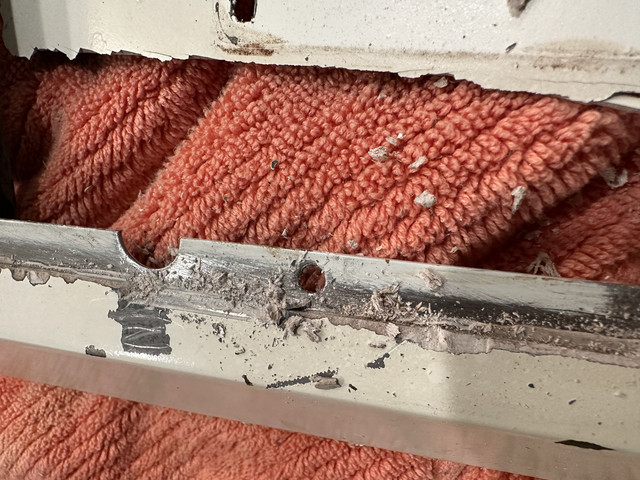

The Conical bit for the win! It ruined the bit but I was able to keep shaving the weld until the 24mm buttons cleared

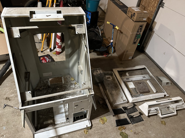

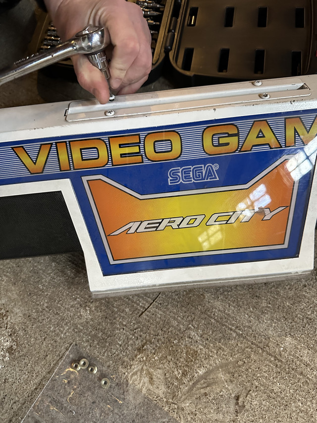

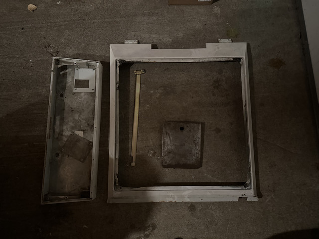

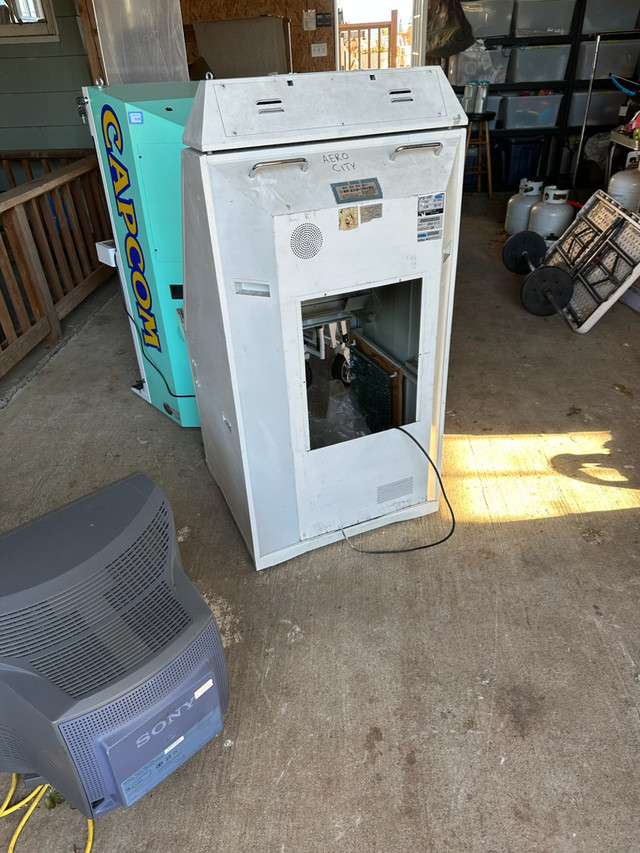

After dropping off the CP for powder coating, I figured I would drag home the 5th Aero cab and start prepping the pieces for powder coating before and after family visits during Thanksgiving
I wanted to focus on part labeling so I created a work "diary" to reference for reassembly.

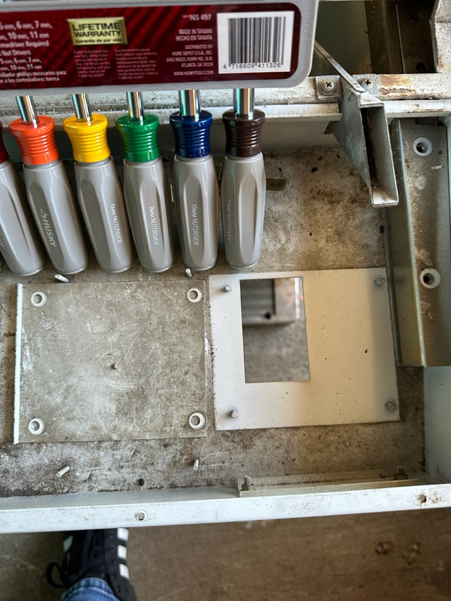

You will need a 7mm, and 8mm socket for the lower cp.

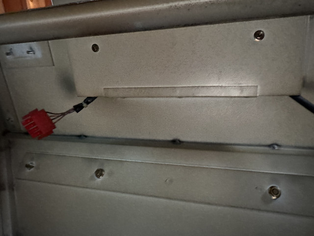

I was surprised by this plate and wondered what its purpose was?
I labeled my screw and part bags more accurately this time and even prepped for my headphone accessory repro I ordered
After many screws I managed to get the Lower CP disassembled and ready for the powder coater..

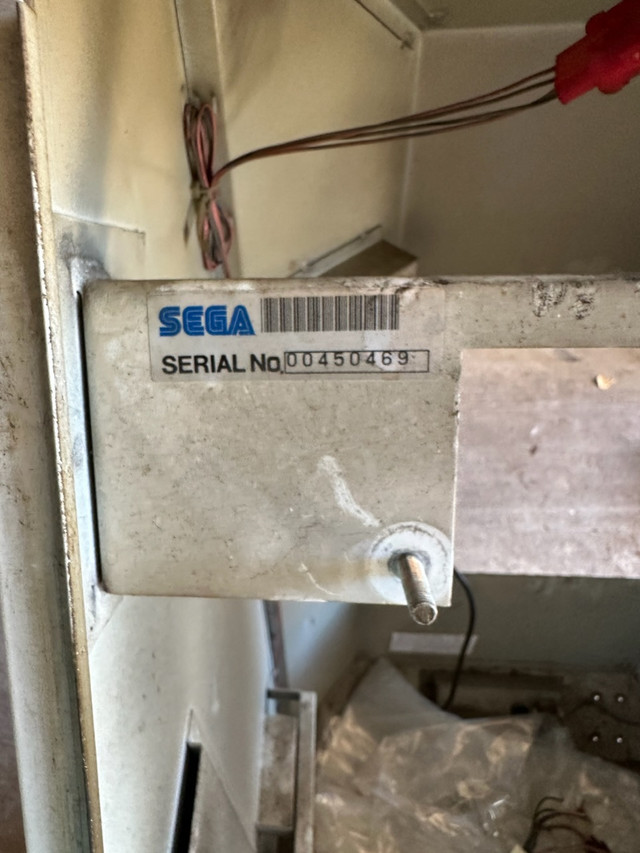

I wanted to track my sticker placements so I timestamped my photo in my journal to reflect sticker placement.
Sticker Placement:

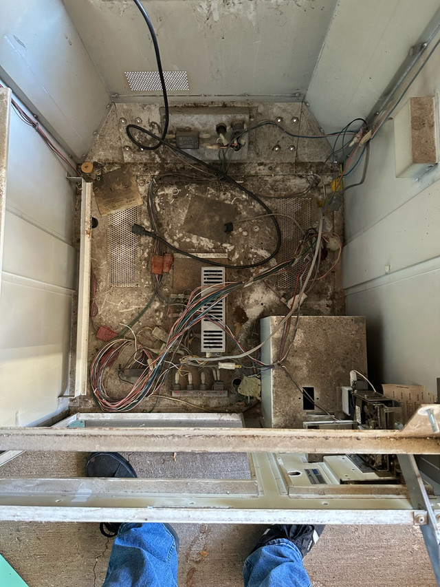

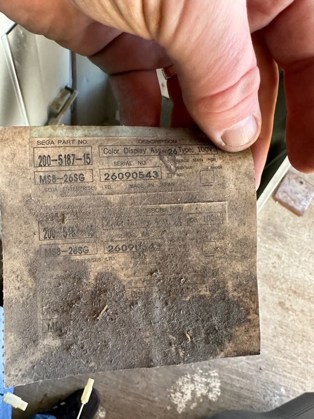

Looking into the dusty cab I found a key, the original monitor model label, and thankfully a rusty stripped bucket door panel. Ill be sure to slap the label back on the tube ..
I went to the hinged monitor cover assembly next and after using a giant socket wrench to remove a stuck bolt I felt I made some "some" progress in between thanksgiving socializing.
These pieces are off to the powder coaters!

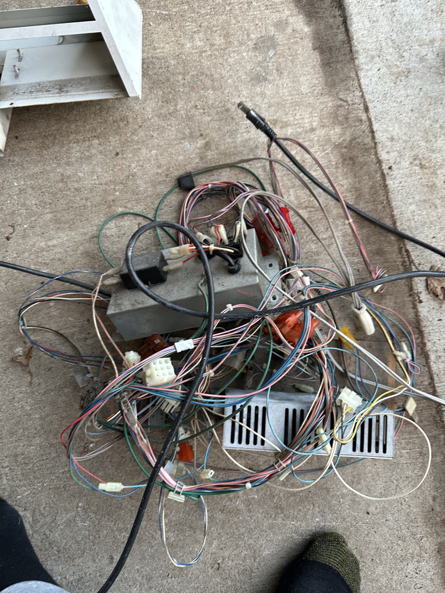

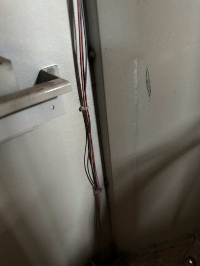

After they left I was able to squeeze in some more disassembly. I still had the Topper, Yen chute, Coin Mech, Footplates, wire harnesses, Power box, and PSU to remove.

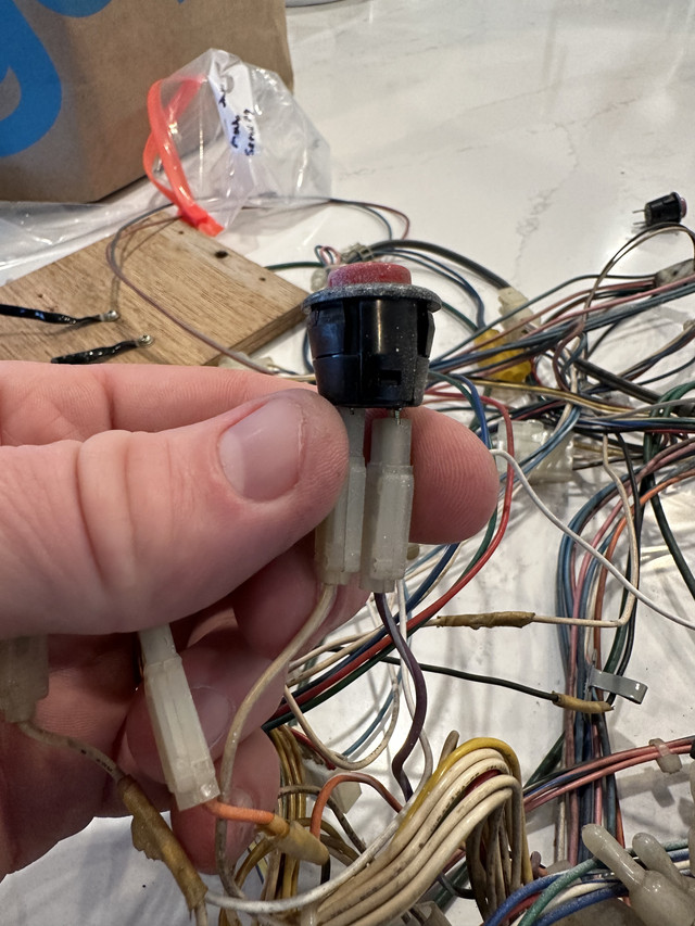

I took careful notice and timestamped the wire harness locations and ground loops this time.

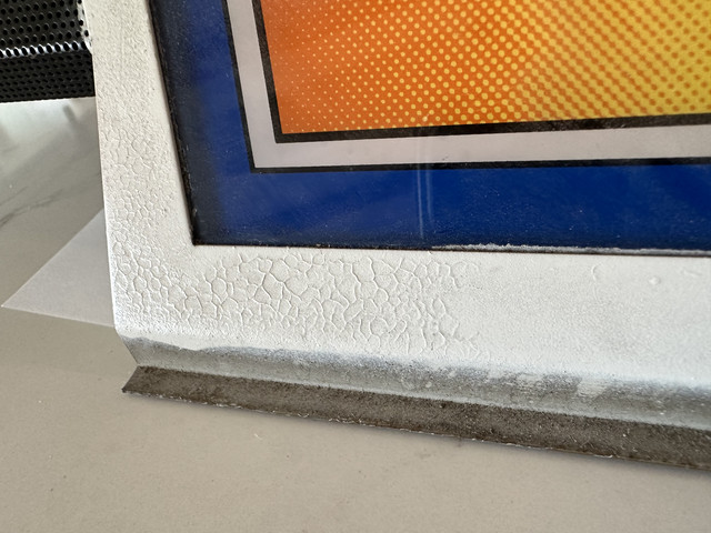

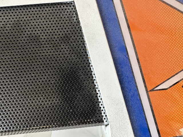

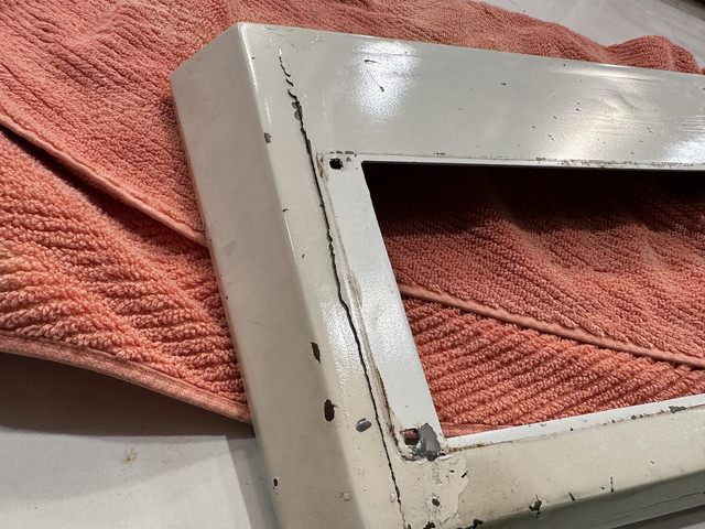

I started to disassemble the topper and noticed someone painted the front of it without masking it off.
There was a lot of missed paint including on the graphics plate.
Soap went a long way and turned the transmissive film color from brown back to white with a wipe. It was a rewarding experience seeing the graphics come back to life. I had to scrub precisely and use my fingernails to remove the white paint from the graphics without scratching or fading it.
It turned out "almost new"
But with a cotton cloth application of White Lithium Grease, I believe it looks factory and gleens to a point where you just wanna sip Cognac and stare at it for enjoyment.

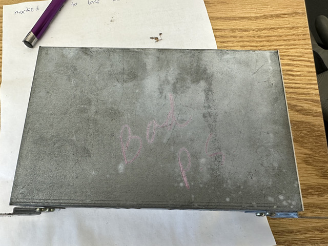

I had to go into the office today so I thought I would bring the wires and PSU with me to finish some touches I wanted this time around.
I planned on removing the PSU board and cleaning the wiring of its smoky cancer dust..

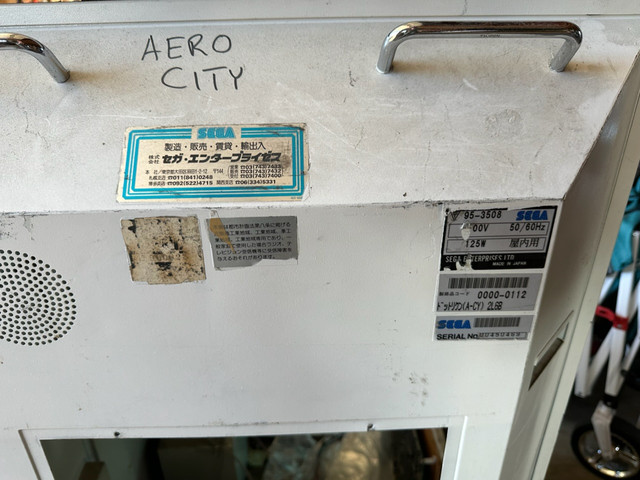

I was welcomed by a message from its previous owner BAD PS
Thankfully I have tested this and the rails are great and even recapped the monitor a year ago so I don't have to go down this hellhole "Yet".

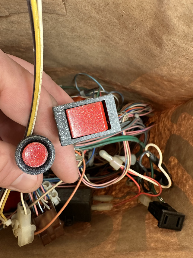

I decided to to touch up the cold rolled steel PSU cover and Power block.
I took careful diary notes of wires harnesses and sticker placements for later.

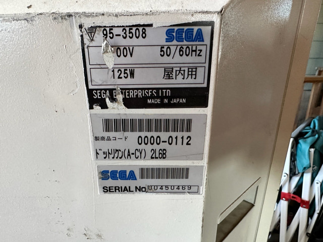

I want to recreate the PSU Sega label for the final unit so I took a pic of the original sticker JIC

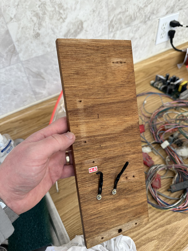

I then began to disassemble the PSU cover and wood block.
Before:
After:
(I may varnish and lacquer so I left it unpopulated for the time being)
Here are the new parts for the powder coater:

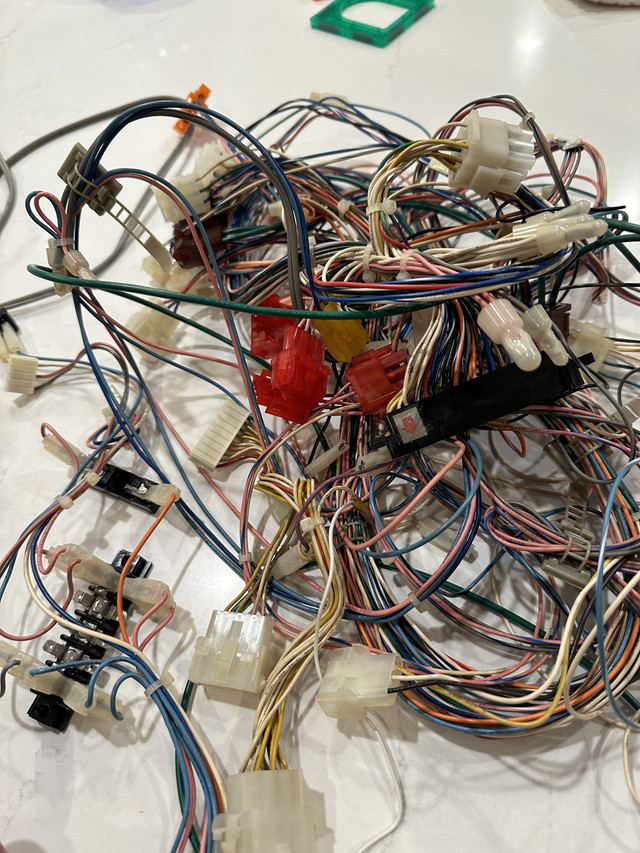

I decided to take on the rest of the wires and fittings did the same.
The connectors and wires looked so much better after the effort
Before:
After:

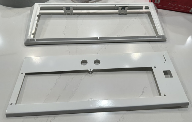

I love this time of year.. And by that I mean any time of year something you powder coated is ready to be picked up..
He's busy AF and just got a Industrial compound Gate contract so Not everything was finished but most of the white. Ill be looking forward to the Jet black and silver pieces hopefully byt he end of the week.
But blah blah blah heres some fresh white. Take it in...
Before:
After:
That Control Panel housing especially warms my heart. Thanks again @andynumbers , and @Hakkyokuken for making this panel exist.
Now time to reassemble what I have to get ready for the final powder batch..
