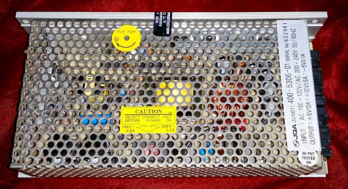

Hi there, I am trying to make the PSU of Korean House of the Dead 1 "upright" cabinet work, it almost works, model 400-5306CE-01, exactly like the one from this image:

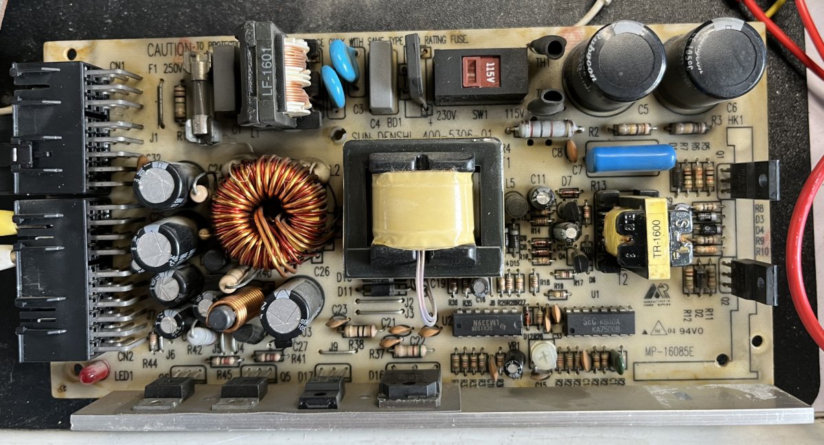

So I decided to replace the KA7500B with the one from another unit that is in much worse condition, took it out, installed socket and tested, same issue.
Measured all nearby diodes, resistors, Q1, Q2 transistors, capacitors, all good (in circuit).
Here's a picture of it (before installing the socket).

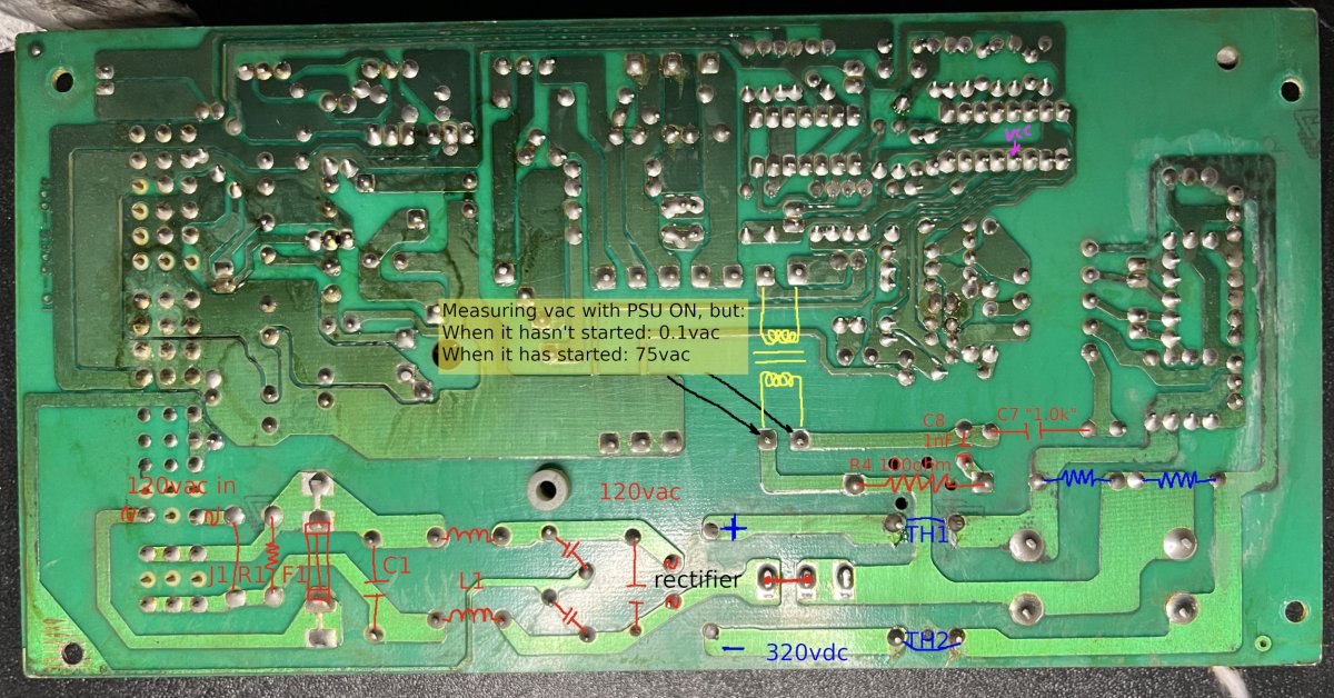

I wonder what would diagnosis be to research more about it, startup circuit failure? Here are some measurements and their location:
