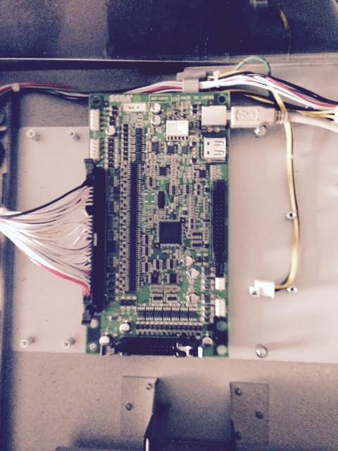

Guys - I have a sega JVS I/O version 3 that I would like to connect to a Vewlix to be used with a RingEdge 2.. Where does this yellow cable goes? It is label P1
On a Taito JVS board the yellow cable goes to P1 which I think is power.

That conector is +5V power and goes to CN7 or CN8 any of them is ok.
RingEdge2 games will work only with Sega type 3 JVS I/O board.
Yes, both conectors are the same, no matter what the manual says
I tried the Sega JVS but I do not seem to get joystick or buttons input on the X2 or Naomi..Maybe the way that the controllers are wire? The Naomi does not complain about not seeing the i/o but the Joy, nor the buttons work, same with X2.. The RingEdge 2, I do not current have a game to test.
How did you connect your wiring?
Vewlix harness does not match Sega harness, most pins are for a different function
I used the original wire, harness that came with the Vewlix.. there are two small claps from the wiring harness that I shave (specific to the Taito I/O) off so it could go into the Sega I/O. I need a Sega wiring harness cables?
yes some cables are switch around. there is a board taito made for it. but normally dont go cheap on yaj which is silly because its just a passive pcb that changes the pin out.

Look at the pinouts from the Taito manual and compare that to the Sega overview.
Most controls are moved 1 pin, but all service/test/coin are in a completely different position.

Just connected the P1 to cn7, the i/o board started to smoke. Shit that didnt work
because taito io uses 12v and the sega uses 5v, hence why you saw the magic smoke. You need to tap 5v power elsewhere or use a 12v to 5v converter.
