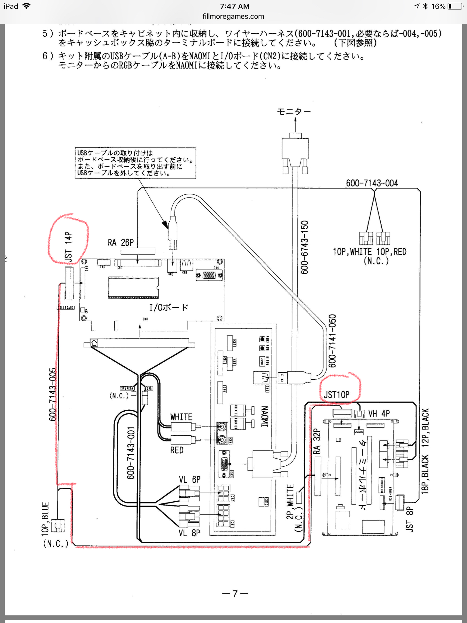

With the Sega JVS to Jamma I/O, has anyone been able to output buttons 1-3 on Jamma and 4-6 over the kick harness?
And specifically for people using the Sega I/O with their Blast City, can you really transmit kick buttons through CN6? Looking at Arcade Otaku it appears the the Aux/Kick AMP UP connector is only connected to CN8.

Looking at the manual I thought it would be perfect. But based some discussions online it appears buttons 1-5 must be output through Jamma.
I’m actually still waiting for the Sega I/O to come in the mail, so it will take a little time before I will be able to trouble shoot this, but I’m hopeful that someone has run into this problem before.
http://www.fillmoregames.com/pdf/sega_420-6457.pdf

Finally received the Sega JVS to Jamma converter yesterday, and spent some time trying any configuration I could think of.

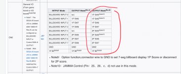

Sadly I couldn’t send buttons 4 and 5 through CN3 on the JVS to Jamma board. And I can only assume that the instruction manual for the Rev B board are incorrect.
I also confirmed that the CN6 pin out on the Blast City is incorrect. I couldn’t send 4, 5 or 6 buttons through CN6. I even tried changing the “function” of the input by jumping pins 9 and 10 as described in Note9 but it didn’t change anything for button inputs.
So even if you perfectly recreate the setup as described in the JVS to Jamma I/O manual (https://wiki.arcadeotaku.com/images/9/97/SEGA_cabinet_JVS_conversion_manual_.pdf) buttons 1-5 for players 1 and 2 must be sent through Jamma.
