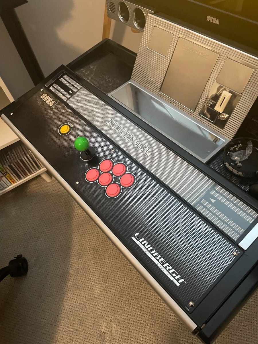

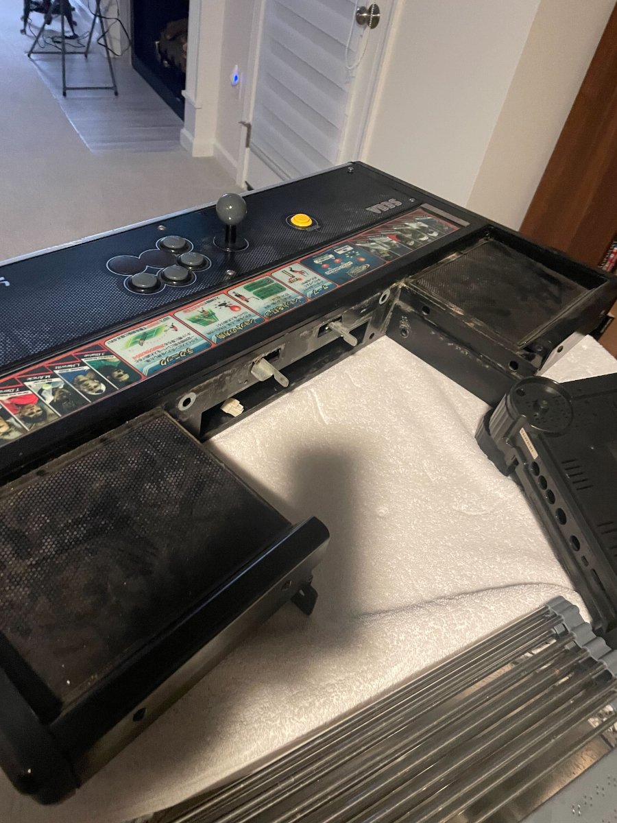

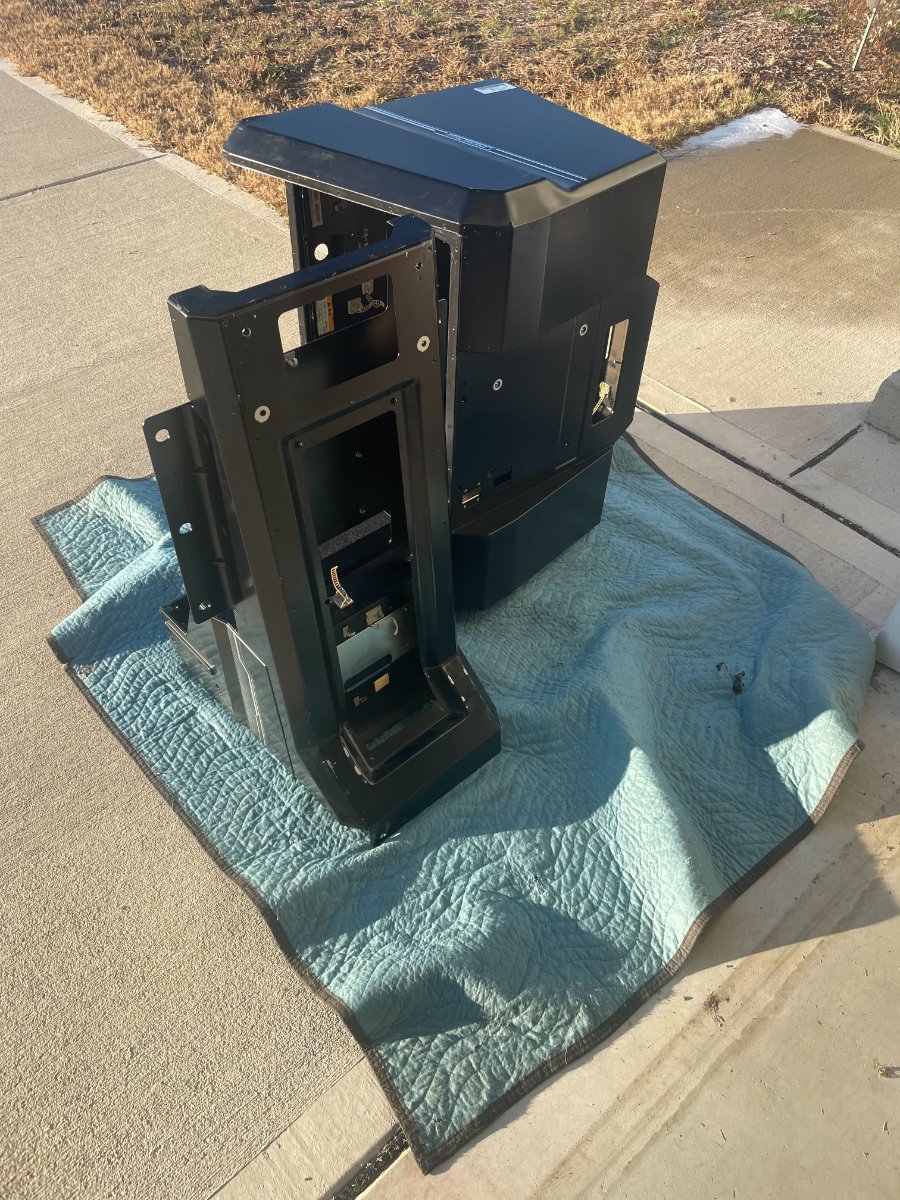

Recently picked up a Sega Lindbergh and Sega New Net City, this is my first arcade cabinet and restoration on an arcade cabinet. My goal is to upgrade the screen to 32in 4k OLED, brooks fight board and ps5/ pc support and all lighting upgraded to LED. The cabinet arrived was in semi rough shape, dirt and cigarette ash on the interior, scratches on the exterior. It's pretty amazing to take this apart and find a story being told within the cabinet. A lot of cleaning and parts to be taking apart.

Polishing parts. Decided to go with the Sega astro city button color theme instead of the Lindbergh gray

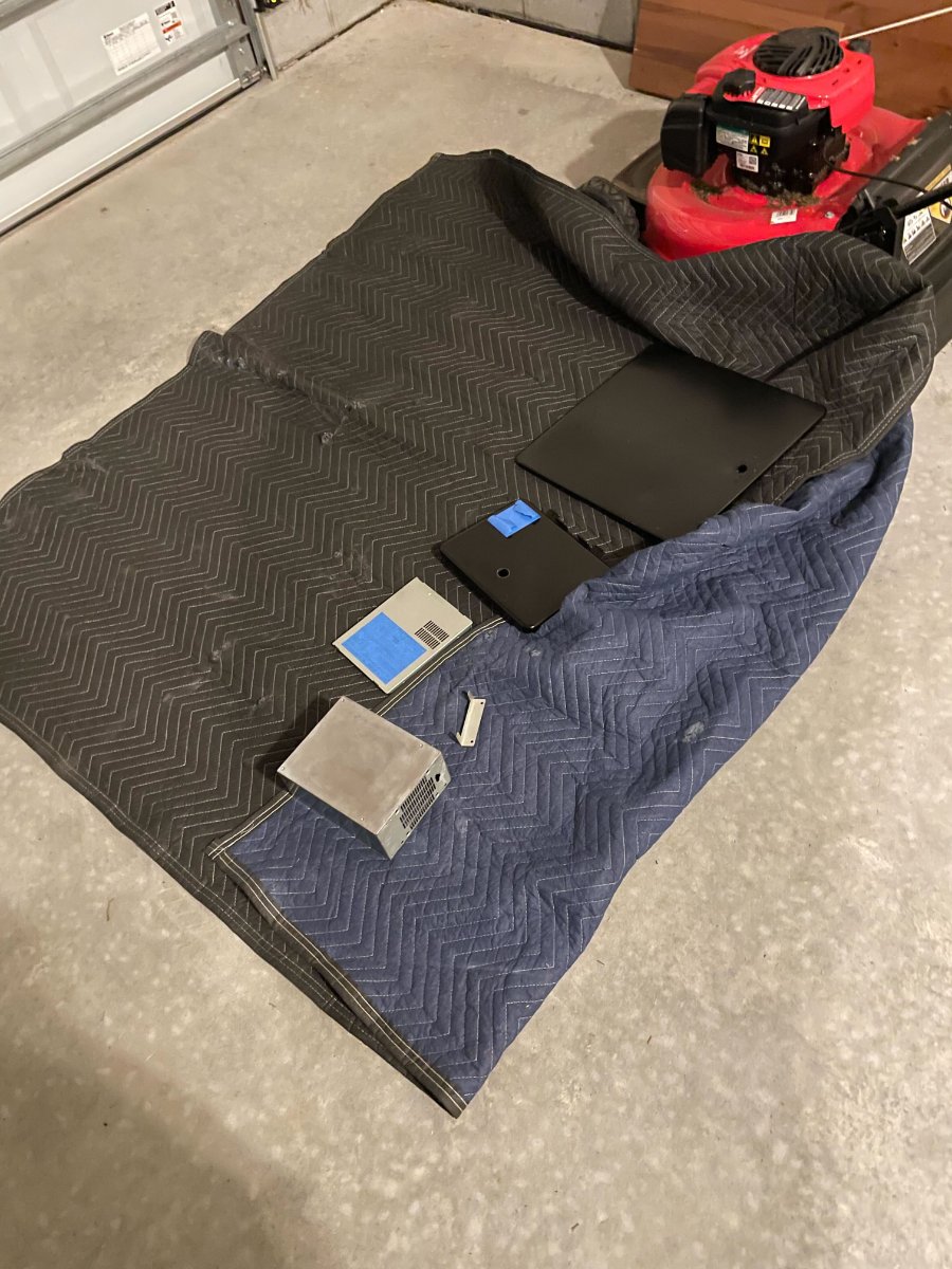

Prepping for painting and cleaning. Speakers needed a deep clean along with entire body. The wrist bar had deep scratches from watches, I couldn't polish this, so I needed to add metal bondo and sanding.

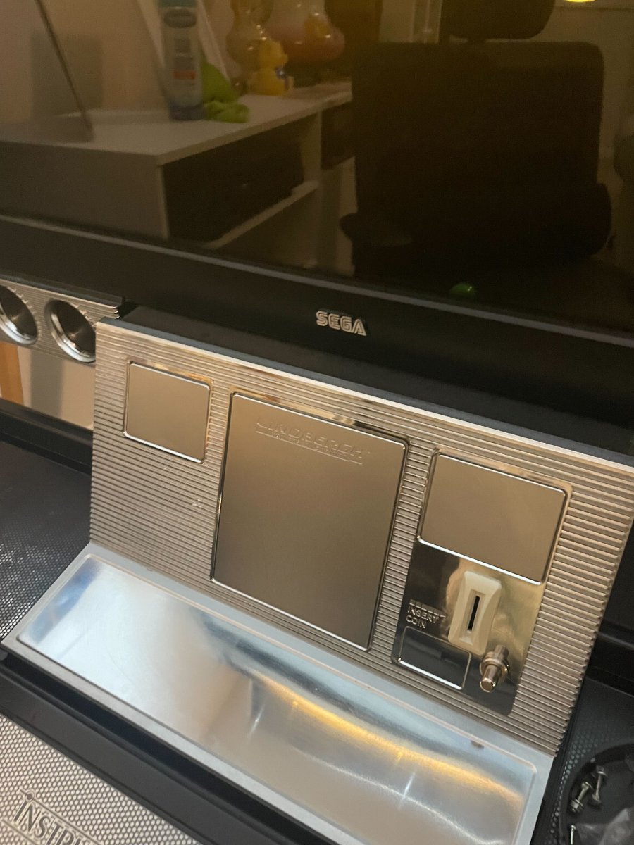

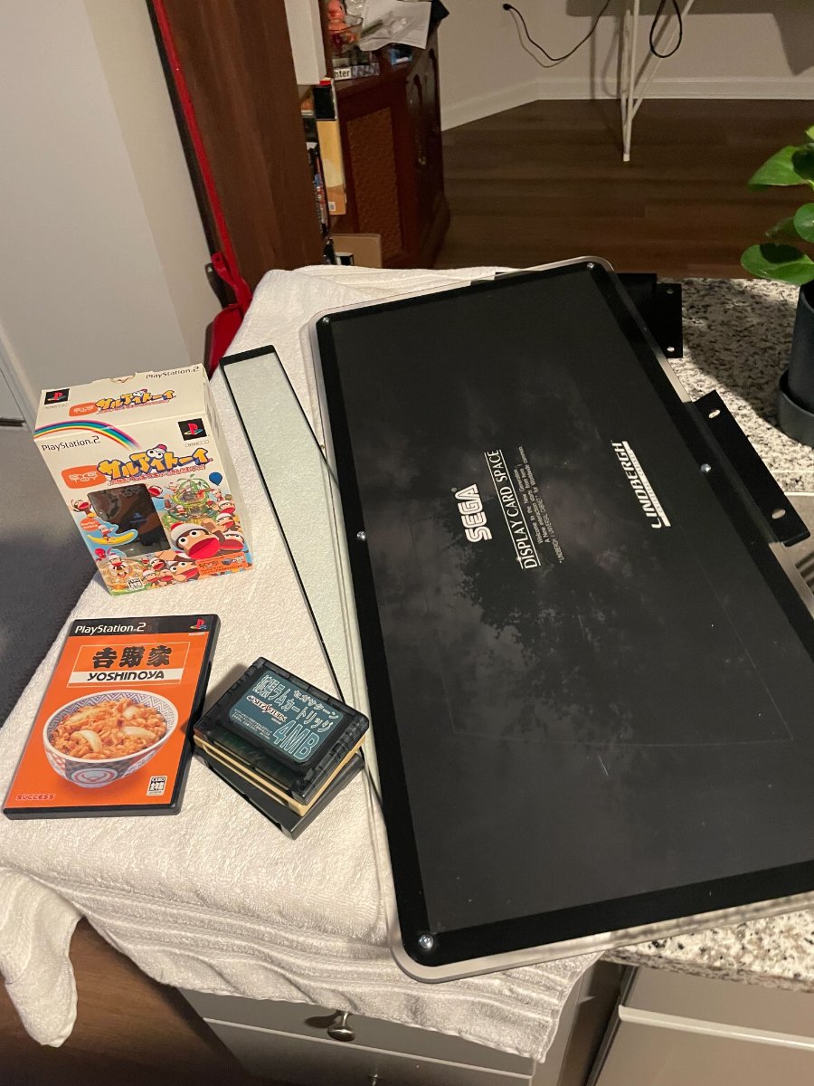

Pulled out the 1080p Toshiba monitor. Replacing glass with full clear glass, no need for anti reflective glass when i am upgrading the monitor to HDR. Top banner fully added.

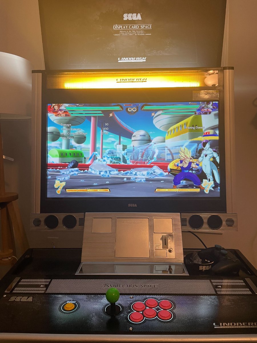

Went to a glass maker to change out the non reflective glass to clear. He only charged me 50$ which was half of what I was quoted online and other local shops near me. I upgraded the monitor from the original Toshiba 32in led to a Acer 4k OLED predator. Audio was upgraded to a Fosi Hifi 2 channel amp. I have the HDMI routed to an analog to hdmi controller that supports 2.1 and 4k 120hz. Upgraded the lights to 6500k 24in led t8, no more fluorescent light. Almost finished. Just waiting on a new top banner from yahoo auctions Japan and new instructions cards from the UK. I’m going to keep the artwork basic Sega Lindbergh for the time being.

Last touches to the Lindbergh and it’s done. Instructional space came in from Olly over at Arcade art shop! The top card has been updated to the OEM card which I found on yahoo auctions Japan (Shipping was not cheap) and the final touch: Sega emblem for the monitor bezel. Updated the brooks board firmware for the ps5. Now I’m moving on to the Sega new net city next!

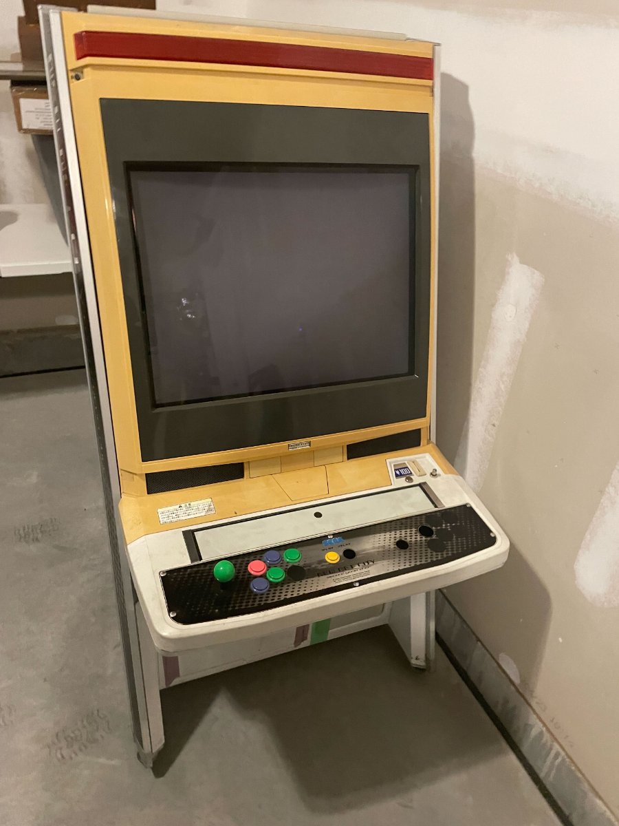

Its going to take a lot of Peroxide to retrobrite this front panel on the Sega new net city. I think I'm just going to have this painted using a spray gun. I will need to tear everything down and prep it with sanding, bondo for cracks and primer. This cab I am going to keep 100% original using a naomi 2 pi setup and cps2 jamma hook up. Need to order caps for power supply and crt

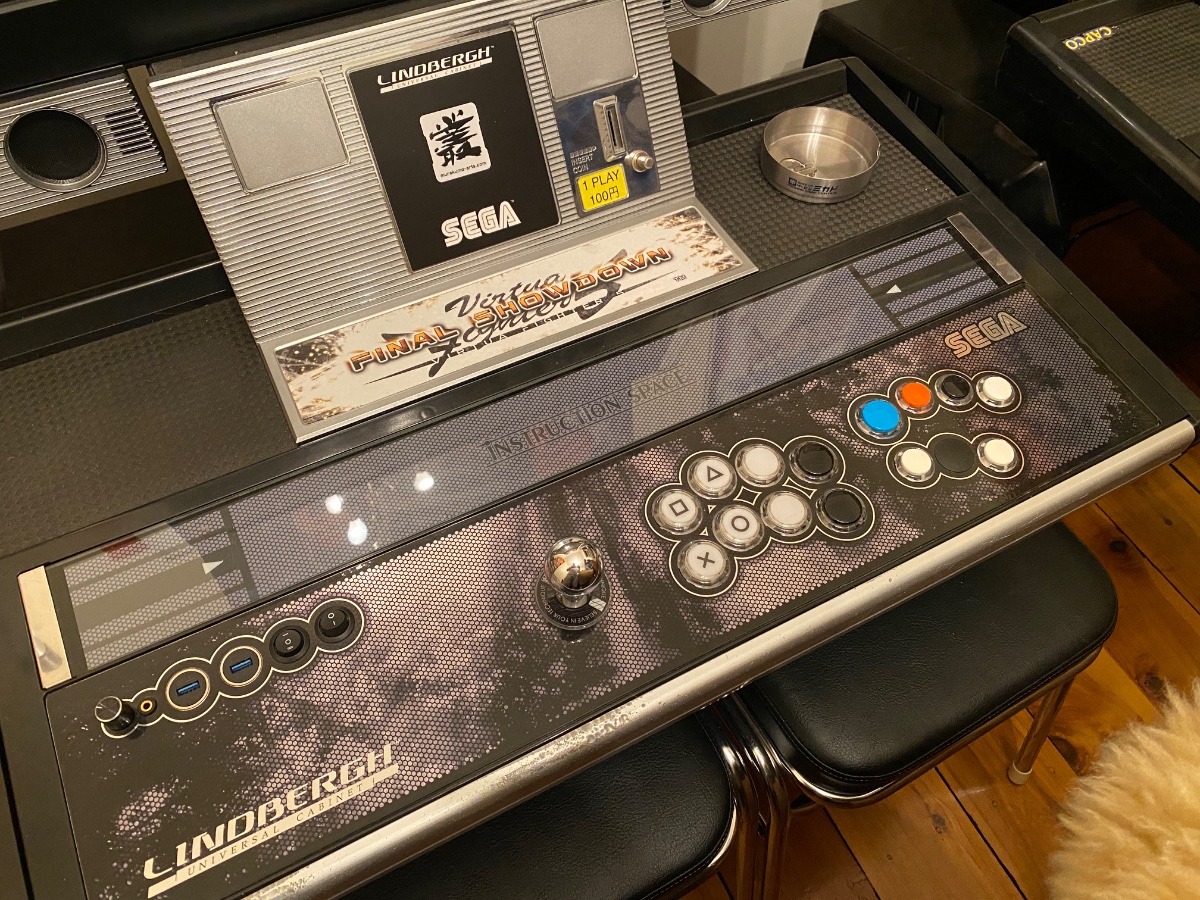

If you ever wanted to be bothered setting up a panel to support the Brook features and PS buttons here’s a pic of what it did on one of mine by sacrificing a Noir clone panel.
