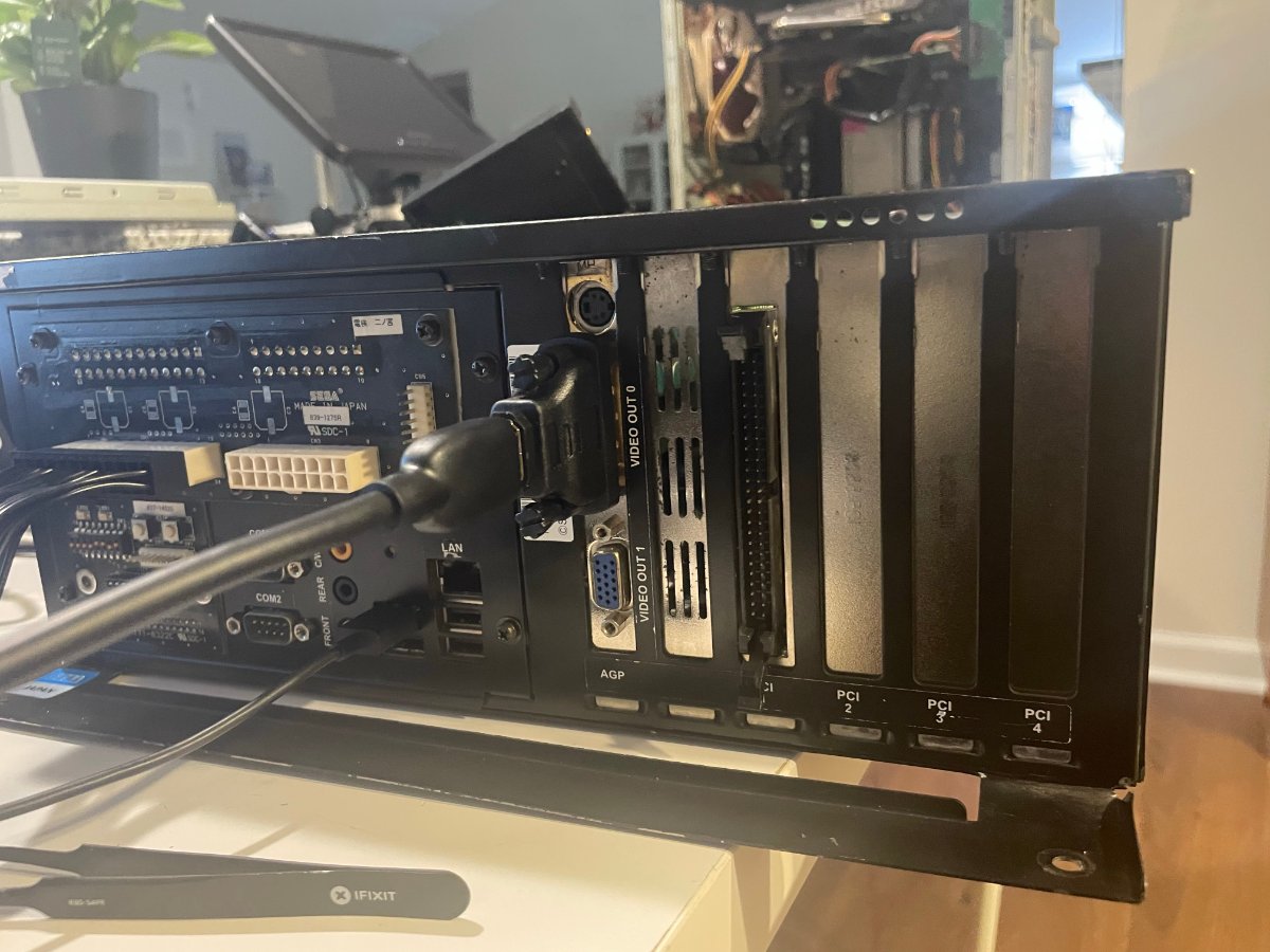

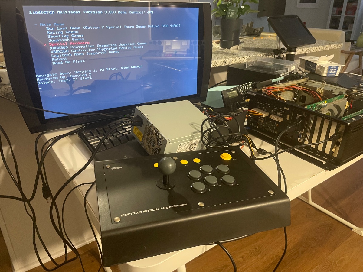

I finally have the Lindbergh yellow to boot into the correct menu due to missing "os.001-os.004" on the ssd. Before the system would boot to "Multi" screen for 4 seconds reboot then loop back
Now I get this message ".menu.sh line 243 and 256 too many arguments" when the menu is loaded. This message will flood the screen
Bios has security Disabled
CF boots correct to Mutliboot

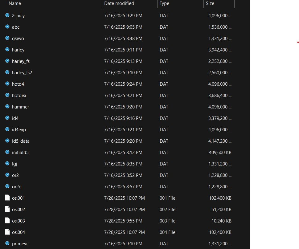

SSD is formatted to Fat32 MBR using formater32
Key has been updated to multi.bin
one issue I did have was the os.001 was a "winrar" file. So i uninstalled winrar and redownloaded the os.001.
Do the OS files need to be placed in a folder?

one thing is my Lindbergh yellow does not have JVS or audio card just the I/O
