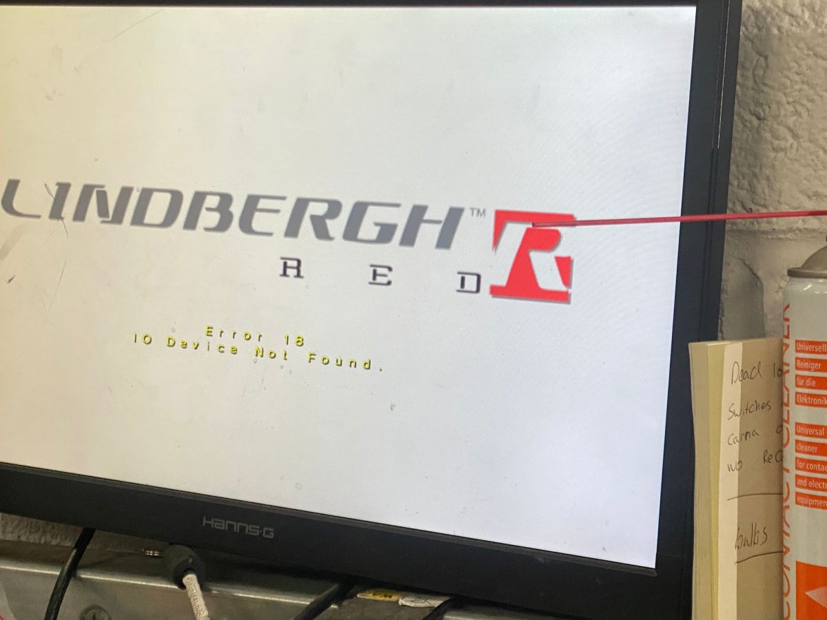

I've got an issue with a lindbergh red ex (for a Rambo) it keeps giving me "Error 18 I/O device not found" and i cant find out what that Error means anywhere.
I've swapped the the I/O card to different PCI slots to see if that help and swapped the I/O card to a known working working one but still the same. anyone got any ideas?

That error is related to the JVS I/O. Error 18 is incorrect baseboard. Which one are you using?
If it's the right one, then it's most probably a problem with the JVS itself. Those things break just looking at them.
How do i know which baseboard i have? I have one without the little cap next to the battery holder and one with a little cap next to the battery.
And I'll add that one has 2004 as the year stamp and the other has 2007 for the year.
But if error 18 is incorrect baseboard, then removing the baseboard entirely still gives me error 18?
If the JVS is dead, or not responding to the CPU, then it's the same, isn't it?
