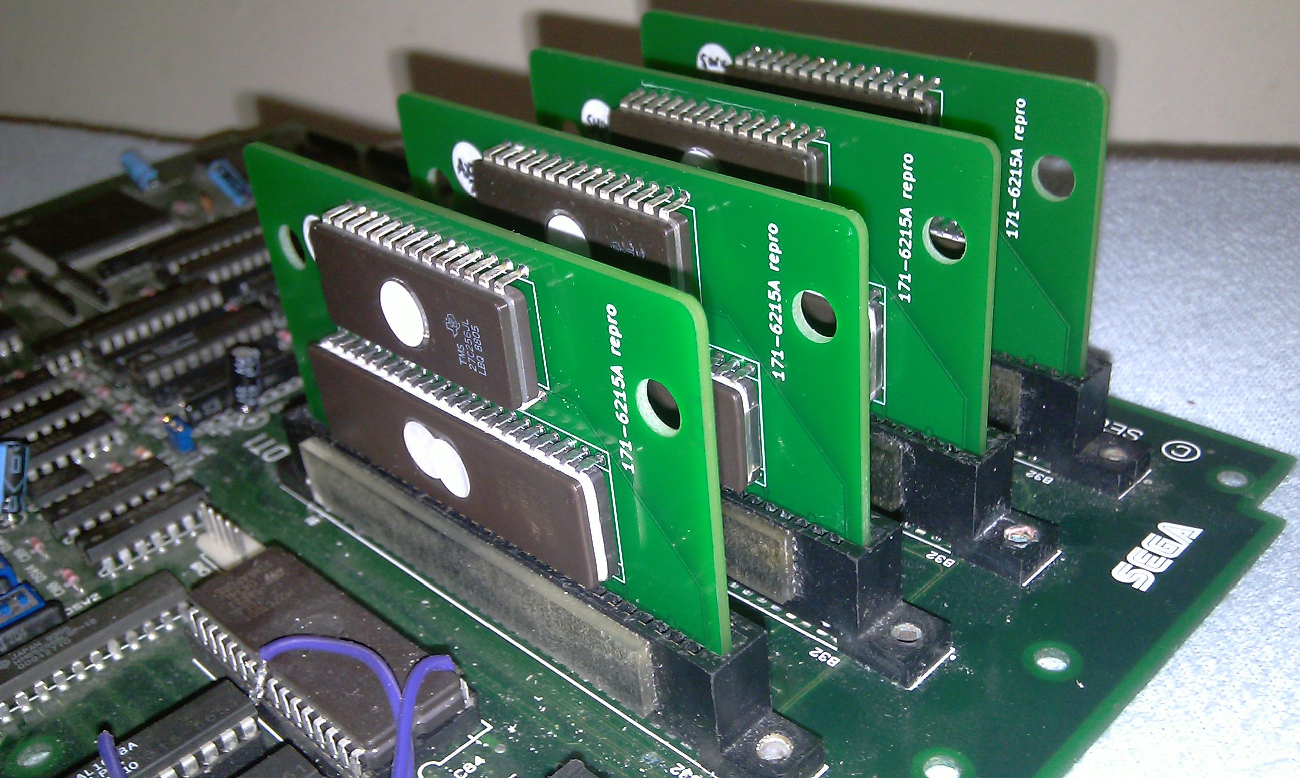

Another project that arrived was some sega megaplay repro's.
They look great and run well!
If anyone needs any contact myself or @caius and we can add to the next order of blanks.
Hopefully we can get some standard MD games running but the menu system on this H/w is very strange!
It's an extra z80 with it's own gfx layer . it's i/o multiplexing controls the cart slots and all the system controls/dips. <and starts / resets the MD chipset>
Apocalypse has it mostly sorted . I need to populate one of these blanks with a standard MD rom + test with apocalypse bios.
'retail' MD games (PCB) have a slightly different pinout so system does not detect them at all.
