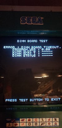

So this is my NetDimm board that was at 4.02 firmware when I purchased it. I checked and confirmed that before I did anything. So this looks like it was bricked then. So my question what did I do to brick it?

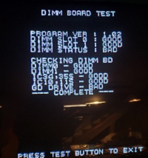

Here is a picture of my Dimm board and it reads 1.02 firmware but says Gdrom is bad. So this definitely confirms the theory of my NetDimm being bricked I guess.
