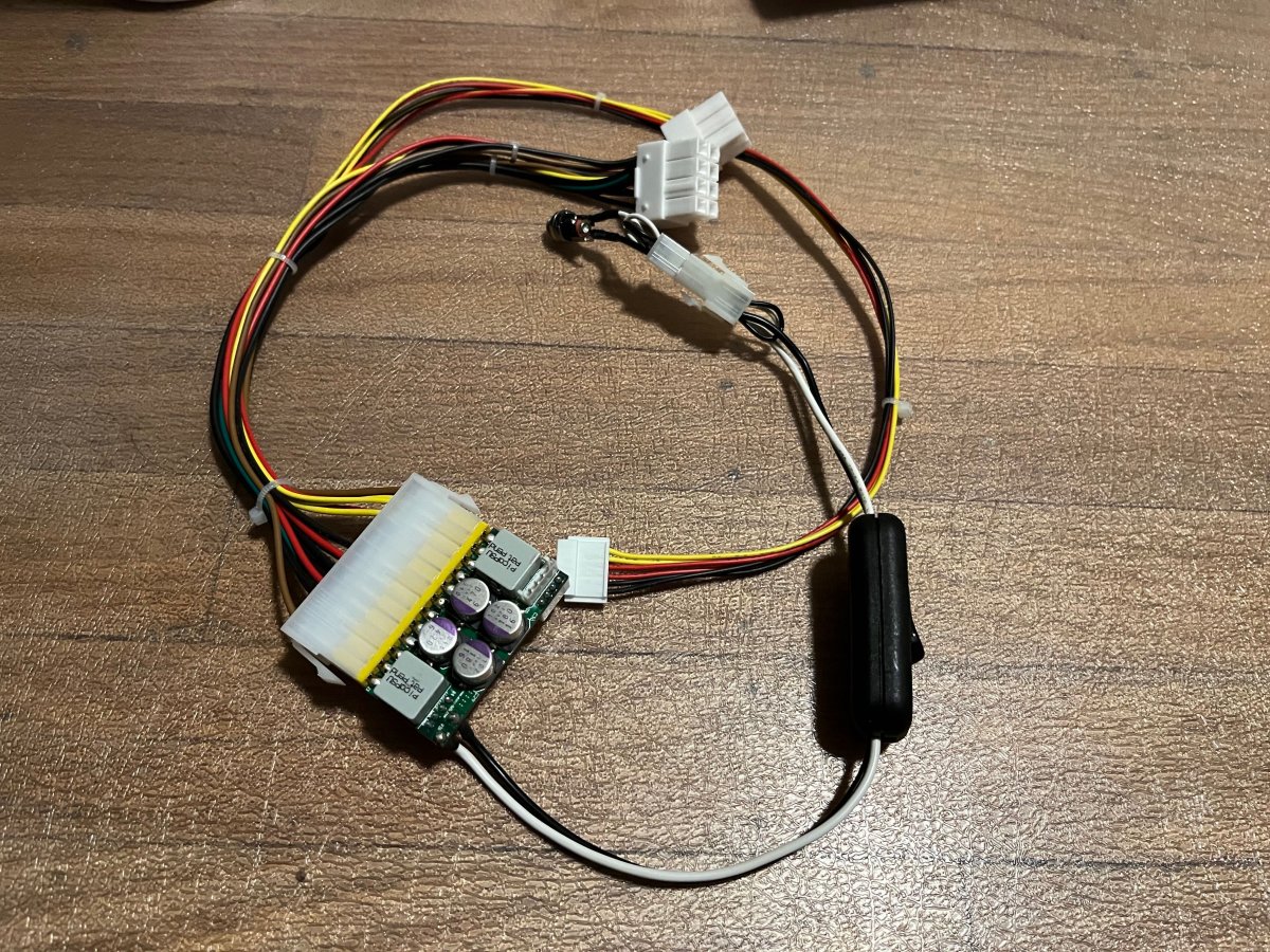

That is really what started me down this path of replacing the Wei-ya PSU. I could get good enough 5V regulation to run most JAMMA games, but it would not supply stable 3.3V via the JVS power connectors to run a NAOMI netboot setup. I didn't want to get a step down and bother with all that so I just replaced the PSU and made the plug and play adapter.

Bit late to the conversation, sounds like you have a solution. But I went pico-atx awhile back. Just needs a good 12v and everything works great. Very convenient when working on my bench setup.
