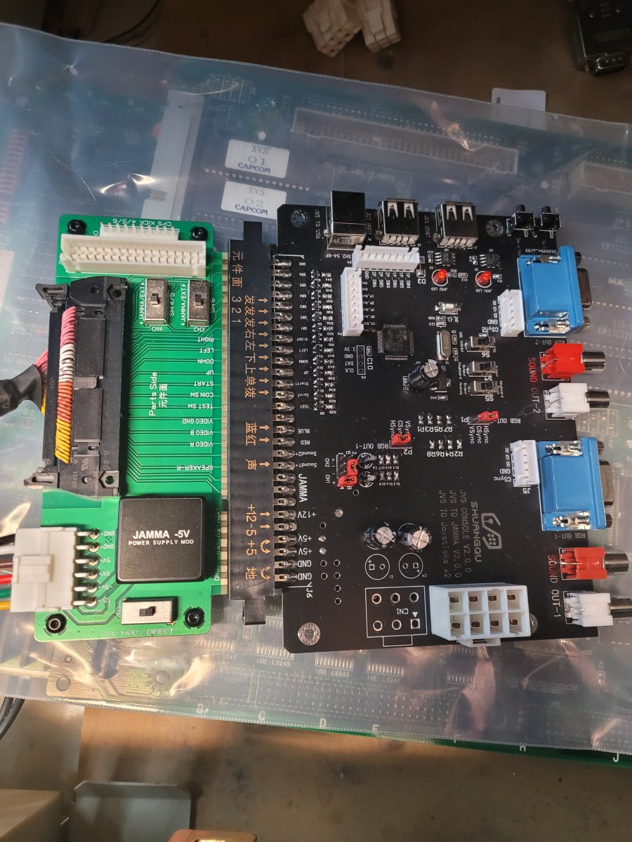

Hello All, Can someone identify the two harness cables in the gray sleeves in the image please? I want to believe they are kick harnesses that connect to the i/o but want to make sure. I'm setting up a jamma to jvs converter and it appears that one of those should be connected to my extension harness. Currently, my kick buttons as well as P1 button 3 is not responding.
I think I saw somewhere that those are the maple bus connectors for a Naomi , possibly used for the vmu. The ends are sitting in the middle of the control panel?
Thanks @hrvat9. I'll look that up. In the meantime, I'll try playing with the kick harness that was supplied with my jamma extension. The closest info I can find online sis from axunworks which looks almost identical to the aliexpress one I purchased.
