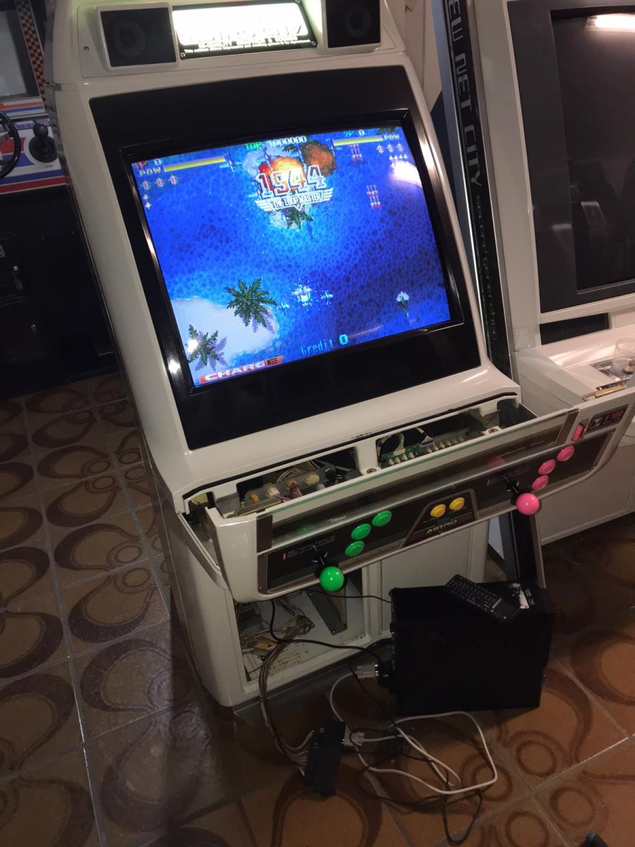

Stereo Mod for Sega New Astro!

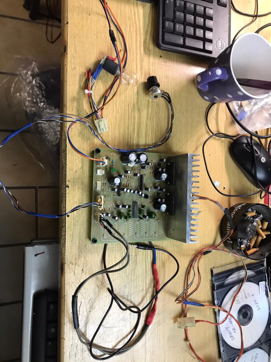

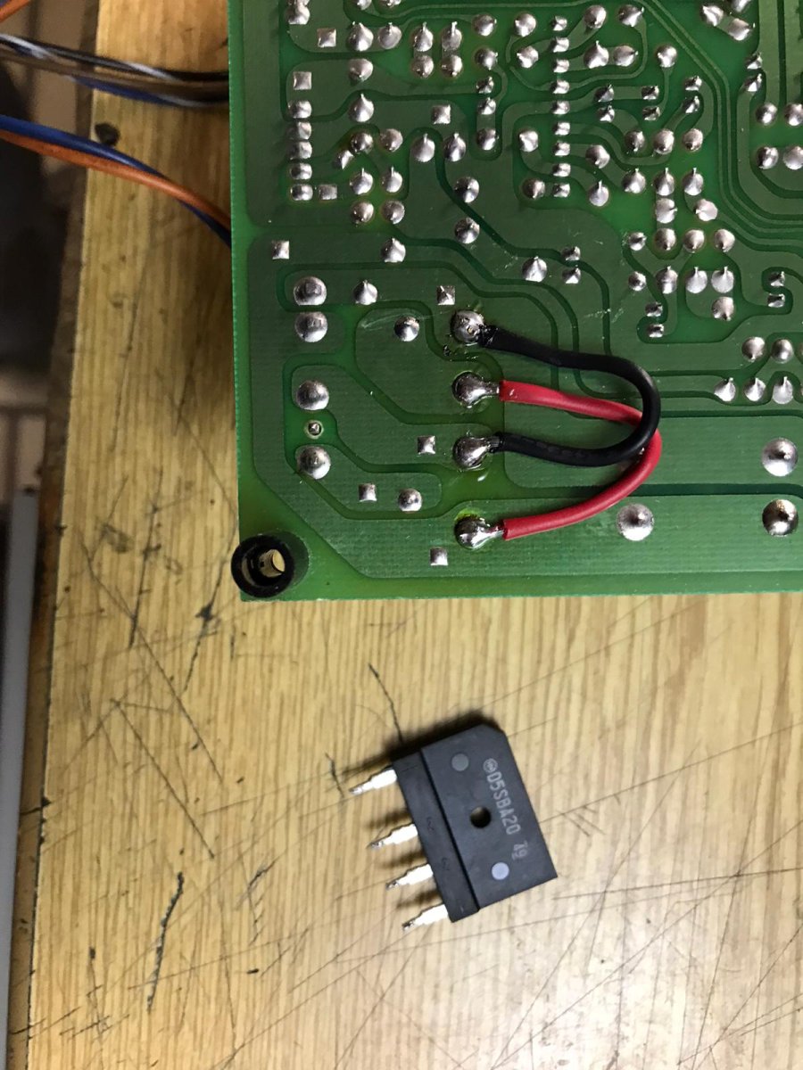

Uses a sound AMP from a scudrace working with a 12 volt AC mod at 12 volt DC away from the rectifier sound is good with original speakers
Pictures runs with dell Optiplex 7020 and hd 5450 GroovyArcade Mame
