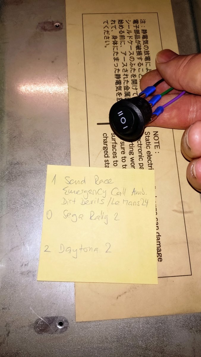

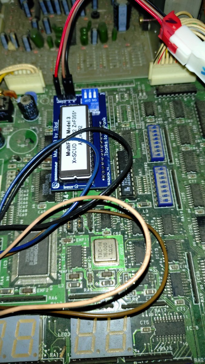

If you plan to switch the games sometimes I can recommend you the MultiFFB from Tibal so you won't have to change the rom on the drive board.

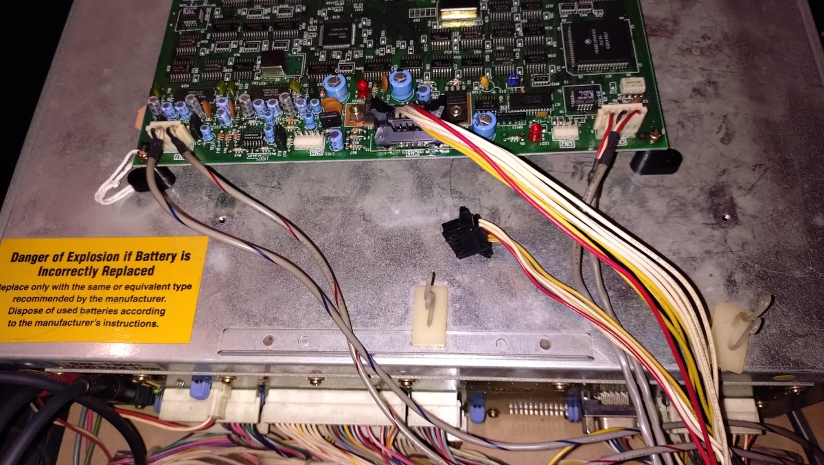

That's actually a great point. Daytona 2 already has the DSB2, Emergency Call Ambulance does not.

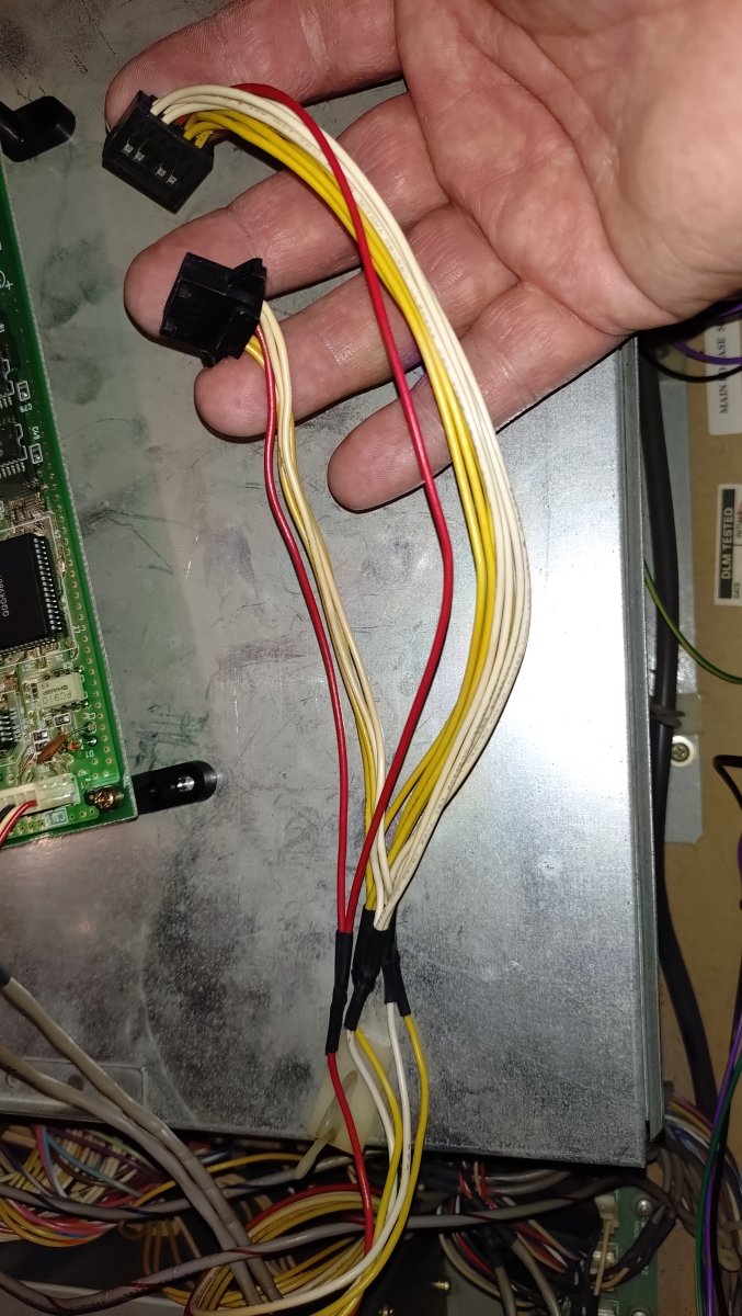

If I remember correctly the DSB1 and the DSB2 boards use different plugs for power but with same pinout. May need to build an adapter there.
I am doing the same on a Scud Race twin to play various Model 3 racers (bought it from a friend like that). Can do some pictures later of what was done if interested.

All this is basically the same in order to play Scud Race/Super GT - although it uses the older DSB1 board for music, you can use the DSB2 filter board to connect the DSB1 board.
