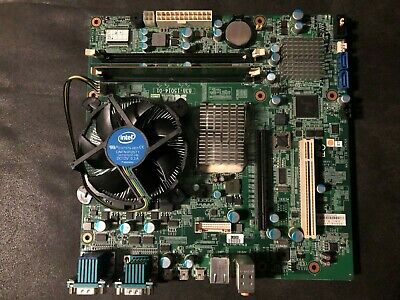

Hi, very long time since I've been on the forums, just managed to win a Buyee auction for a Ringedge board with a few spares.
So on to my query, just wondered what the exact differences are between the 2, I'm aware the CPIU, GPU etc are different but what else? Tried to find some information and the motherboard seem's to be the same, same RAM type/speed etc.
I'm guessing it's a firmware/bios difference between the 2 if the motherboards are in fact the same?
Ram is different ddr2 vs ddr3
Re2 has more sata ports, lga1156 socket. RE1 is lga775.
Totally different mobo's
