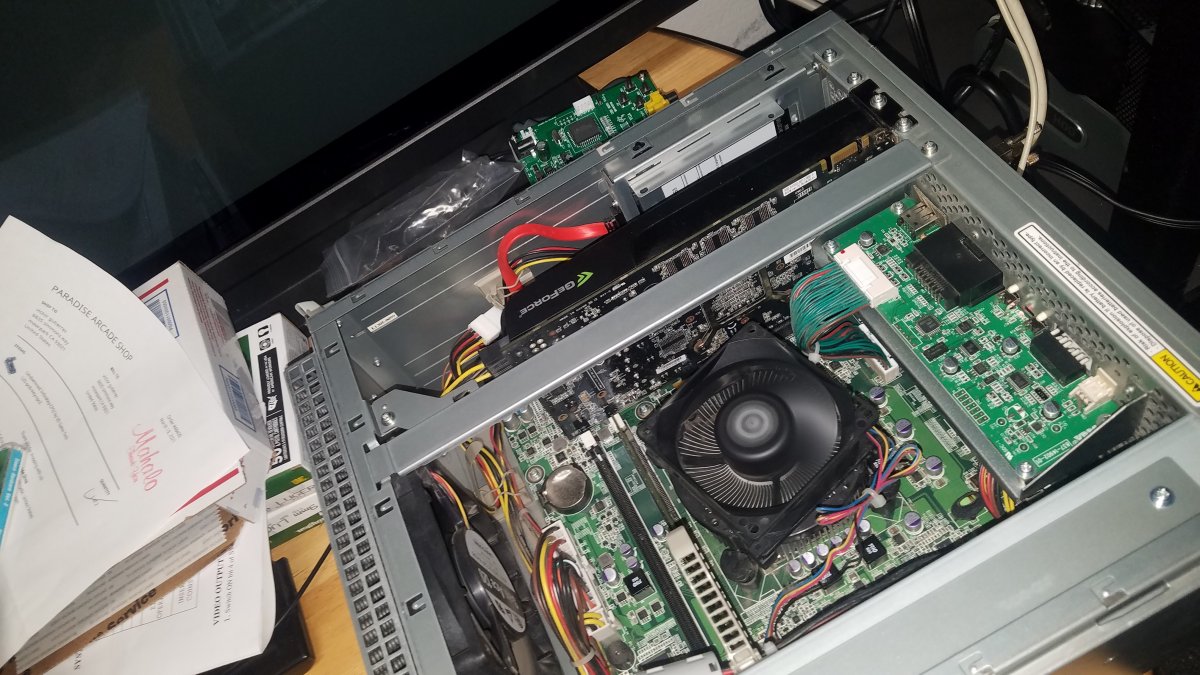

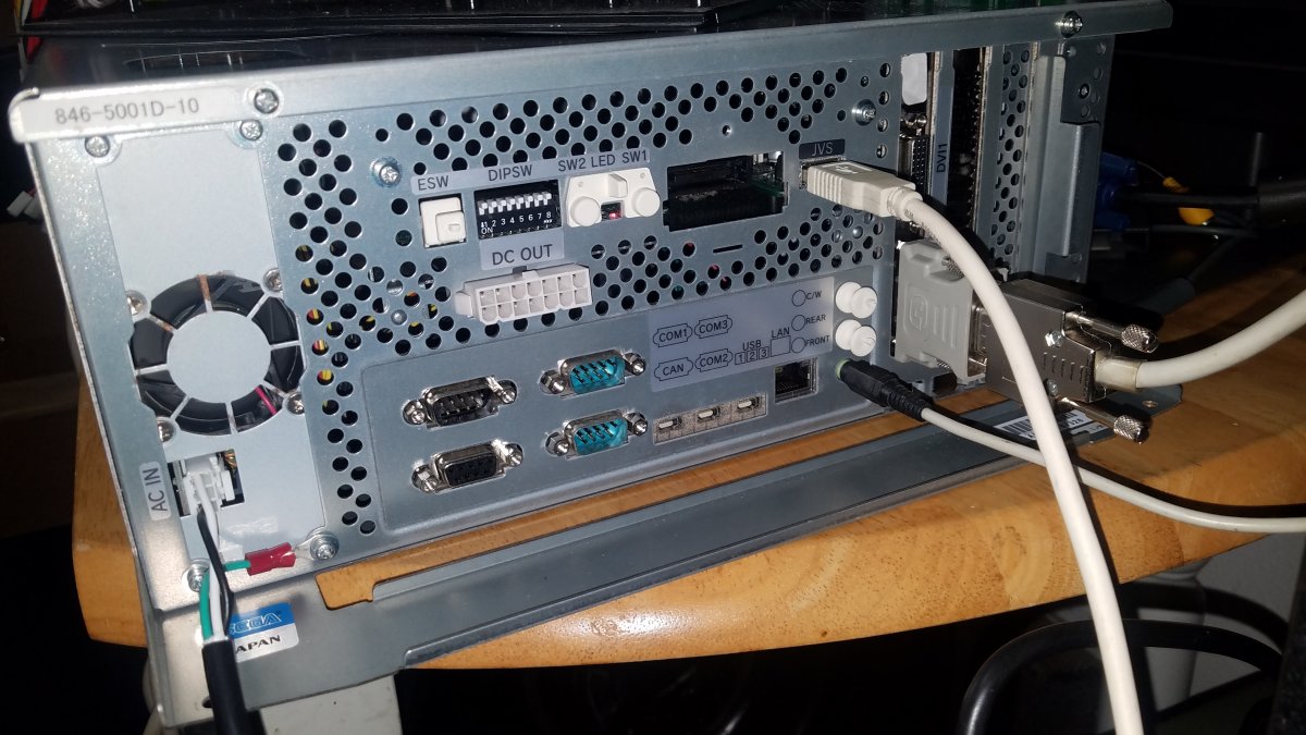

Hi yo, just got a RE2 I turned it on but I cant get any sound or video image out of it. I'm not familiar with this system can someone waive me a few hits on what to do. So fat I have tried both video outputs on the video card and no luck, all the fans turn on a the led's inside. Thank you for your time. ( the case was damaged in shipping but I'm not sure that's the problem)

This is the damage on the case

Try flipping dip switch #4, that’s used for rotation, leave the rest as is.

One of mine just stopped working out of the blue. Same issue. Haven't looked into it yet.
Try reseating the GPU and RAM.

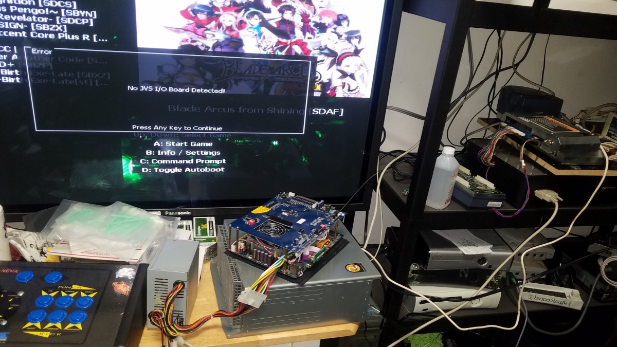

Looks like its running now, took out the ram and GPU and clean it, how ever I have no clue how to change the resolution
Again, did you make sure to flip and disable switch 4? Leaving only switch 7 active will work for all the games it’s the default 1280x720 resolution.

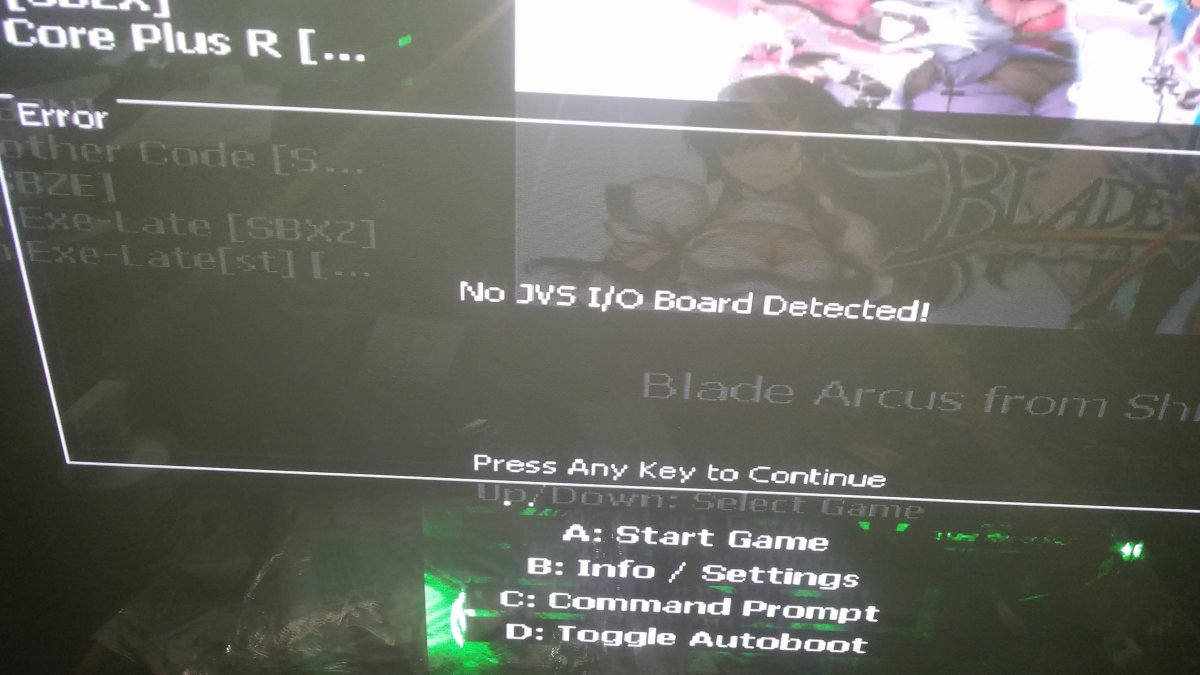

ok I'm stuck again, RE2 boots ok, but now is not recognizing the capcom i/o that's from the Naomi set up. what do I do now? some forums say the capcom i/o should work others that theirs issues.......
Thanks @muckyfingers everything works now. The capcom JVS I/O is not compatible with the sega RE2.
I use a JVS I/O Board to Jamma Converter Board (Ver. B) and that works :D
