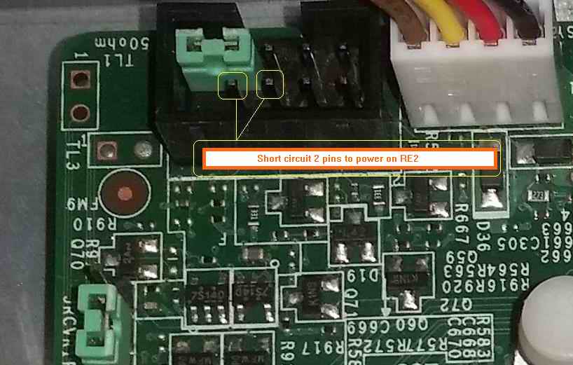

dionysus
May 10, 2019
10
1
Canton
Try this!
doozer
Jan 12, 2018
154
60
Brisbane, Australia
Thanks, but that's what I meant by "I then followed the manual to do the battery replacement procedure."
