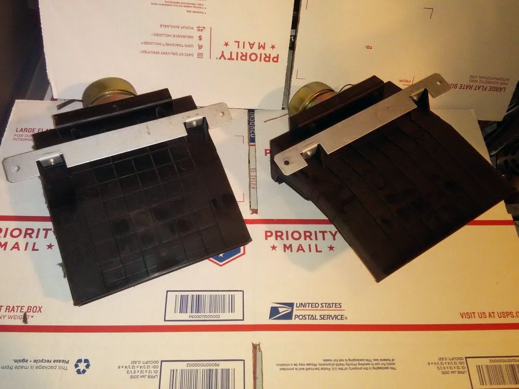

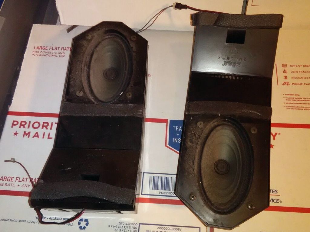

Hi all, I have a Sega Vs City cabinet that has the original speakers installed in it and after checking them recently, most of them are in dire need of replacing. I was hoping that I could find drop in replacements for the original speakers, but haven't had much success with this.
Does anyone know if there are any modern equivalents/replacements or have any recommendations for suitable replacement speakers?
TIA!

Misco used to sell drop-in replacement VS speakers, model SDC25S. But sadly, it appears they no longer produce them. Not to quote GZA, but I think they are clock radio speakers. :)
Thanks for the info about the Misco speakers - I've had a look to see if I can grab a few, to no avail :\
The search continues!
Great find!
Sega used those same speakers on a ton of cabs. Same driver in both of these enclosures, 12D140J:
We have installed these Visaton speakers in Versus City cabs, using some laser cut adapter plates. They are a bit weaker than the original ones though.
