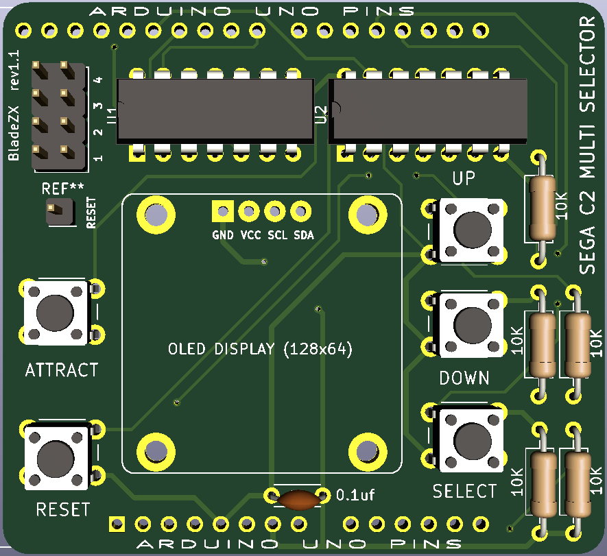

Here is a video of the Sega C2 selector in action
Here is the oshpark link for the pcb: SegaC2-Pi Multi Selector PCB
I have also attached the gerber files
Here is a list of parts needed:
DescriptionQuantityPCB LocationDigikey Part No.Comment
Conn Rcpt 2POS 2.54mm1952-2227-NDconnects to pin 8 and 10 on RPi
Conn Rcpt 3POS 2.54mm3952-2228-NDconnects to 5v, GND, Reset on mult selector - other ends solder to 5v, GND and reset on game pcb
Conn Rcpt 12POS 2.54mm1952-2034-NDconnects to multi selector (all wires from RPi connect into this)
Cap Cer 0.1uf 25V4C1,C2,C3,C6BC1154CT-ND
Res 10K OHM 1/4W 5%1R110KQBK-ND
Res 220 OHM 1/4W 5%1R4220QBK-ND
Res 1K OHM 1/4W 5%1R21.0KQBK-ND
Res 2K OHM 1/4W 5%1R32.0KQBK-ND
Crystal 16.0000MHZ 20PF1X11923-1400-ND
Cap Cer 22pf 50V2C4,C5445-175522-ND
Switch Tactile SPST-NO 0.05A3EG1829-NDblack switches for up, down and select
Switch Tactile SPST-NO 0.05A1EG1830-NDred switch for reset
CONN IC DIP SOCKET 28POS TIN1A120353-NDsocket for atmega328p
Atmega328p chip1ATMEGA328P-PU-ND
Conn Rcpt USB2.0 TypeR 4POS1UE27AC54100-NDmounts to the bottom side of the pcb
Conn Header R/A 3POS 2.54mm1952-2245-NDmounts to the bottom side of the pcb
connects to 5v, GND and reset on the game pcb - you will need to solder these - see video
Conn Header R/A 12POS 2.54mm12057-PH2RA-12-UA-NDmounts to the bottom side of the pcb
connects to Rpi GPIO pins
Conn Socket 8POS 2.54mm1SAM13072-NDmounts to the bottom side of the pcb
plugs into the 8 pin connector on multi - make sure to match pin 1
Conn Socket 22-30AWG Crimp Pin40952-2159-NDcrimp pins for all wire connectors
OLED 128x641Amazon URL:
https://www.amazon.ca/Display-Modul...0.96+inch+oled+128x64&qid=1647185028&sprefix=
0+96+inch+oled+128x64%2Caps%2C52&sr=8-5
I recommend using a Raspberry Zero W
This is the case I am using for it:
You will also need a 8GB microSD card (I recommend Sandisk)
Here is the Raspberry Pi image you will need to load to the RPi. Just unzip it and load the img file using Win32DiskImager
SegaC2-Pi Raspberry Pi Image
Note: If the link for the image does not work, copy the link and paste in a new window
The pi user is: pi
The pi password is: c2multi
Here are the RPi connections that will be used and connected to the SegaC2-Pi mult selector pcb
Pins 1,3,5 are used for the OLED display
Pins 11,13,15 are used for the UP, DOWN and SELECT buttons
Pins 8 and 10 are used to send and receive data from the Atmega328 chip
Pins 12,16,18 and 32 are used to program the Atmega from the Raspberry Pi
Connect a USB to microUSB cable from the multi selector to your RPi in order to power everything from one place
