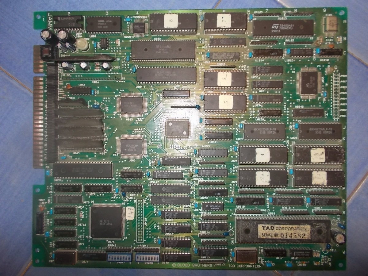

Blood Bros:

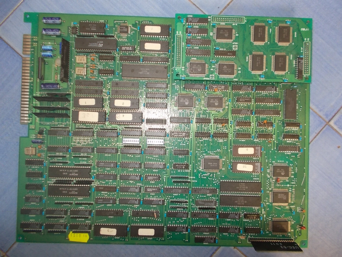

Raiden:

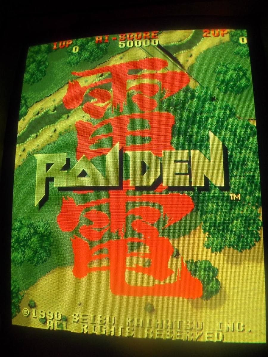

Both were faulty.Blood Bros played blind :
While Raiden lacked of the BLUE color:

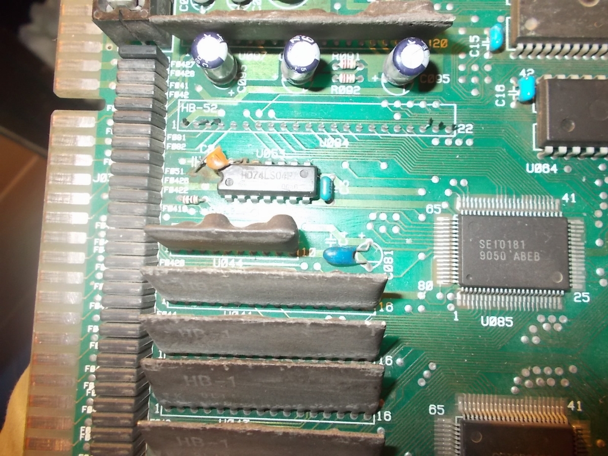

The culprit was the same in both boards, the ‘UEC-52’ (sometimes silkscreend on PCB as ‘HB-52’):
It was clearly faulty in Raiden and missing at all in Blood Bros:

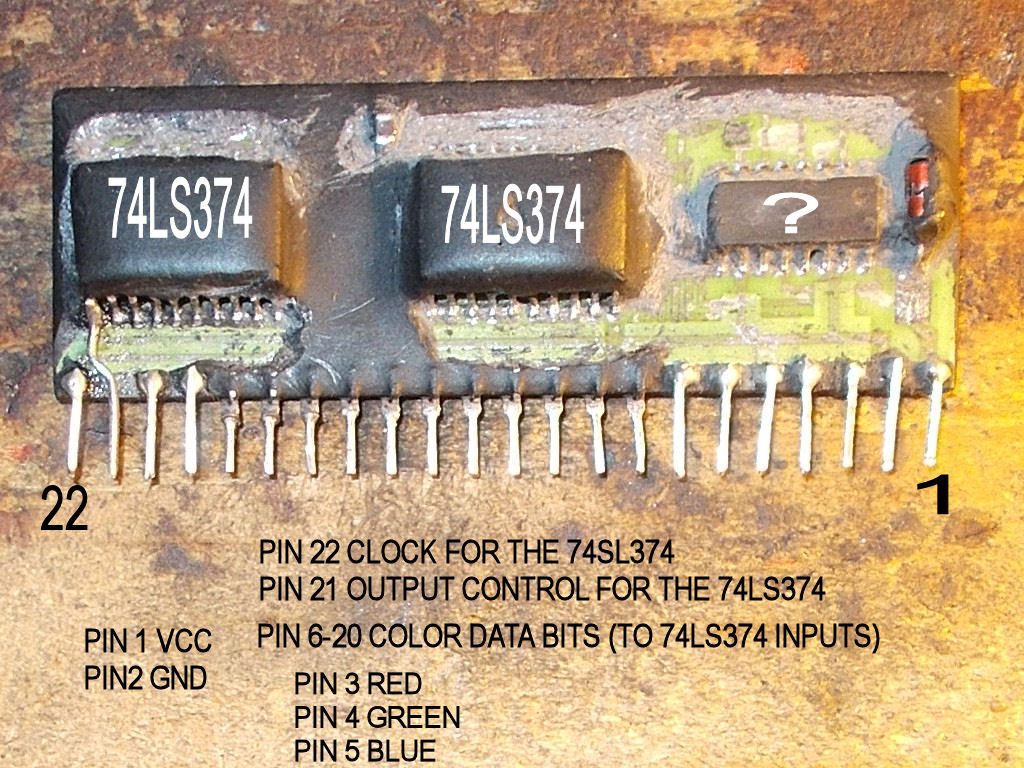

Some time ago I partially figured out the pinout and schematics/parts after removed some of the epoxy resin that encapsulate it:
As you can see it’s a 15 bit DAC whose design resembles the Taito ‘TC0070RGB’ : two octal D-type flip-flops , some printed film resistors (with typical values of 4K, 2K 1K, 470 and 220 for the 5 bits of each color) forming resistor ladders before the output to JAMMA RGB pins.But there was also a third IC that I could not identify.At first glance I thought about some kind of darlington array to amplify the signals so I made a post on EEVblog asking for some help:

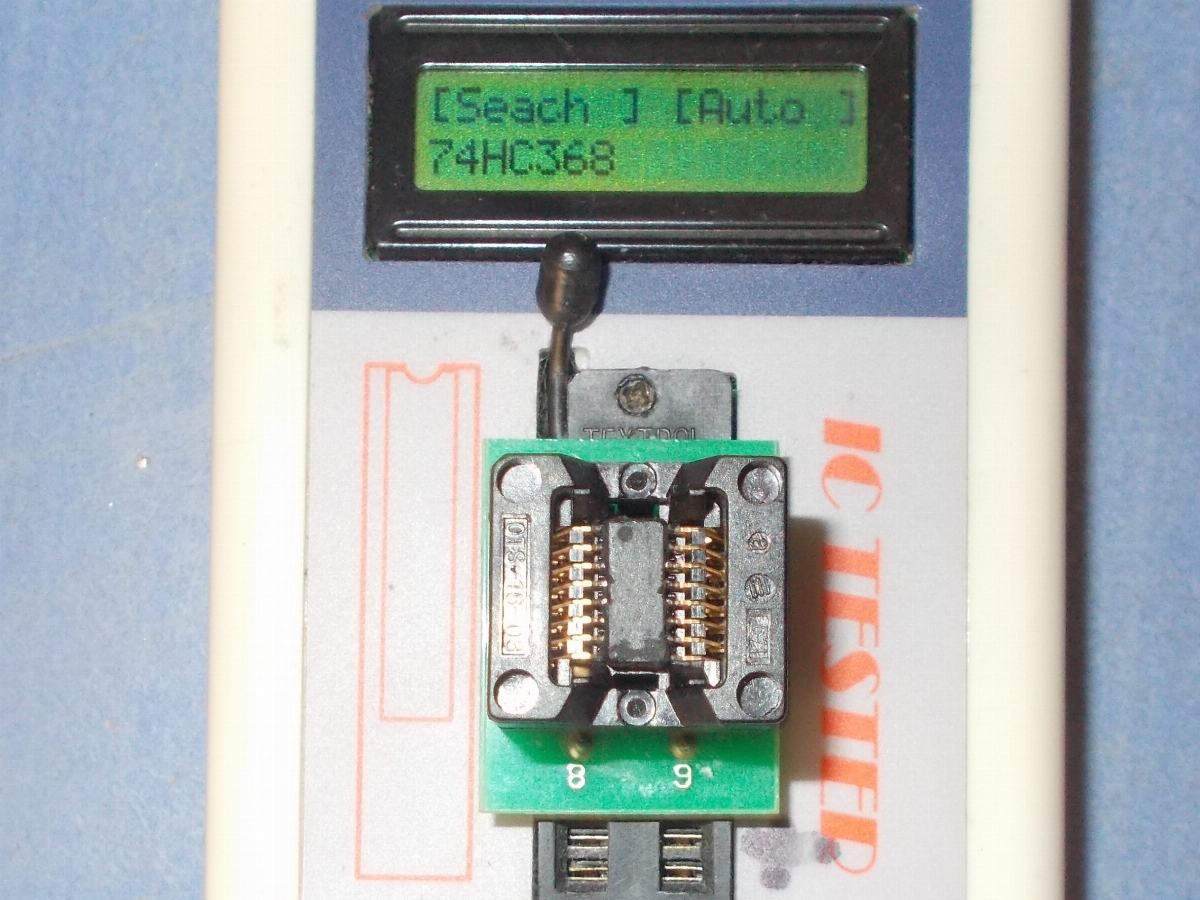

The user ‘stj’ (thanks again to him) pointed me in right direction suggesting that the unknown IC could be a 74LS367 used for video blanking.So I removed the IC from a workingcustom and was able to identify it as a 74HC368:

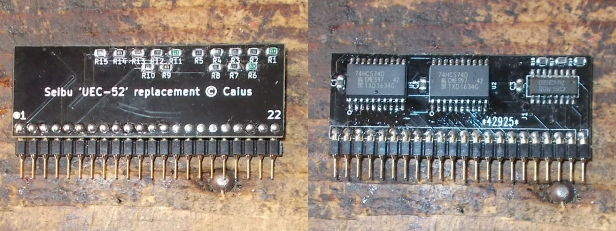

Time to populate (in my design I used 74HC574 since it has more logical pinout compared to 74HC374)
Here is a side-by-side comparison:
Testing was successful on both boards (excessive brightness of recordings is an issue of camera, video levels are exactly the same of original part)
