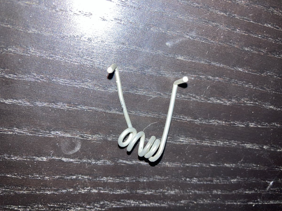

Planning to go in depth with this once I can get some decent photos from my next teardown.
First tip is if you don't have the official tool to remove the cap, or a 3D printer to print one you can just modify the spring in a clothes peg with some pliers to make one.
Please add to this thread with any information or tips you may have.
