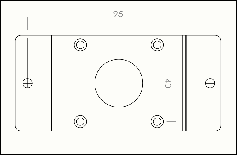

But the Astro City panels use an offset-height plate, with two screws at 95mm (47.5 from the shaft). As near as I can tell it's easy to throw a 50mm joystick in here (and I've seen some with Sanwa mounts as well) but no one's selling 40mm plates as near as I can tell.
Does anyone sell these, or do I have to drill 4 extra holes in my P=50 plate to make it work?
I've whipped up an image showing what's required. The standard Seimitsu mounting holes are 10mm farther apart.

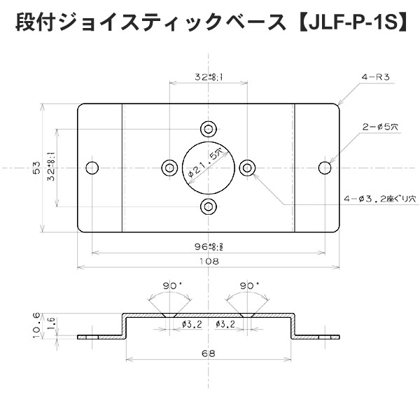

The older Sega panels use Sanwa S plates. https://focusattack.com/sanwa-jlf-p1-s-mounting-plate
I think this plate would do it but it's never in stock. https://paradisearcadeshop.com/products/universal-s-adapter-plate
There's another one on Amazon but the reviews are pretty bad but who knows. https://a.co/d/5628Et2
Ah cool, thanks for those links. That focusattack plate is exactly what I need, except the screws are in the wrong place. The Paradise one would be perfect if it was ever in stock... And yeah, that Amazon one doesn't look awesome.

Well the all-in-one plate would definitely fit the SELS-70X mech, but it won't fit the panel, being both flat and 10mm too short with the mounting holes. My brain keeps thinking it would enable the stick to mount to the existing plate, but for the life of me I can't see how.

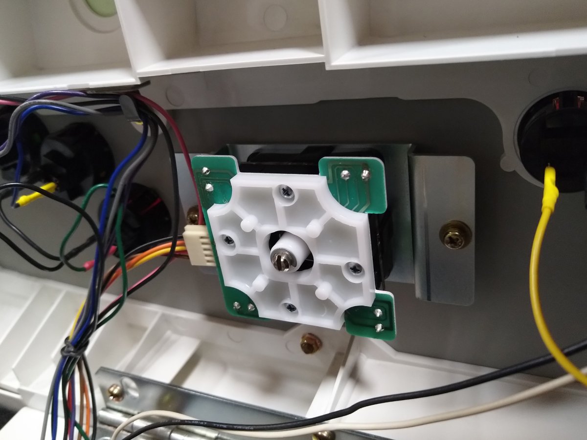

Ah, I thought AC and NAC panels used the same mount. To be precise, I am using NAC panels. One has Sanwa mounts (from a NUC) and the rest are Seimitsu mounts, but they all use the same stepped base plate.

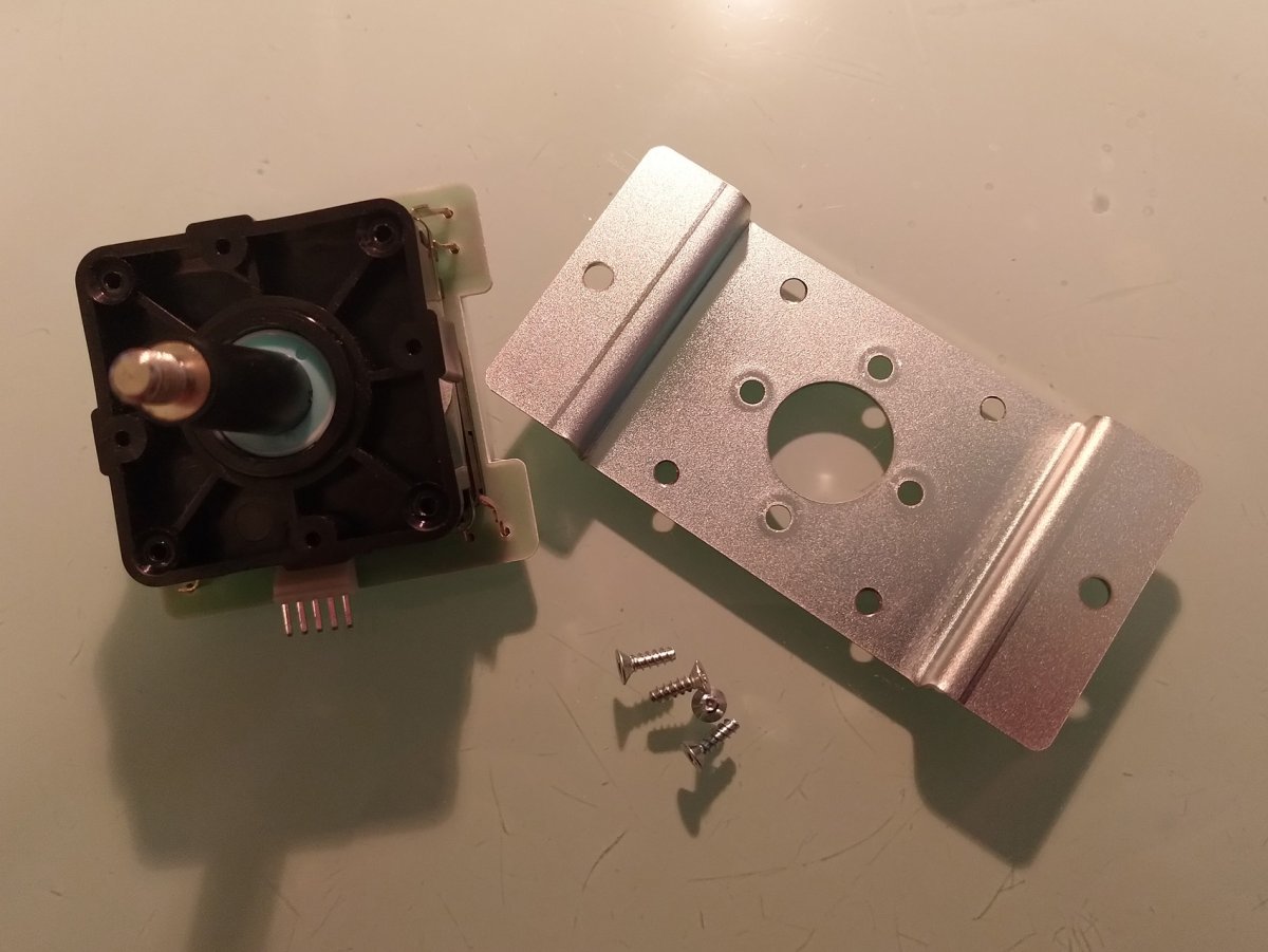

Hey mate @NFGx Possibly a Seimitsu NA plate as per this thread - https://www.arcade-projects.com/threads/help-with-identifying-this-mounting-plate.22961/#post-348665
I can have a 3D print made up of the plate for you this week (as per that linked thread), if that would assist with giving it a test fitment? Drilling holes for the LS-56 bolt pattern would be easier in this 3D PLA material.

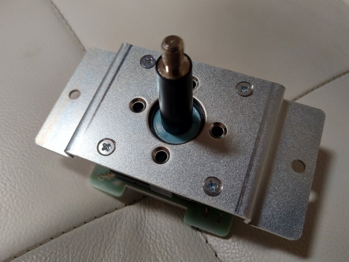

Looking through all my file photos - Another customer of mine has travelled the same road as yourself and went the drilling route with the Sanwa JLF-P-1S plate to fit a LS-56.
Hopefully this helps out?
