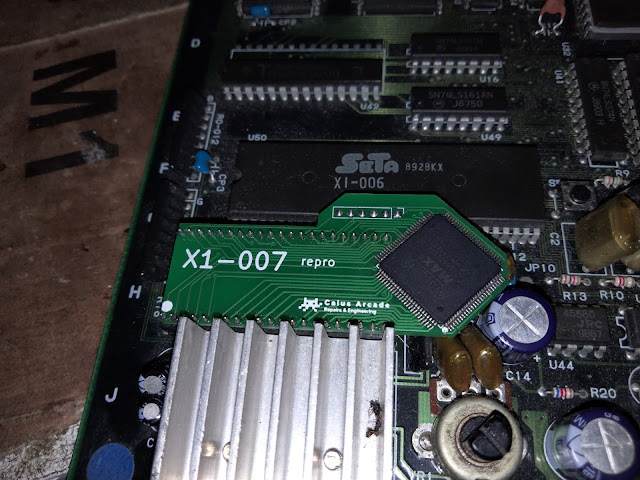

Recently 'Furrtek' decapped the Seta 'X1-007' custom chip donated by me (this part, in SDIP42 package, is used on many Taito/Seta PCBs as RGB latch and video SYNC generator)
I took the chance to put his (always) brilliant work into practice and made a replacement of this custom IC using a +5V CPLD to embed all the logics that 'furrtek' extracted from the silicon die
Testing of the reproduction on Insector X PCB was successful :
