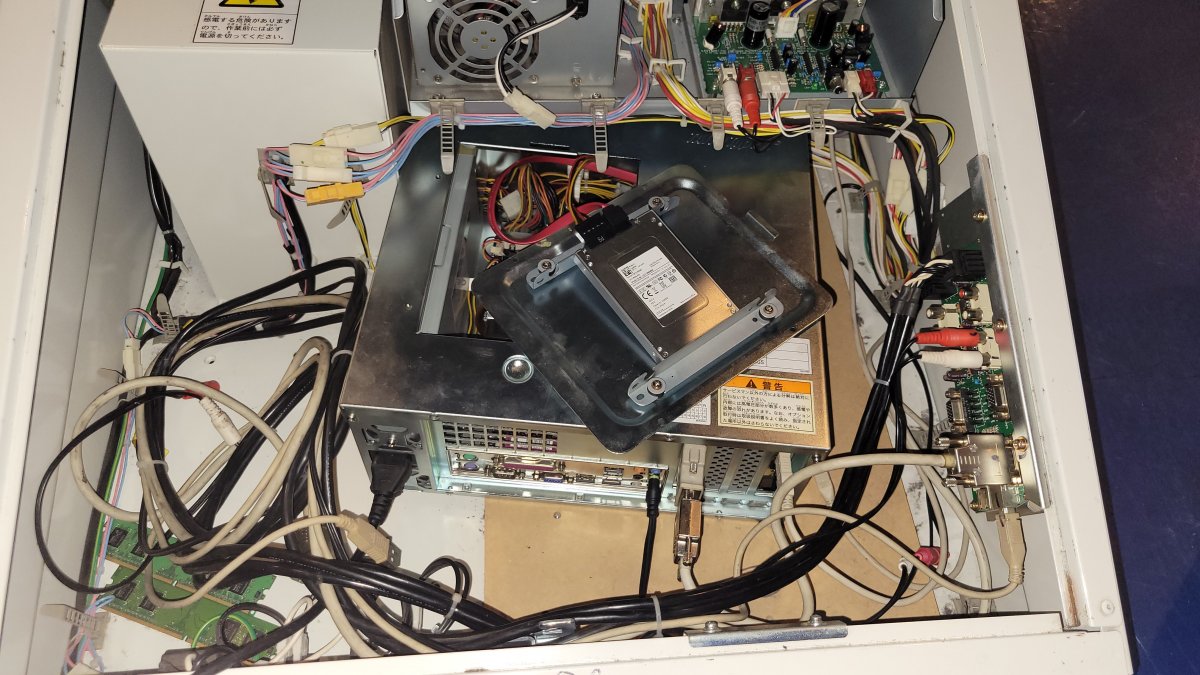

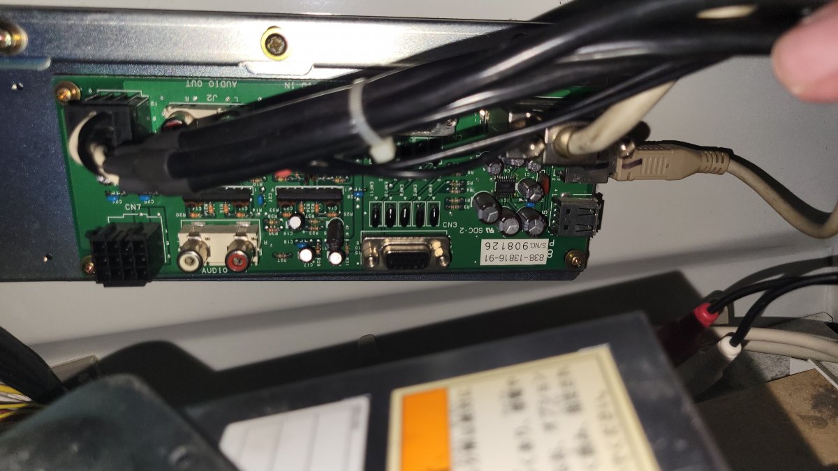

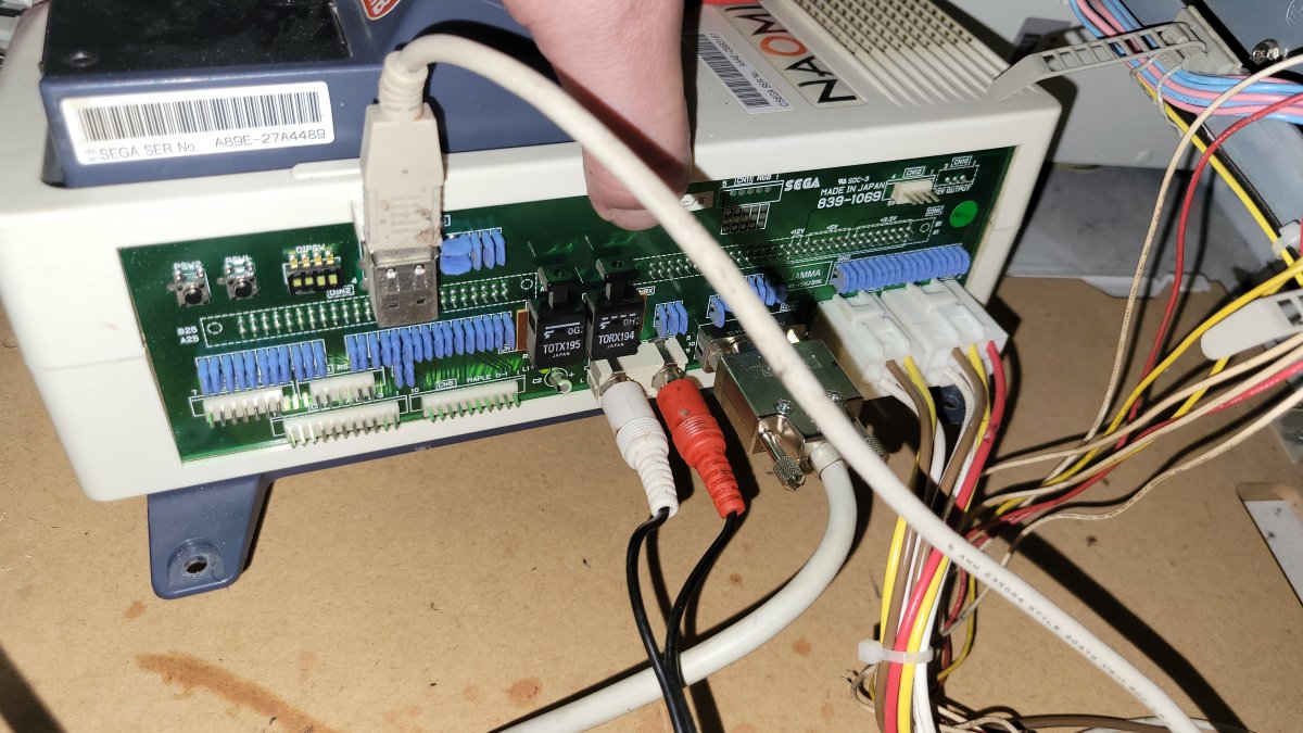

Just picked up these two cabinets and the seller told us that they had they ability to set up Head to Head though he never attempted it himself. Made an attempt ourselves but unsuccessful. Looking for any guidance over what we may have over looked. Also, the end goal is to attempt to use this head to head set up to run a signal to our capture card for streaming capabilities instead of actually running a head to head set up. Our thought process was these are equipped with signal splitters, so instead of running the video/audio to another cabinet, we'd connect it to a (VGA to HDMI converter) and then to a capture card. Is this even possible?
One cabinet is equipped with an Taito x2 and the other a Naomi/netboot. Seems all the proper cords etc are present, just need to know how to properly get them talking to each other. Photos attached are how they came delivered. (not connected to each other). Any help or advice would be appreciated. Google has not been fruitful

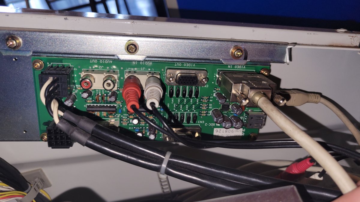

Yeah its a bit confusing as you have a TTX2 in one cab and a Naomi in another so these were operated as independent cabinets when in a reality a VS setup would have the game board in the master/primary cabinet only. Essentially one of the cabinets is the 'master' and the other is the 'slave'.
In the master cab audio/video from game board is the (Audio/video) input into the VS board. Then of the two audio/video outputs, one pair goes to the master crt/amplifier and the other pair feeds back to the slave cab.
Now taking a punt here (and someone please correct me if i'm wrong) but the audio/video going back to the slave cab then becomes the 'audio/video in' for that VS board and the output video/audio goes to that cabs CRT/amplifier.

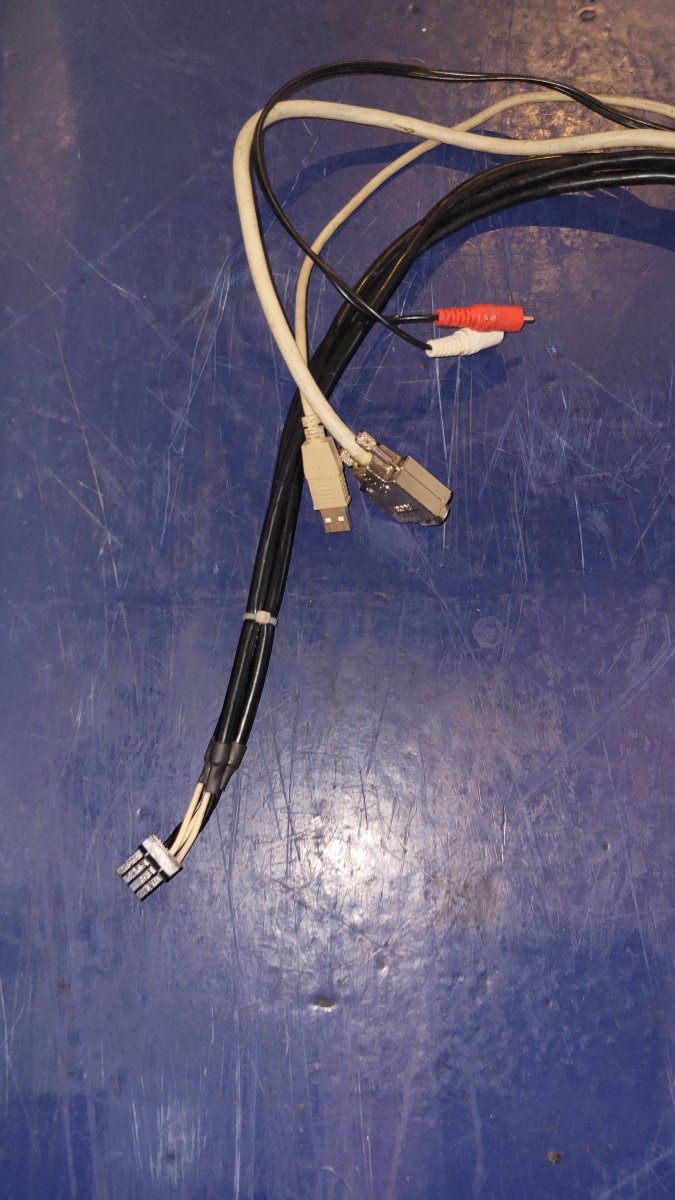

The bunch of black cables in the top left connects both VS boards looks like power possibly? and there is a USB cable between the two for JVS? yeah not sure, just trying to find documentation on that board now but someone who knows for sure will jump in no doubt.
Naomi/TTX2 >>> Video In >>> Video out to master cab CRT
______________>>> Audio In >>> Audio out to master cab amp
_____________________________>>> Video out to slave VS board (video in) >>> Video out to slave cab CRT
_____________________________>>> Audio out to slave VS board (audio in) >>> Audio out to slave cab amp
If you don't care about a VS setup then as per above rather than feed audio/video to the slave cab VS board just use that for your capture and also forget about the black cables for the controls.

Except they both involve the same hardware. You split the audio / video to the 2nd cab or you split them to a capture card. You can use the link board in the Net City for both. That's what I do.
Technically, you could even do both, link cabs and capture gameplay. Just use the 2nd outputs on the 2nd cab.
It's a nice feature in these cabs.
